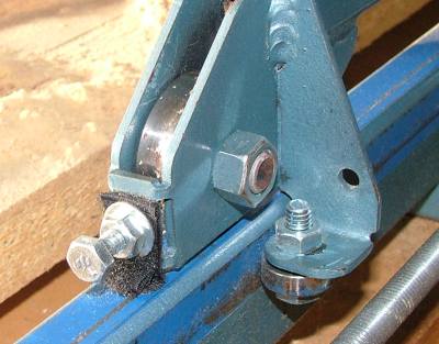

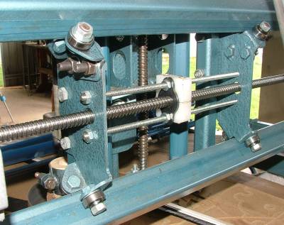

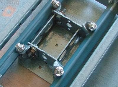

My I made most of my linear bearings from roller skate bearings
and RHS or SHS ( Box section tubing ). It works, and its cheap.
The important thing is to have some way to adjust out any slack
or play in the rails. My bearings are bolted to the axis on elongated
slots. The slots mean I can loosen off the retaining nuts and move
the bearing closer to the rail. Its a bit fiddly at first, but once
adjusted it tends to stay that way, and I ended up with a machine
with very little sideways play in each axis.
