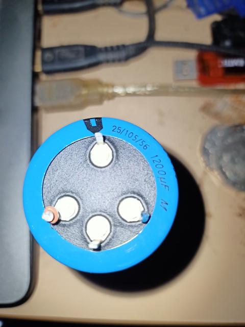

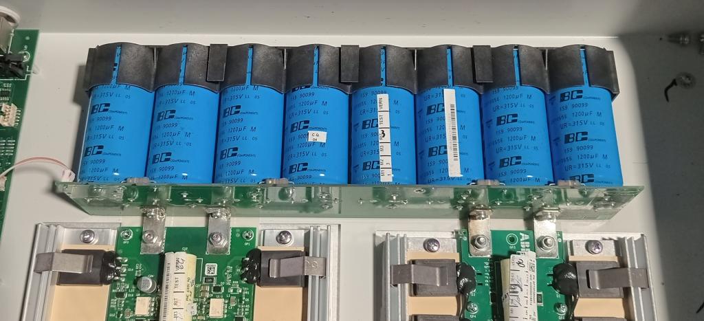

Can I confirm here that the following groups of capacitors would be usable for this build? You just install the required number to achieve or exceed the total design uF capacity - as previously indicated by Wiseguy? Or would this compromise the design?
- 8 x 315V, 1200 uF, as pictured below from a 5 kW Aurora unit
- 11 x 315V, 1000 uF, from an SMA Sunny Boy.
- 5 x 315V, 1000 uF from an Aerosharp.
all presumed to be in working condition - I have not expertise or equipment to check.
all are 35mm diameter.
Realising now that I've previously scrapped many of these types of inverters - for copper and aluminium recovery- and threw out probably hundreds of suitable capacitors and mid sized transformer cores.
Edited 2026-05-16 11:20 by GleamBright
KeepIS
Joined: 13/10/2014
Posts: 2287
Posted: 02:07am 16 May 2026
The capacitance values are not set in stone, they look good. You could test them with a current limited supply, but all the units I have removed were good quality with no faults, if there is no end cap swelling or case bulging then they are likely OK.
Revlac
Joined: 31/12/2016
Posts: 1310
Posted: 02:11am 16 May 2026
  Quote  8 x 315V, 1200 uF, as pictured below from a 5 kW Aurora unit
I have the exact same capacitors, they look good but you will need to check the data sheet as they have 4 connections at the bottom and at different diameter (hole spacing) good quality though.

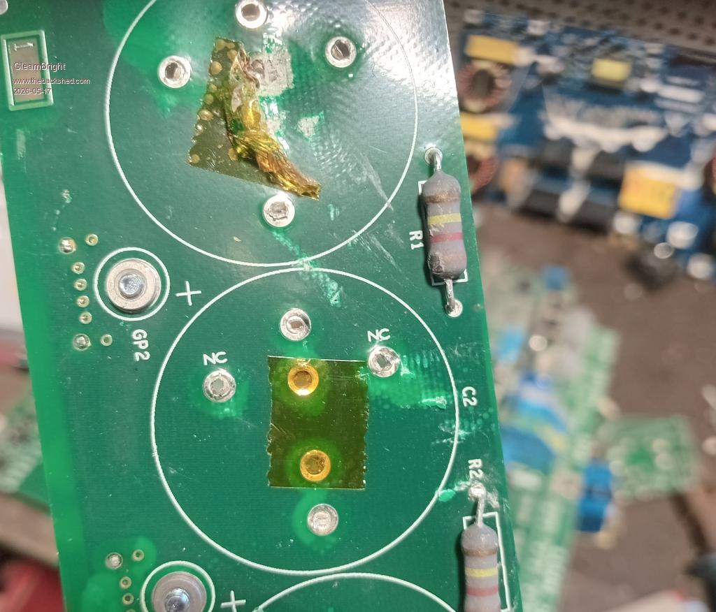

This is the PCB after cap removal & I checked online about four pin caps... the ports marked NC are 'not connected', for mechanical support only. Distance between pins is 22mm, do I just drill extra holes in the PCB for the NC pins?
Revlac
Joined: 31/12/2016
Posts: 1310
Posted: 12:14am 18 May 2026
I would probably remove the NC pins, seen as the 2 pins we want are 22mm apart there are options to find something else or deal with it, there might be some small lugs (available or make some) that can be soldered attached to those legs then through the PCB as normal, the PCB could be drilled to accommodate the cap legs as is but its a bit more work and troublesome in some positions......on the other hand we would only do this once and if done correctly would be well worth the little time spent compared to the cost and time waiting for new ones from some supplier over great distance.
There would need to be an insulating pad between the cap leads and the PCB (sil pad or something) then once installed into the PCB go around all the caps with some HY 704 silicon.
You have me interested now, I going to have ago at this when I get my other jobs done.
Posts: 3444
Posted: 12:40am 18 May 2026
  Quote  the PCB could be drilled to accommodate the cap legs as is but its a bit more work
Accurately marking the holes could be streamlined with a template.
Firmly press the cap on to a piece of cardboard to make indentations.
Punch or drill holes at those locations to make the template.
Align the + and - holes with those on the PCB using pieces of wire, then mark the PCB through the NC holes.
