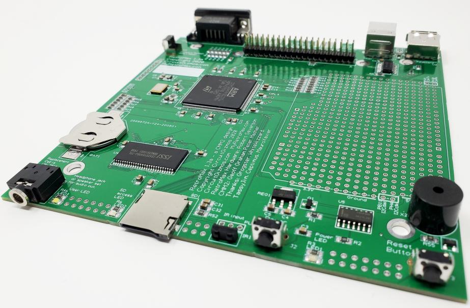

Polish perhaps?
It has a sea-of-holes like the RetroMax:

Rob
What is U5?

Part of the power-on circuitry. The power is a button. Push once for on, again for off.
The CircuitGizmos RetroMax is functionally the same as the Color Maximite 2, except there are some changes and additions:
- Different board shape/size appropriate for the optional enclosure
- Board mounting holes for VESA 100mm back-of-monitor mounting
- Power button that toggles on/off
- Reset available from front panel
- IR receiver behind translucent window (on case)
- Micro SD card holder
- Firmware reflash button available on side
- Additional "User LED" in white
- Piezo "User Buzzer"
- Two Nunchuk connections for two game players
- PCB connection for optional real-time clock
- PCB sea-of-holes for user hardware, conducive to Arduino shields
- Mounting holes and orientation for Raspberry Pi HATS
Edited 2020-10-11 04:13 by CircuitGizmos

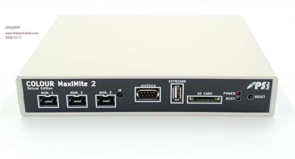

Gotta say there's some REALLY nice things in that Polish version...
Love the 3 Nunchuck ports on the front, love that the Pi header is both internal and on the back and labeled.. Love that the power switch goes in the right direction ;)  DB9 Joystick port is questionable.
Do like that the Retromax has the Arduino pinout available, and the built in piezo buzzer.
Each has their merits!

Here is pinout of the DB9 joystick port, I have used one of the forum users suggestions:
https://www.thebackshed.com/forum/ViewTopic_mobile.php?TID=12282&P=3
DB9 FUNC -> GPIO
1      UP -> 35
2      DOWN ->36
3      LEFT -> 38
4      RIGHT -> 40
5      -
6      BUT A ->32
7      +5v
8      GND
9      BUT B ->33
If You have any questions please ask, I will be very happy to answer.

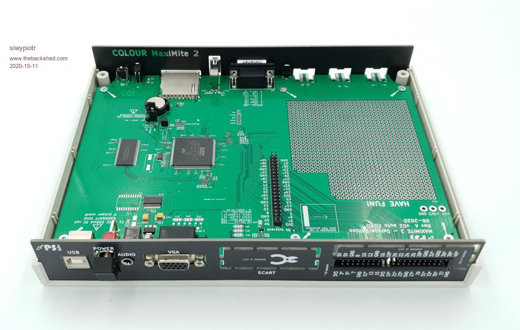

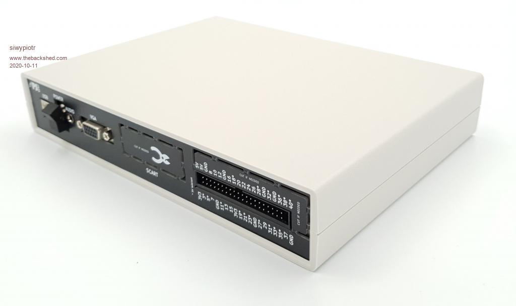

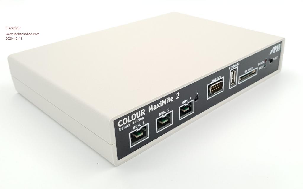

Here You can find more pictures:

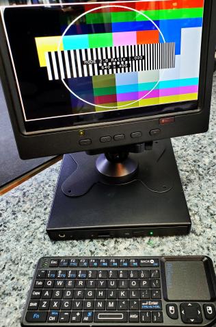

Now replace the box with...
...and keep the PCB design, and we're getting somewhere :)

I like the prototyping section on this one.  He is considering adding one of the mouse options from forums to his design but if you get one now, you or he could just add the circuitry for it on the prototype section and use the SCART cut out to add the port.     he could maybe sell a small PCB and wiring instructions. I think this is the best part of the design. The rest is very nice too.

It is not a problem to add mouse support on next version. I can do it by adding additional STM microcontroller with USB support and send data to main processor using i2c or other protocol. But I do not want to create additional standard, creators of the firmware have to agree how it should be done and I will follow their standard.
