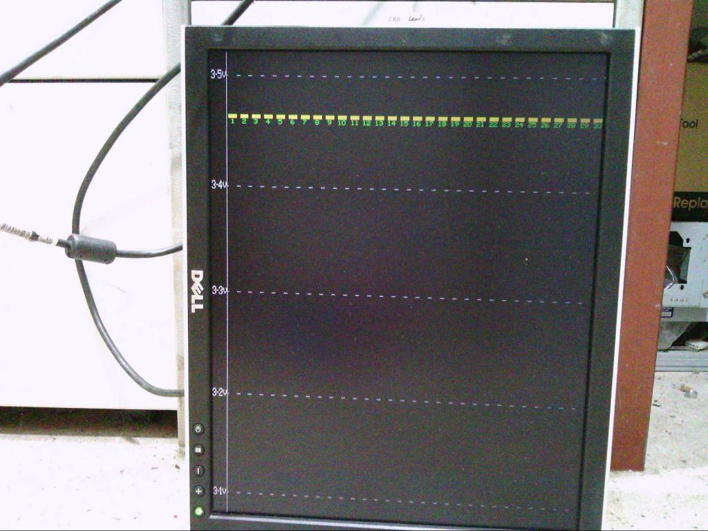

I have an excellent cell voltage monitoring system, generates a histogram display on a VGA monitor. I can see instantly what every cell is doing, one VGA display out in the shed, a second in my kitchen.
Also have a dynamic full time cell balancing system that switches loads across the higher voltage cells, which is part of the cell monitoring system.
Charging terminates as soon as any cell reaches 3.45v.
The cells have not been thrashed, never charged beyond 3.45v never discharged below 3.10 volts.  Automatic battery disconnect beyond >3.5v and <3.1v, and any individual cell will disconnect the entire battery if one goes out of limit.
I had three undervoltage disconnects, and in each case the measured cell voltage was zero.
Not one millivolt or two millivolts, but zero volts dead short. Each cell had very slight swelling even though clamped six cells deep between two 6mm steel plates.
Klaus has had at least one cell do the exact same thing.
When Klaus reordered a replacement, Trev said he had never heard of such a thing ever happening.  So I really do not know what to think.
Here is my early BMS design (2019) showing thirty cell voltages, plus the max and min peak voltages reached for each cell. The circuit breaker has a shunt trip coil to disconnect the battery if any cell goes beyond limits.You can see charging terminated when one cell hit 3.45v exactly.
It would be difficult to engineer in more monitoring or more protection, but three cells still spontaneously died in the exact same way over three years.

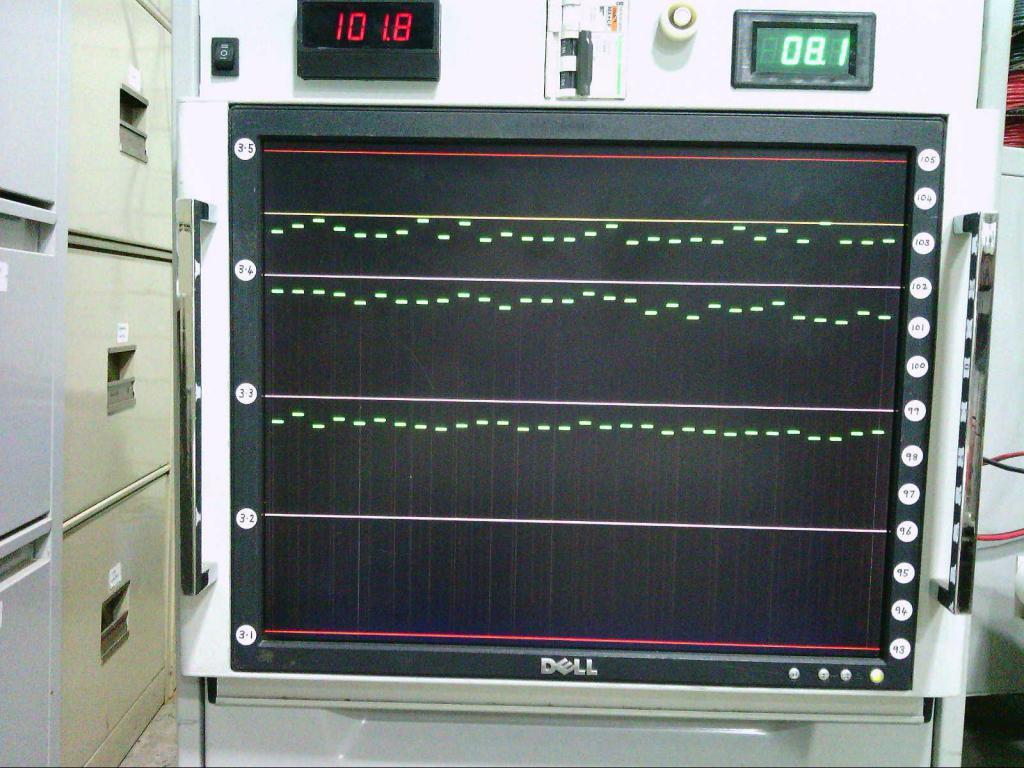

This is my latest version with a much higher resolution home brew video board, just the bare VGA board under test, not hooked up to a battery here. The voltage bars change colour when the discharge load is active on a particular cell. Pretty happy with how its turned out. The crappy photograph below looks grey and grainy, in real life its really crisp and sharp.
I am just slightly fanatical about looking after the battery as you can see, its quite an investment.
But all these cell failures are still rather worrying.
I still need to order three new cells from Trev, running without the battery right now.
