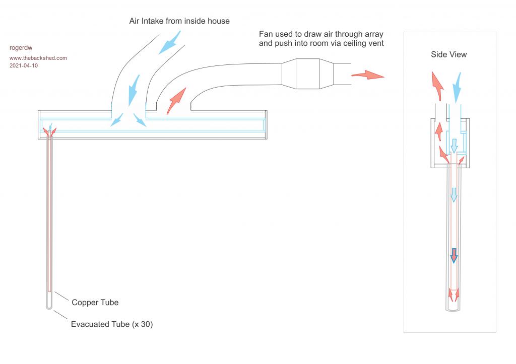

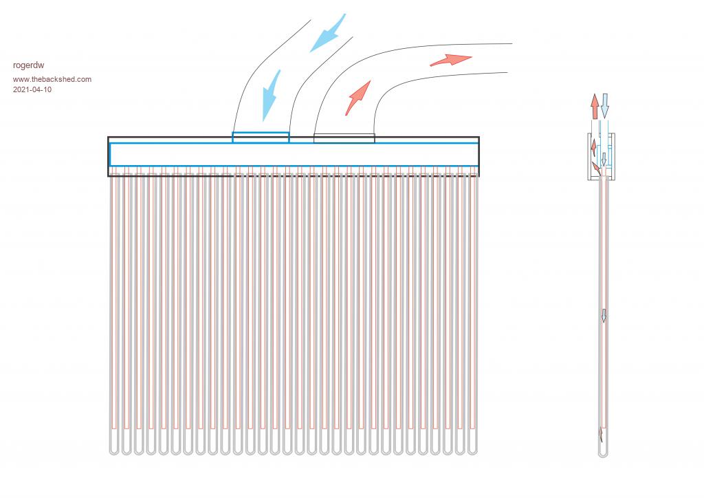

Hopefully the concept will be obvious.
The plan is to hang copper (or steel) tubes out of the bottom of a manifold  ...  into the evacuated tubes.
Then, using an inline fan in the outlet to draw air from inside the house into the heater  ...
...  where it travels down the centre of the copper tubes and flows back up between the outside of the copper and the inner glass tube  ...  gaining heat all the way through  ...
...  and expel it back into the home via a ceiling vent.
Edit: I forgot to mention that in this design I would hang them on a north facing wall and have the inlet and outlet open into the area above the eave.
Could also create a version to lay on the roof, though fitting ducting through the tiles becomes a bit problematic.
My first design was also to mount on the wall, but with horizontal tubes  ...  with the outlets designed to go through a partially open sliding window.
Edited 2021-04-11 00:06 by rogerdw
Cheers,  Roger

Fascinating Roger.
My first thought is that vertical and north facing will produce little heat in the early morning when its most valuable.

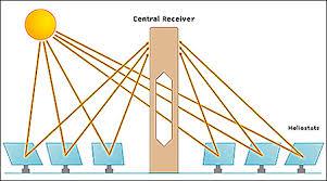

But you could probably overcome that with one or more fixed mirrored reflectors suitably aimed to catch the early morning sun, without losing anything during the rest of the day.
These commercial "power towers" usually actively track the sun throughout the entire day, but I see no reason why one or more fixed reflectors could not be arranged to boost output at a particular time of day.
A few mirrored tiles could easily double the heat output.
A large number of tiles, the heat increase could be quite dramatic.

I had a different Idea of how these worked from the last Discussion. I thought the end of the things got hot at a point and the heat was removed ( generally with water) from there. Didn't realise they were hollow.
In my head it looks a bit tricky to get the air in and out of what I imagine is a fairly small area but if you have it figured out, that's no longer a problem.

As to the setup, would seem to me as these tubes are round, with the correct spacing you should be able to get near 180o  sun coverage as it moves in its arc if the array is properly aligned.  Wouldn't matter too much if the sun hit them side or straight on unlike a panel as long as they were spaced so one didn't shadow the other too much.

  Warpspeed said  Fascinating Roger.
I think that with my observations I wasn't really expecting anything useful in the mornings, as much as it would be nice  ...  really only expecting heat once there's some warmth from the sun  ...  maybe only mid morning onwards.
Dave touched on it in the other thread when he mentioned about "heat soaking" the house during the day. There's no question that our wood heater heat soaks our house because even if we do let it go out for a day or two  ...  it stays warm for days.
If I can pipe in warm air whenever it's available, that must still help the overall temperature in the house. Would be better overnight or early morning  ...  but there's no sun then  ...  I gotta take it when I can get it.
Again I'm trying to use the thermal mass of the house to my advantage, though appreciate you work on the minimal thermal mass principle.
I do agree that being vertical is not in the best interest of maximum output, but in my case where I'm trying to avoid fitting this on the roof and dealing with plumbing through tiles, it's probably my only other option.
As Dave mentions, the beauty of round tubes is that (as long as they are spaced apart and not shading their partner) the sun can move up and over them and they still get the same amount of sun energy transfered.
  Quote  But you could probably overcome that with one or more fixed mirrored reflectors suitably aimed to catch the early morning sun, without losing anything during the rest of the day.
We do have a spot on the wall on the side of the house that would suit, but unfortunately it is recessed about 50cm  ...  which brings in some shading at top and one side.
To solve that I'd like to move them right to the outer edge of the eave  ...  but after discussions with my wife I'm not sure she'll be happy with that  ...  she wants it up against the wall. Of course there's some plumbing in the way there!!!
I like your idea of mirrors to increase the output, that could perhaps more than make up for the loss caused by shade. They could even be active if there is room for it without it being cleaned up by a 7 year old on his scooter!

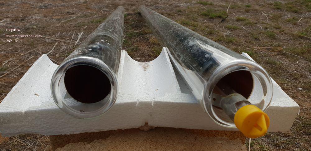

That's a good description, they do look like giant long skinny test tubes  ...  though they have a second tube inside the outer one  ...  with a vacuum inbetween  ...  like a good old thermos flask. The inner one has a black coating that absorbs the suns energy  ...  which cannot escape due to the vacuum between the tubes.
The overall OD is ~60mm and ID is 44mm.

  Warpspeed said
  Quote  In my head it looks a bit tricky to get the air in and out of what I imagine is a fairly small area but if you have it figured out, that's no longer a problem.
The solution to that might be a "heat pipe" which is how I always understood these tube collectors were used.
These heat pipes are amazing things for transferring heat from one place to another, fairly easy to home brew as well.
All you need is a copper pipe closed at both ends, with a working fluid, and all the air expelled. Water works quite well, although freezing might be a problem.
Liquid propane works well too for this, and would be my choice, as its very cheap, readily available, and pretty easy to work with.
Basically, you flush the copper tube out with liquid propane to displace all the air (and humidity) and allow the pipe to about half fill with liquid propane and half with gaseous propane, then quickly seal off the end by crimping.
Once its firmly crimped, make the sealing a bit more permanent by silver soldering.
Any heat added at the (lower) liquid end is very rapidly transferred to the (higher) vapor end with a speed and efficiency that is quite remarkable.
The high end could be finned, or bolted onto a heatsink, in such a way as to transfer the heat to circulated air with a very low air pressure drop.
I have never built a heat pipe myself, but a mate of mine is the Professor of a university engineering department, and he is really into this kind of thing, and he has shown me some of his experimental heat pipes.
Well worth a bit of internet research.
Yes, I have watched quite a few youtube videos on making your own heat tubes. I've seen them use all sorts of liquids from water to acetone etc.
If it was just one or two I'd probably have a go  ...  but for my 30 tube array that's going to take a while. And I'd want to hope I chose the right procedure to follow.
I think the heat tube is to extract the energy and be able to concentrate it into a manifold to heat water particularly. Obviously if they try and pipe water through the heated tubes and any leaks  ...  well goodbye tubes.
Seeing I'm only dealing with air, heat tubes and a manifold are hopefully not as necessary  ...  maybe??
If my tubes had come with heat pipes, I'd at least be trying connecting them to large heatsinks with lots of heatsink compound and blowing air over then to extract the heat.
Cheers,  Roger

  Quote  You are quite right in that they do normally harvest the heat from the tube with a "heat pipe"  ...  but my 'cheap' pipes don't have them fitted so my experiments revolved around just the bare tubes.
OK, I wasn't sure and obviously don't know much about these things so at least my impressions weren't totally incorrect.   :0) I didn't realise that they were 2 part as it were.
Yeah, and there's actually a third part as well that's needed.
If you look at some of the images of evac tubes  ...  they also have a piece or two of folded or shaped copper sheet the full length of the tube  ...  shaped in such a way that it contacts the inner surface of the tube and transfers the heat to the heat tube. It also needs to locate the heat tube centrally or against the glass depending on which design it is.
I think this part was more a stumbling block for me than the heat tubes themselves.
  Quote  That seems much more workable than what I had in mind. Thinking the manifolding in and out does seem a bit complex though.  I Imagine one would want a air feet tube going near the bottom of the pipe and exhausting back up.  I'm thinking a large, 150mm pipe for the exhaust with the air feed running right though the center of that.
Bit like Tube in tube HE's I used to Build for Veg oil cars.
That's pretty much what my design shows  ...  a 25-30mm tube right down to the bottom of the evac tube.
Air is either blown in the cold air manifold and pushes to the bottom of the tube and can only escape by travelling up between the outside of said pipe and the hot centre glass tube  ...  taking it's heat with it  ...  or be sucked through by an inline fan on the hot air outlet.
  Quote  Sealing the tube to the larger duct seems like it could be a challenge. I did notice seals for these things advertised on Fleabay.
Nah, I'm a cheapskate  ...  I saw my answer on a youtube video where they were making tanks for the conventional evac tube heaters.
They fitted slightly smaller temporary tube stubs into the side of the tank where the glass tubes were to fit  ...  then sprayed expanding foam around them. Once set, removed the stubs and a perfect seal for the evac tubes to slide into.
Certainly good enough for air, maybe not water of course.
  Quote  Have you any ideas on the manifolding? It seems the trick of the exercise.
Pretty much what my diagram shows  ...  just a wooden box inside another wooden box.
Maybe I need to create a larger graphic with a bit more detail.
  Quote  Yep, they will move air providing they don't have to work very hard to do it.
With this and the manifolding and pushing air down say 20MM Pipes, you are definately going to need something that generates some air pressure as well as  Volume.
I'm wondering it instead of pushing air down the tubes, you wouldn't be better trying to suck the hot air out?  That's usually how cooling fans work, Draw though but it would put importance on having air tight manifolding around the  tubes.
I had a feeling I'd read that somewhere, so again that's what's in the diagram  ...  a fan that 'sucks' from the hot air end.
  Quote  There are rubber Joiners/ Connectors used for joining pipes in boats etc. You might get one of appropriate size for the tubes. They are not that cheap especially in volume though.
Yeah, I've seen lots of options but like you say not necessarily cheap  ...  but I'm sure the expanded foam method could be used in a multitude of ways.
Cheers,  Roger
