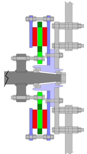

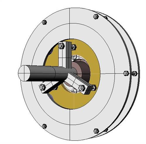

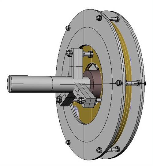

I have a couple of projects that might be of interest. Well I know one will definitely be of interest, save that till last.

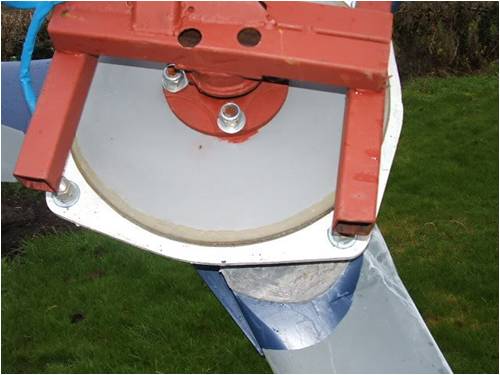

First up, I have one of Phills windmills to test out at a fiends ( Bill ) place. Its a 24v model, and we want to see how it performs. The location has never had a wind turbine or solar before, so I needed a windmill controller and some way for Bill to record the power output from time to time. I was going to use a TL084 controller and a couple of multimeter's so Bill could take some readings, but then I remembered I have the Picaxe Charge Controller. It can display volts and amps on its little screen, and work as a controller too. I'm going to rewrite its software to display current watts and watt peak. This means the software will loose the low battery alarm sub routine, and the on screen text will be abbreviated, there just isn't enough memory to keep these features and add watts displays.
The controller will display the watt peak until the controller is reset ( turned off and on ), meaning Bill can go out to the controller once a day and record the peak power from the wind turbine.

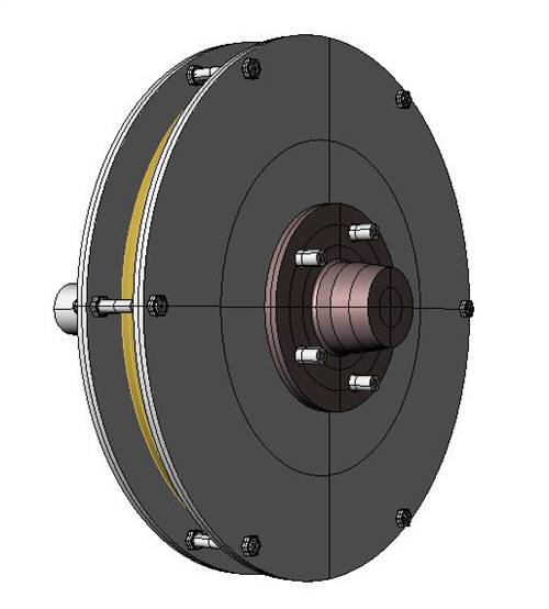

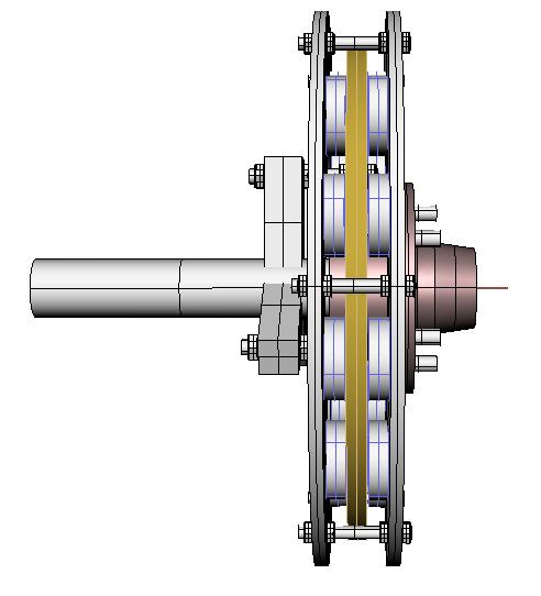

The other project on the go is something a lot of people have been asking for, I only hope I can make it happen. An axial flux project. The axial flux windmills built by Gordon and Phill are very good performers, and improve in many ways on the Other Power/ Hugh designs. But they are a very high precision device, and difficult to make without the right tools ( big lathe ). So I wanted to put together a design that can be made without a lathe.
The new design needs no special tools, just like the Other Power / Hugh design, should be easier to make, and uses less epoxy. The smaller stronger stator should also be more reliable.
Will keep you posted.

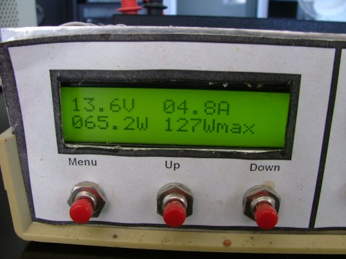

OK, this is the new code for the charge controller.
Its now a dump controller, and I've used both mosfet outputs together to drive two dumploads. The dump loads switch .5 of a second apart to smooth out the sudden drop in battery voltage a little.
The screen displays volts, amps, watts and watt peak. Most internal maths is now done using words instead of bytes. I've use the eeprom as a temporary storage of data, meaning I can reuse the word variables for calculations. Using words means I have increased the usable volts and range of the charger, at least in the software. It should now work on a 12, 24, 36 and 48 volt system, but the internal regulator would need to be changed once you go over 30v. Amps is +- 50 with a resolution of 0.1A, instead of +- 12.5 with a resolution of 0.1A.
The watts calculations were a nightmare. Sine we are stuck with integer maths, as an example 26.5v and 30.1 amps is actually 265 and 301 in the software. Watts would be 265*301=79765. That number is too big for a picaxe, its max is 65536. To solve this I divided currents over 20 by 10 and moved the decimal place, reduced resolution but better maths.
The watt peak is reset by turning the charger off and on.
I've also added a amp offset zero function to the setup menu. This will zero the amp reading.
The codes below, I'll add it to the web site once its proven itself, there may still be bugs in it.

OK Pete, couldn't help myself.
This one lets you independantly set the cut in and out voltages for the two dump loads. Also a few other fixes.
So the charger now displays volts, amps, watts and peak watts. You can set each dump load ( or whatever else you want to connect to the output, like a fan or waterpump ) to cut in and out at whatever voltage you set up in the menu. You might set a water pump to cut in once the batteries are fully charged, and a dump load to cut in if the batteries are starting to overcharge.
Not much room left in the chip, using 1662 of 2048 bytes.

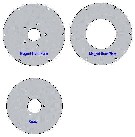

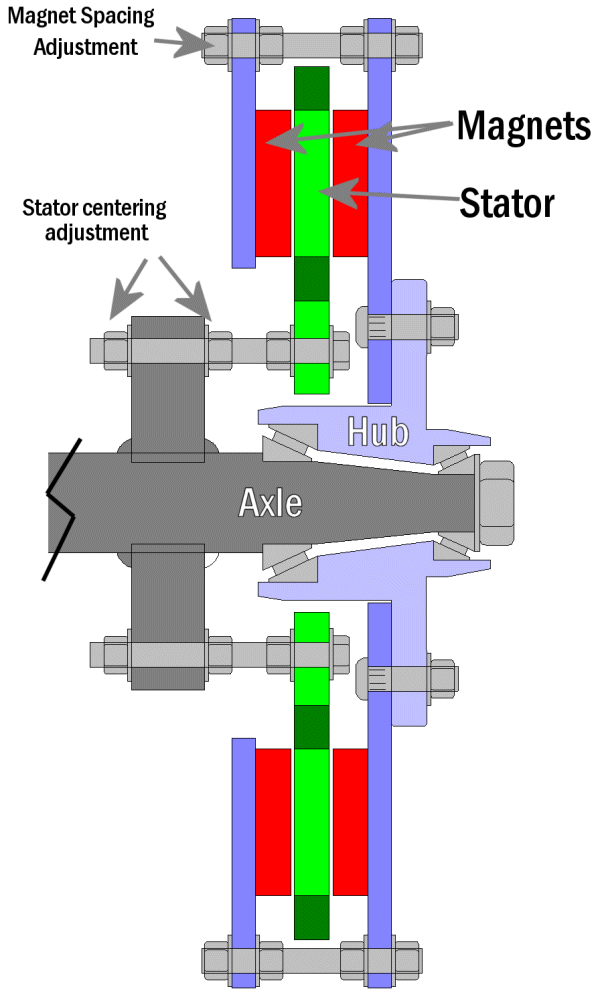

Posted: 06:34am 13 Apr 2010
This is a side on view of the axial flux design I'm working on.
I wanted a design that could be as easy to make as the Other Power/ Hugh axial flux alternator, but have a more compact and stronger stator. Gordons Axial with the stator mounted internally, instead of externally like the Other Power/Hugh design, I think is the key. And I wanted an Australian design that was unique.
I think a smaller stator, with its mounting holes on the inside, is a stronger, more rigid design. Its less likely to flex as it heats up.
Like the conventional axial flux design, you can finely adjust the position of the stator within the magnets, and adjust the magnet spacing itself.
The diagram below is based on a trailer hub. Yes, I know these have friction losses, but there is nothing wrong with you making a hub with ball bearings, I just wanted to keep it simple with no need for a lathe.
The rear magnet plate is held in place with 6 lengths of all thread. To jack off the rear plate, you would remove 3 threads and fit longer jacking threads. The stator is help in place with 3 or more threads to 1inch box sections welded to the axle.
I hope tis makes sense. Its just ideas at this stage.
This one shows a plate attached to the front of the hub to attach the blades.
I'm hoping to start on this in the next couple of weeks.
Bryan1
Joined: 22/02/2006
Posts: 2301
Posted: 08:01am 13 Apr 2010
Hi Glenn,
One thing I noticed when I had a good look at your concept is as soon as you release the outer nuts on the inner magnet plate the magnets will on it will plow straight into the stator on an angle. Try holding 2 off 50mm round magnets less than an inch apart and see if you can stop them jumping together.
A suggestion on preventing that would be to weld some boss's and use some round bar in a reamed hole to guide the rear magnet plate in to prevent it trying to skew into the stator.
Cheers Bryan
Posted: 09:03am 13 Apr 2010
Took me a minute to work out what you meant.
Nah, the rear plate is one big donut, not individual plates for each magnet. It wont bend in. See below.
Posted: 01:28pm 15 Apr 2010
OK here are some 3d drawings of the alternator. The trailer hub is a dark bronze colour, the stator a light brown, magnets a light blue. Images are from back where the axle attaches to the rest of the windmill, to the front, where the blades will attach to the front of the traler hub with a plate ( not shown ). Not included is the stator support plates, I'll show those in the exploded view, this weekend. There would also be some ventilation/weight saving holes in the front plate.
The alternator is removed by taking off the trailer hub nut ( not shown ) and the 3 read stator support nuts. One removed, the stator will be loose inside the magnet cage. To separate the rear magnet plate, remove 3 ( every 2nd one ) of the 6 outside bolts. Fit 3 long jacking threads, remove the back nuts from the 3 remaining bolts, and jack the rear plate off.
As the magnet plate spacer bolts are on the outside, adjusting the magnet spacing is easily done, you dont need to remove one magnet plate as you would need to in the conventional design. Adjusting the stator to center it between the magnets is done at the 3 mounts at the rear of the alternator.
When I finish the rest of the 3d drawings I'll start a new post.
