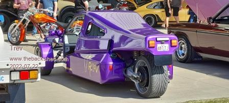

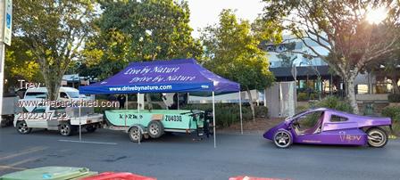

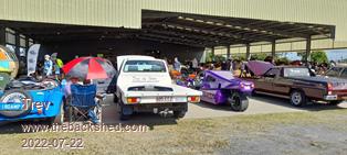

Not that our other other trips are exactly short by any means. Yeh, sure, some are local, here is 'Cars 4 Kids', Mackay, 2022. T-Rev voted 'Best Alternative'.
But many trips are long distances. Here is Noosa EV Expo, near 900km away. Here showcasing not only EV Hilux and T-Rev, but also Electric outboard motors for boats.

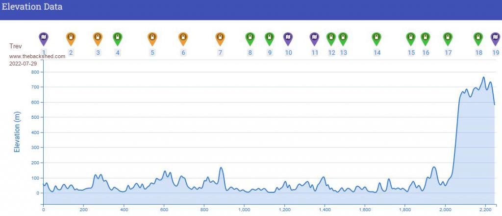

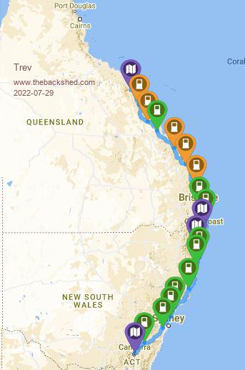

The trip plan. But plans do change.
And the elevation chart. On the Sydney trip, between Gosford and Sydney, https://www.thebackshed.com/forum/ViewTopic.php?FID=15&TID=11773
there is a lot of high steep hills. Check out the end of this elevation chart. No wonder why Canberra is cold! High in the mountains.

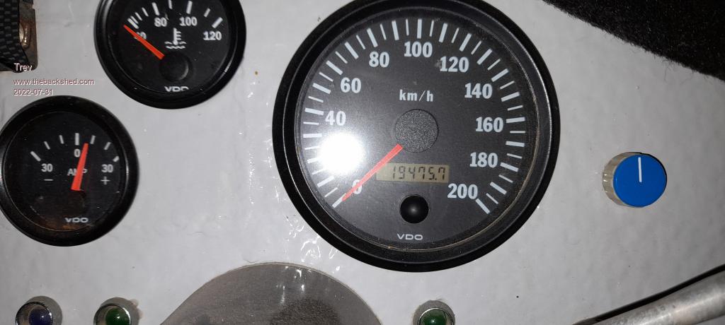

The drive has started. Left home, Kuttabul at 5 minutes to 5am.
Speedo reading 19475.7km

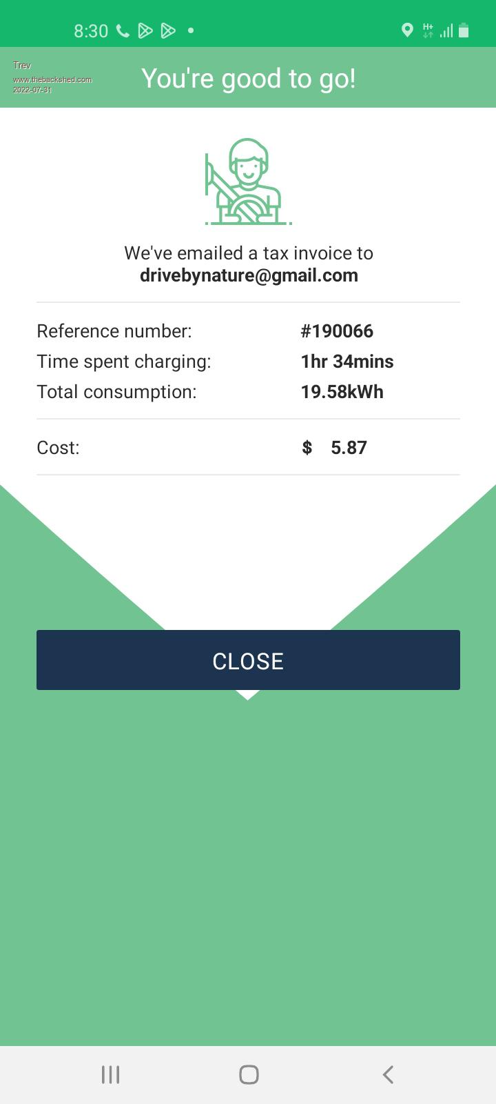

First charge is Carmila.
Drove 139km.
Arrived 6.57am
Used close on 117Ah or 58%
Drove at 80km/hr to show total time including charge. Battery full at 8.33. Total time for 139km, 3hrs 38min.
And the chargefox screen shot.

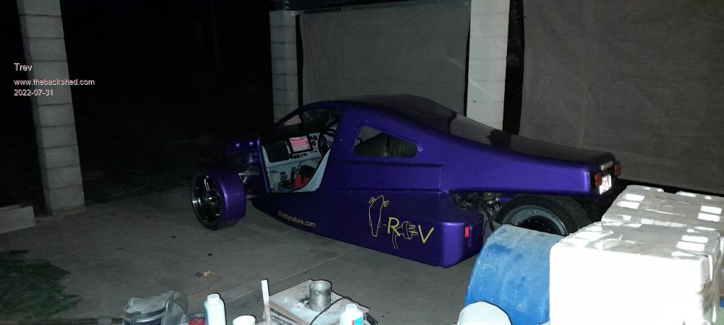

Arrived at Miriam Vale at 6.07pm. Last part of this drive was wet, light rain, a bit foggy, and dark (the sun had set), but dry when I arrived, thankfully.
Drove 173km
Used 147Ah, or 74%
Thousands of flying foxes in the air overhead of the charge station. Plugged in quickly and sheltered in T-Rev until they all left.
Then stripped T-Rev. The CAN control charger was not working. It worked back at Rocky, the last charge station. I can't see why. I reset the BMS several times. The LED indicates in 'stand by'. Don't know what that means, but no good  when it should be charging.
Anyhow, it just means a longer stay at the charge station with 20A charge rate down.
Pictures taken with flash. There is very little street light here.
Here is what it looks like without the flash.

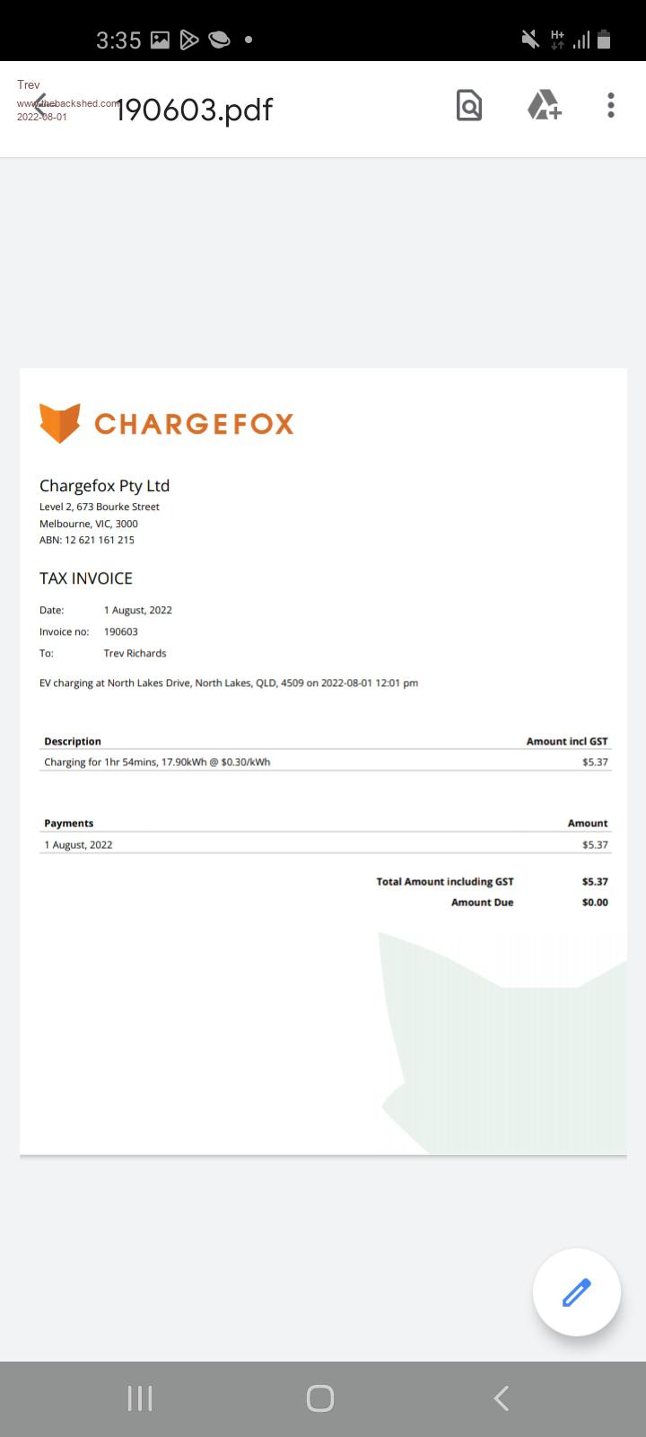

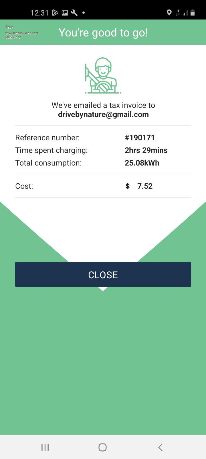

I lost the chargefox page for the IKEA charge station, so here is a copy of the emailed invoice.

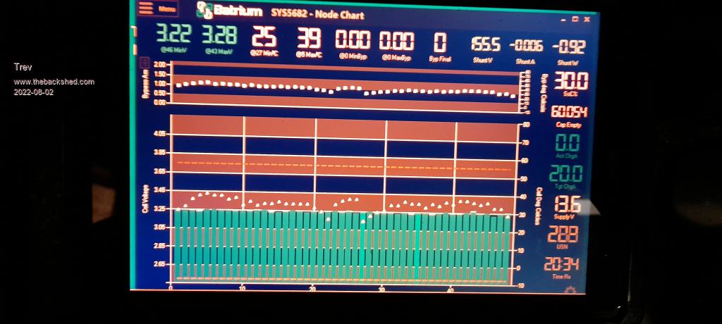

Very hard to get pictures with this beautiful sunshine.  It is so nice soaking up the sun. Dont know temperature, but was quite low this morning.
Drove mostly at 80km/hr to make the distance. I think I should be able to do 200km at 100km/hr with 100% battery capacity, but rather not deplete the entire battery. Better for battery cycle life.
Used 70% or 140Ah. 30% or 60Ah spare

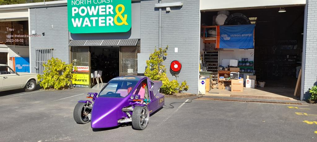

Charging at North Coast Power & Water
Thanks heaps for the free charge.

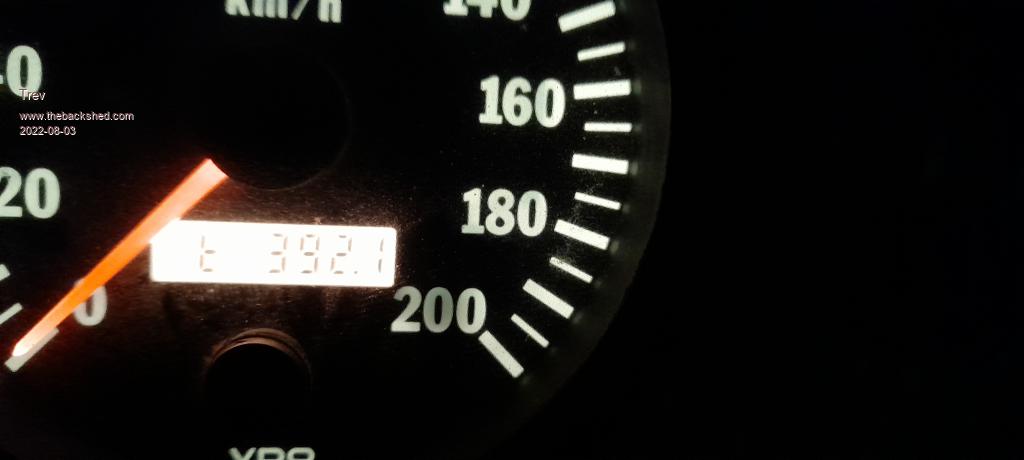

Distance on the speedo 392km. I forgot to reset it. So 392 - 230 =  162km

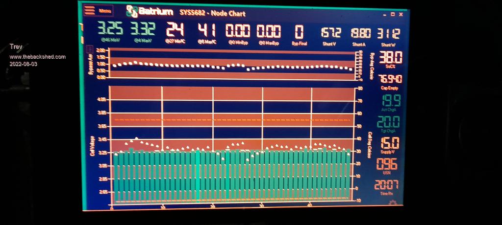

Found this place, Macarthur centre for Sustainable Living. The charge is also slow (along with the internet) photo taken when I got here. Dont remember when. I have had to set the charge 3 times.
So far have done 190km.
I am up to 75% battery capacity. I think I can make it to Goulburn. There are a few Tesla outlets down the road.  I might try themselves
