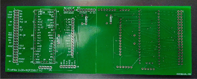

An update on Picromite PCBs
I got the PCBs that I posted gerbers for here

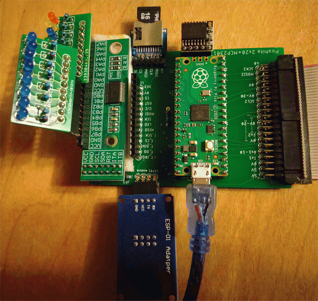

Because the PCB without the MCP23017 is identical except for that module, I started with the one which has the module.
I first soldered on the SD module and it tested OK. I soldered in male headers for the RTC module, and it wasn't recognized. I traced it to no ground on the RCT pins. I had run a trace from the middle point on the 3 pads at the bottom of the Pico, which I had somewhere seen was 0V--but I had no pin connecting it to the pad. I soldered a wire to 0V on the SD pins, and the RTC worked.

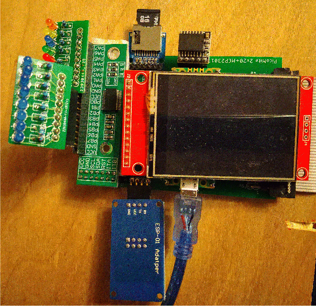

The other 5 modules all worked--ILI9488 (with MISO snipped off), ESP-01 module, and MCP23017 module. The ESP-01 is upside down, but it doesn't care, even if I do.
And with ILI9341:
These are the modules:
SD
RTC
LCD
ESP-01 module
MCP23017 module
Next will be testing the 2x20 expansion port.

I am glad to hear there was only 1 missing ground wire.
