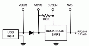

Hi,
This is regarding the block diagram of the Pico's power supply on page 11 of the Picomite manual.
The diagram shows the USB DC input and the four terminals for connections by the user but it doesn't explicitly show an output to power the Pico itself. Why not show it? One could assume a couple of ways it connects. But why assume (as the saying goes)? Show it! Could be an arrow labelled TO PICO +3.3V INTERNAL BUS, or similar.
  Louis
Posts: 3368
Posted: 01:11pm 26 Mar 2022
I'm not sure that it is that important but OK, I will add an arrow for the next release.
