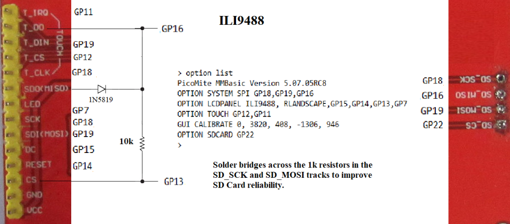

will soldering resistors fix blit read not working?

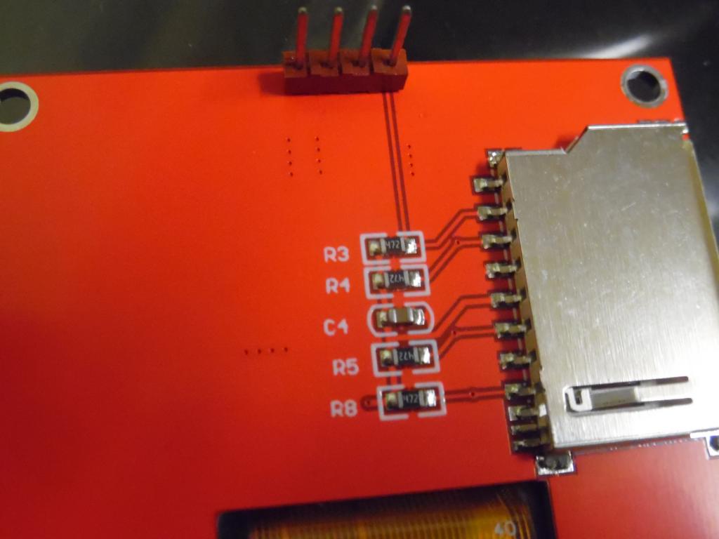

Phil, if you are familiar with this ips 9488 then which resistors need blobbing please?
and using 1n5819 and 10kr
no probs with reading sd card though, it's blit read/write.

Some ILI9341 and older ILI9488 boards require the resistors to be blobbed but the IPS ILI9488 is different as explained here and again .
On the 4" IPS ILI9488 R8 needs to be removed, not blobbed if the SD card is to share System SPI with the LCD panel.
R8 is connected to SDO and is a 4.7kΩ pullup to 3.3V. When SDO is connected to MISO R8 prevents the 10kΩ resistor pulling MISO low, stopping Blit from working.
Make sure you only use 3.3v on this board to avoid destroying your SD card. This board does not have a 3.3V regulator (U1) fitted, instead it is bypassed by a link (R0).
To make it interchangeable with other panels remove R0 and solder a 3.3V LDO regulator on U1.
Edited 2024-04-15 11:34 by phil99

  phil99 said  Some ILI9341 and older ILI9488 boards require the resistors to be blobbed but the IPS ILI9488 is different as explained here and again .
Brill Phil! a simple explanation that works.
Blit read/write now works and still reads sd card.
I use a 3.3V and 5V barrel jack reg board. 5V to lcd and 3.3V to pico 3.3V enable grounded so just a jumoer link to change 5V to 3.3V for lcd.
De soldering R8 was hard.
Surprised powering ils 9488 with 5V not blown it, I thought there was a reg u1 but it was a transistor for led/bl.
Thanks again stan

  Quote  A possible alternative to removing R8 may be to reduce the 10kΩ to 1kΩ - 1.5kΩ to override it. Untested, may be too low for some SD cards.
Got around to testing this and it works from 1kΩ to 2kΩ  but colour counter and Blit errors start at 2.2k.
All the SD cards I have are happy with this so I suggest leaving R8 in place and using 1.5kΩ or 1.8kΩ for the LCD_CS to MISO resistor.

More playing.
You can remove the diode and replace it with a 1nF capacitor and it all works. Pixel, Blit and SD card.

Phil, thanks for the advice.I tried ips 9488 again and gui calibrate no errors but today touch is working accurately. think it's the tight fit on the board, screen touches pico so maybe resistive layer distorted.
removing R8 sorted blit read/write and sd card reads ok
using 10KR and 1N5819
