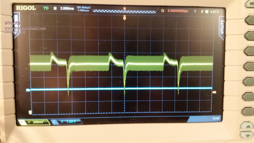

I am running an Explore 100 with a 5" touchscreen piggybacked onto it. I have a pressure transducer sending an analogue input to the Explore. No matter what I try I cannot eliminate the noise on the analogue signal. The noise is present on the supply rail and is then coming through the output of the transducer.
It is not present when I unplug the touchscreen. It is still there if I use a battery to supply the system so I am confident it is not coming through the power supply. Monitored at the supply rail the noise spikes down 0.5v. I have tried loading an image of it. It has a main period of approx. 8.5mS and the shallower ripple in the noise has a spike every 10uS.
I have tried bypass caps on the supply and on the back of the touchscreen board with no success. I have also tried a second touchscreen but with the same results.
Here is an image of the noise on the supply
Has anyone else had an issue with noise induced into the system from a touchscreen and any thoughts how to handle it please?

The SSD1963 screens use a switching regulator to boost the supply voltage to drive the screen backlight. All you can do is add additional filtering on the explore100 and/or on the SSD PCB. Or, if the application merits it, remove the switching regulator from the SSD1963 PCB and patch in a replacement DC supply.

I disconnected any I/O and just ran the Explore 100 with the touchscreen piggyback and put the CRO across the GND and 5v pins on connector 8 and noted the same noise as before. Could this mean there is a ground loop in the explore 100 PCB? I shall go through and check solder joints around the ground connections.
I will try a pot across gnd and 3.3 and see how the analog input reacts. I fear the noise may also affect the reference for the analog inputs.
maltherp's idea about substituting an alternate regulator for the backlight has merit and may be the long term solution unless I can source a better touchscreen.

I have made some measurements as suggested:
With the DSO earth connected to battery or PS earth.
Is the noise on Bat, PS + terminal                 noise present
Is the noise on the + pin of the micro    noise present at power input connector and 5v pin con 8 and 3.3v pin
Is the noise on the GND pin of the micro    small ripple
These test were on the battery with probe gnd to battery negative and amplitude of noise was similar in all cases except the gnd were the amplitude was about 40mV.
I will try and put in a screen shot.
The noise was still there and the same when the processor was held in reset- so this seems to confirm it is coming from the screen.

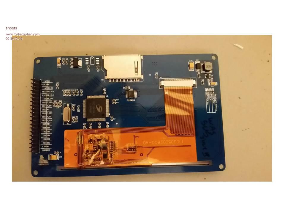

Posted: 01:54am 10 Oct 2019
I agree the battery internal impedance is not great- a string of AA batteries is all I could find. I get the same noise on the bench supply.
The amplitude of the noise does not change when the backlight intensity is varied from 75 to 5 so must just be switching noise of backlight circuitry. I will have a look at the back of the screen to see if a couple choke and caps can be fitted.
This is a pic of the rear of the screen. Has anyone had success with an alternate brand to this one? I would be wise to consider an alternate.

I will try both your suggestions. I did try a series of caps on the screen near the power input without joy (bottom LHS in the photo-since removed). I will try that as well as on the input to the MM. I will also have a look at applying bypass caps near the backlight boost circuitry.
Any ideas what the backlight voltage is boosted to on these screens? I suspect the boost cct may be at the top right. Will try and get to it tonight.
