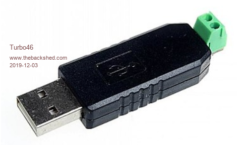

I have used one of these devices on my laptop to talk to RS485 devices using DOS MMBasic. It must use a similar automatic direction control.
Bill
Phil23
Joined: 27/03/2016
Posts: 1667
Posted: 07:59pm 03 Dec 2019
Have the same USB one too.
Found it very useful for monitoring the bus when I was setting up the coms between the MM & the Modbus meters.

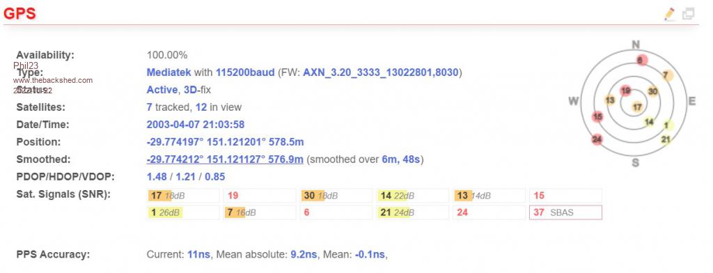

Posts: 6265
Posted: 08:53pm 20 Nov 2022
Hi Phil,
No MMBasic for the pico W.
PS.
Your Lightning detector controller needs a firmware update.
The GPS has suffered from a week 1024 rollover.
Plenty of info on the Blitz forum.
Don't get caught by blaming the GPS antenna before checking the forum (like i did).
Edited 2022-11-21 06:54 by TassyJim

Joined: 27/03/2016
Posts: 1667
Posted: 04:35am 21 Nov 2022
Thanks Jim,
And Yes I was browsing down the road of a replacement GPS Receiver.
Was blaming years in the weather for it's demise.
Saw an upgrade was mentioned, but got Gun Shy of doing it while thinking I had a dead GPS. Didn't read on for specifics, but am aware the roll over has killed a few things.

Joined: 27/03/2016
Posts: 1667
Posted: 09:03pm 21 Nov 2022
Thanks again @TassyJim
Just updated it to 9.4.
Haven't read all the treads about the issue, but it now has a lock,
just not showing a correct date & assume the time is GMT.
Is the firmware in the actual GPS Receiver able to be updated too.
Assume that's where the root of the issue lies.
Not sure how that would be done with this type of device that communicates over a single Coax feed.
Also just read the intro of Peter's post Re the PicoW firmware.
Last 3 years have had a lot of turmoil & little time to play with devices, but hopefully settling back to normal over the next six months.
Cheers.
Posts: 6265
Posted: 01:17am 22 Nov 2022
If you don't use the blitz as a NTP server, you don't have to worry about the date being out. The time is correct.
If you do want to use the Blitz as an NTP server like I do, you have to update the GPS firmware.
The full instructions are on the forum but a simple todo:
You power the Blitz from your PC so you can use the USB to serial built in to the unit. You also need TCPIP access.
You have to install some STM drivers. If your PC has been used for a few other STM chips, you may have the driver already. The W8 driver works for W10 and W11.
Via the web interface, turn the USB port 'on'
Run the PowerFlash from the globaltop zip
Update to V3.8 and all will be well.
