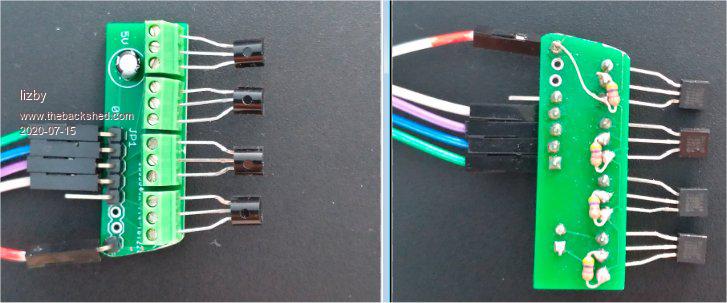

Posts: 3883
Posted: 06:13pm 14 Jul 2020
FWIW, and YMMV, I plugged this into the external port (with another wire on the bare pin):
I plugged the other ends of the data pins into 36, 37, 38, 40, and touching a finger to one or another of the DS18B20s, got this:
> print tempr(36),tempr(37),tempr(38),tempr(40)
24.75   25      25.125  25
27.75   27.875  29.25   25.3125
30.4375         26.875  28.3125         25.25
28.625  28      27.25   29.25
26.875  27.6875         26.5625         29.3125
I'd say these are almost certainly counterfeits.

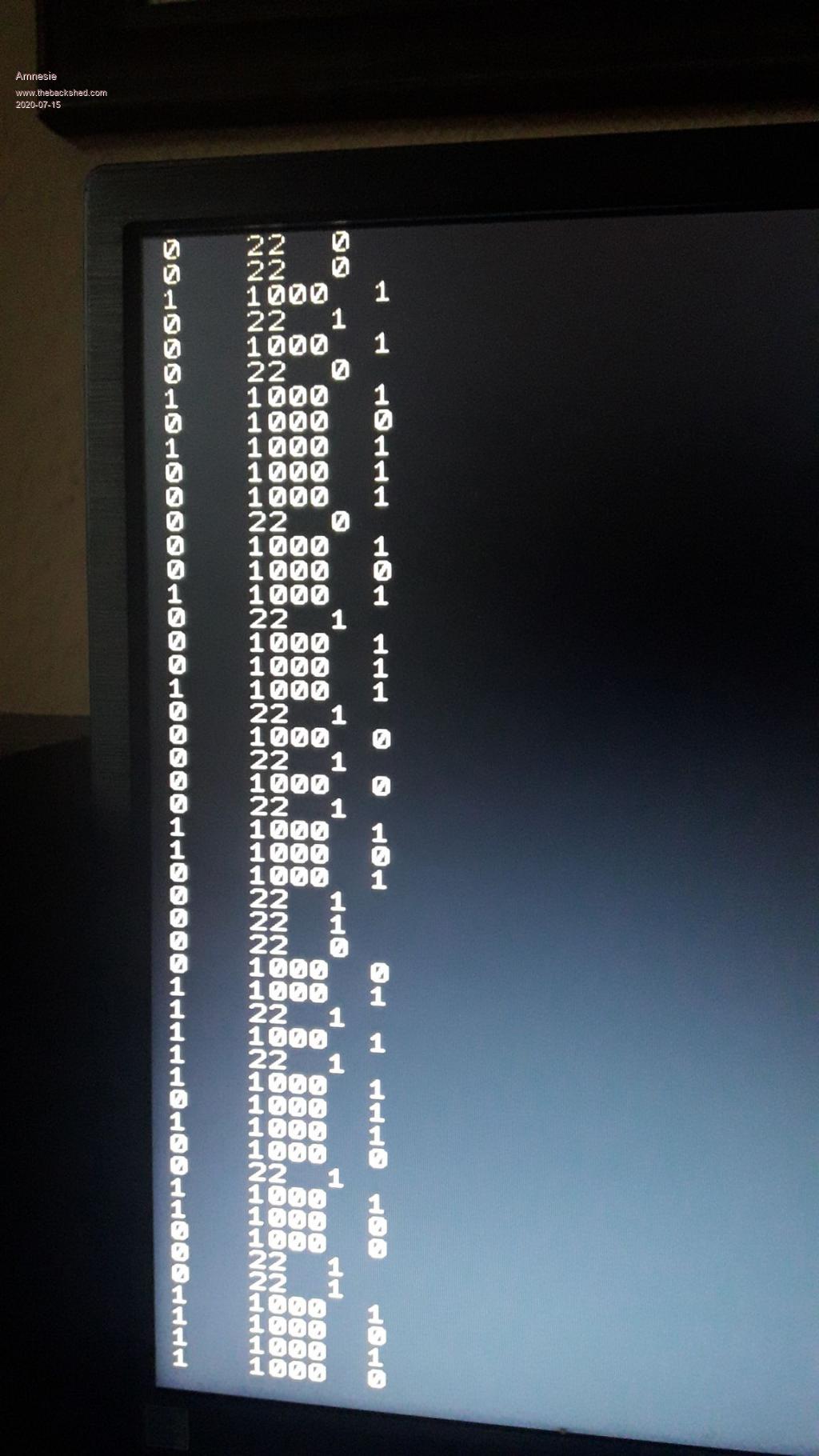

Your program BEFORE updating the firmware:

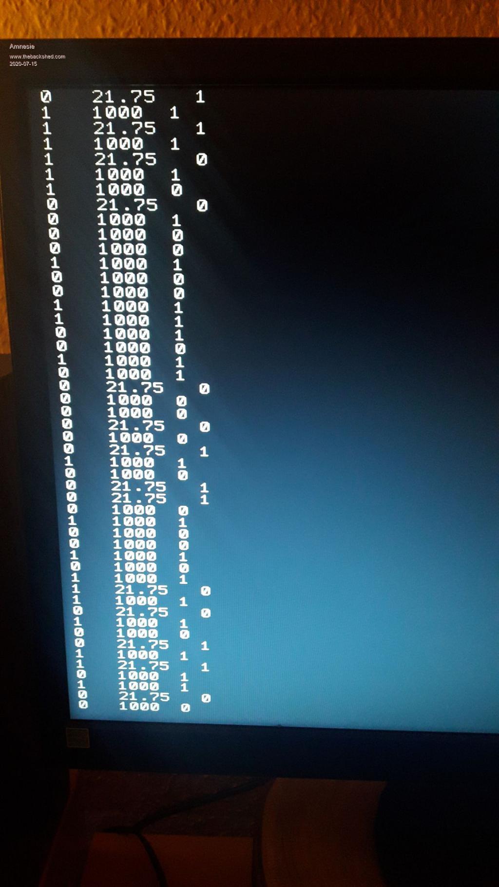

Your program AFTER updating the firmware:
I just ordered 100% original sensors at a german distributor... But something in my head says there must be a good reason for this... Because they generally work! But not with the maximite. When I say "work" I mean all the time... I have never ever seen before any false reading with my atmega328.
Maybe some additional info; the error readings are independent from the actual temperature. No matter if I touch the sensor or not, the  amount of errors are pretty much the same.
Edited 2020-07-15 05:28 by Amnesie

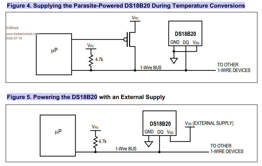

Posts: 6136
Posted: 07:52pm 14 Jul 2020
Hi Amnesie,
It is fact that the DS18B20 runs from 3.0V...5.5V.
If 1 wire is used there is voltage drop across the 4.7k resistor, and you may be looking at 3V at the chip (not 3.3V), I think you even measured 2.97V or so.
Not sure if you are using "parasite port, or external power on the DS18B20's.
Assuming parasite power:
Since these DS18B20's work well on 5V, the bus voltage may be the problem. Just on the edge. What you could do...the CMM2 also has +5V at the connector.
Please leave the 4.75k pullup to 3.3V, and add a second resistor 22k to +5V.
This will lift the 3V at the DS18B20 to roughly 3.3V. That is not sufficient for the STM32 to have a problem, but could force the DS18B20's to work.
P.S. matherp, do you distinguish between parasite power and external power (in other words, do you actively pull the IO pin high when there is no communication ?).
Edited 2020-07-15 06:02 by Volhout
