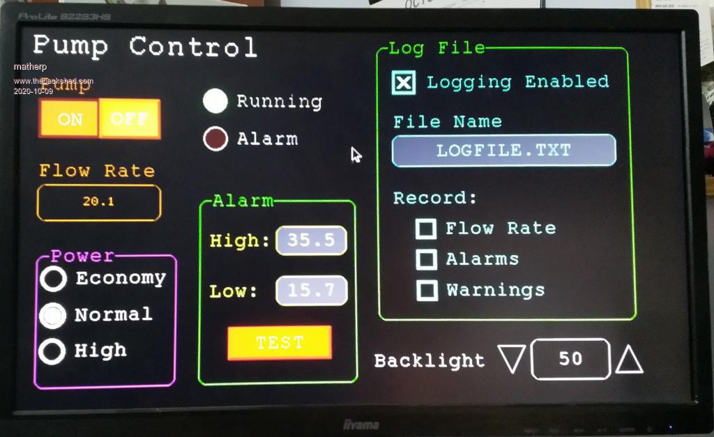

I've integrated Geoff's GUI functionality from the Micromite Plus into and experimental release of the CMM2. When using this with the Micromite Plus the functionality is tightly integrated with the LCD screen and Touch I/F. However, we have neither available on the CMM2 so I have implemented the cursor control and the "beep" as callbacks from the firmware to user supplied Basic subroutines.
GUI functionality should be exactly the same as the MM+ with the exception that the PAGE command is replaced with GUI PAGE.
Two Basic routines are required for full functionality
Function MM.CURSOR and subroutine MM.BEEP
MM.BEEP takes a single parameter which is the time in microseconds that the beep should last. The subroutine pro-forma is
sub MM.BEEP beeptime as integer
and I have implemented this as:
sub mm.beep beeptime as integer
 if beeptime and mm.info(sound)="OFF" then play tone 600,600,beeptime
end sub
Pretty simple
The Function MM.CURSOR is more complicated
function MM.CURSOR( request as integer) as integer
There are 6 requests that it needs to satisfy:
Request 1: Update the Basic programs values of X-coordinate, Y-coordinate and activation (e.g. keypress, or mouse button), if applicable any sprite used to display a cursor must be hidden when receiving this request. Finally this request should return the status of the activation (1=active e.g. mouse button pressed, 0=inactive)
Request 2: Return the current value of the X-coordinate
Request 3: Return the current value of the Y-coordinate
Request 4: Return the current value of the activation (1=active e.g. mouse button pressed, 0=inactive)
Request 5: Show any sprite used for a cursor at the current coordinates X, Y
Request 6: Update the Basic programs values of X-coordinate, Y-coordinate and activation (e.g. keypress, or mouse button), Move any sprite to the new coordinates, Return the current value of the activation (1=active e.g. mouse button pressed, 0=inactive)
My version using the HobbyTronics USB mouse I/F as in the video is as follows:
sub initmouse

function MM.CURSOR( t as integer) as integer
 MM.CURSOR=-1
 if t=1 then
   readtouch
   MM.CURSOR=lb
   if sprite(x,1)<>10000 then sprite hide 1
 elseif t=2 then
   if lb then MM.CURSOR=x
 elseif t=3 then
   if lb then MM.CURSOR=y
 elseif t=4 then
   MM.CURSOR=lb
 elseif t=5 then
   sprite show 1,x,y,1
 else
   readtouch
   MM.CURSOR=lb
   sprite show 1,x,y,1
 endif
end function
sub readtouch
local s$
 do
   i2c write 41,1,1,0
   i2c read 41,0,10,s$
   x=str2bin(uint16,left$(s$,2),big)
   y=str2bin(uint16,mid$(s$,3,2),big)
   lb=asc(mid$(s$,5,1))
 loop until x>=0 and x<MM.hres and y>=0 and y< mm.vres
end sub
end sub

dim integer x, y, lb, rb, sb, xs, ys, cs, ss
initmouse
sprite load "mouse.spr",1
GUI Interrupt TouchDown, TouchUp

Font 2,2 : GUI Caption c_head, "Pump Control", 10, 0
Font 3 : GUI Caption c_pmp, "Pump", 20, 60, , RGB(brown)
' now, define and display the controls
' first
GUI Switch sw_pmp, "ON|OFF", 20, 90, 150, 50, RGB(white),RGB(brown)
CtrlVal(sw_pmp) = 1
' the flow rate display box
Font 3 : GUI Caption c_flow, "Flow Rate", 20, 170,, RGB(brown),0
Font 4 : GUI Displaybox tb_flow, 20, 200, 150, 45
CtrlVal(tb_flow) = "20.1"
' the radio buttons and their frame
Font 3 : GUI Frame frm_pump, "Power", 20, 290, 170, 163,RGB(200,20,255)
GUI Radio r_econ, "Economy", 40, 318, 15, RGB(230, 230, 255)
GUI Radio r_norm, "Normal", 40, 364
GUI Radio r_hi, "High", 40, 408
CtrlVal(r_norm) = 1 ' start with the "normal" button selected
' the alarm frame with two number boxes and a push button switch
Font 3 : GUI Frame frm_alarm, "Alarm", 220, 220, 200, 233,RGB(green)
GUI Caption c_hi, "High:", 232, 260, LT, RGB(yellow)
GUI Numberbox nbr_hi, 318,MM.info(VPos)-6,90,MM.info(FontHeight)+12,RGB(yellow),RGB(64,64,64)
GUI Caption c_lo, "Low:", 232, 325, LT, RGB(yellow),0
GUI Numberbox nbr_lo, 318,MM.info(VPos)-6,90,MM.info(FontHeight)+12,RGB(yellow),RGB(64,64,64)
GUI Button pb_test, "TEST", 257, 383, 130, 40,RGB(yellow), RGB(red)
CtrlVal(nbr_lo) = 15.7 : CtrlVal(nbr_hi) = 35.5
' draw the two LEDs
Const ledsX = 240, coff = 50 ' define their position
ledsY = 90 : GUI LED led_run, "Running", ledsX, ledsY, 15, RGB(green)
ledsY = ledsY+49 : GUI LED led_alarm, "Alarm", ledsX, ledsY, 15, RGB(red)
CtrlVal(led_run) = 1 ' the switch defaults to on so set the LED on
' the logging frame with check boxes and a text box
Colour RGB(cyan), 0
GUI Frame frm_log, "Log File", 450, 20, 330, 355, RGB(green)
GUI Checkbox cb_enabled, "Logging Enabled", 470, 50, 30, RGB(cyan)
GUI Caption c_fname, "File Name", 470, 105
GUI Textbox tb_fname, 470, 135, 290, 40, RGB(cyan), RGB(64,64,64)
GUI Caption c_log, "Record:", 470, 205, , RGB(cyan), 0
GUI Checkbox cb_flow, "Flow Rate", 500, 245, 25
GUI Checkbox cb_alarm, "Alarms", 500, 285, 25
GUI Checkbox cb_warn, "Warnings", 500, 325, 25
CtrlVal(cb_enabled) = 1
CtrlVal(tb_fname) = "LOGFILE.TXT"
' define and display the spinbox for controlling the backlight
GUI Caption c_bright, "Backlight", 442, 415,,RGB(200,200,255),0
GUI Spinbox sb_bright, MM.info(HPos) + 8, 400, 200, 50,,,10, 10, 100
CtrlVal(sb_bright) = 50

Posts: 11873
Posted: 06:05pm 09 Oct 2020
Here is a version that works using the keyboard to position the cursor. Arrow keys to move and space to activate a control. This demonstrates the H/W independence of the callback mechanism. You can use any device you want to move the cursor - just follow the rules for MM.CURSOR and it should work.
' Demonstration program for the Micromite+
' It does not do anything useful except demo the various controls
' Geoff Graham, October 2015
Option Explicit
Dim ledsY
option console serial
Colour RGB(white), RGB(black)
' reference numbers for the controls are defined as constants
const left=130, right=131, down=129, up=128, button=32
Const c_head = 1, c_pmp = 2, sw_pmp = 3, c_flow = 4, tb_flow = 5
Const led_run = 6, led_alarm = 7
Const frm_alarm = 20, nbr_hi = 21, nbr_lo = 22, pb_test =23
Const c_hi = 24, c_lo = 25
Const frm_pump = 30, r_econ = 31, r_norm = 32, r_hi = 33
Const frm_log = 40, cb_enabled = 41, c_fname = 42, tb_fname = 43
Const c_log = 44, cb_flow = 45, cb_pwr = 46, cb_warn = 47
Const cb_alarm = 48, c_bright = 49, sb_bright = 50
' now draw the "Pump Control" display
'CLS
dim integer x=mm.hres\2, y=mm.vres\2, lb=0
settick 20,keyscan
' display the heading
' first
CtrlVal(sw_pmp) = 1
' draw the two LEDs
Colour RGB(cyan), 0
' All the controls have been defined and displayed. At this point
' the program could do some real work but because this is just a
' demo there is nothing to do. So it just sits in a loop.
' the interrupt routine for touch down
' using a select case command it has a different process for each
' control
Sub TouchDown
 local integer mbox
'  print "down"
 Select Case Touch(REF) ' find out the control touched
 Case cb_enabled ' the enable check box
   If CtrlVal(cb_enabled) Then
     GUI Restore c_fname, tb_fname, c_log, cb_flow, cb_alarm, cb_warn
   Else
     mbox=MsgBox("Are you sure?", "YES","CANCEL")
'      print mbox
     if mbox=1 then
       GUI Disable c_fname, tb_fname, c_log, cb_flow, cb_alarm, cb_warn
     else
       CtrlVal(cb_enabled)=1
     endif
   EndIf
 Case sb_bright ' the brightness spin box
'    BackLight CtrlVal(sb_bright)
 Case sw_pmp ' the pump on/off switch
   CtrlVal(led_run) = CtrlVal(sw_pmp)
   CtrlVal(tb_flow) = Str$(CtrlVal(sw_pmp) * 20.1)
   CtrlVal(r_norm) = 1
 Case pb_test ' the alarm test button
   CtrlVal(led_alarm) = 1
   GUI beep 250
 Case r_econ ' the economy radio button
   CtrlVal(tb_flow) = Str$(CtrlVal(sw_pmp) * 18.3)
 Case r_norm ' the normal radio button
 Case r_hi ' the high radio button
   CtrlVal(tb_flow) = Str$(CtrlVal(sw_pmp) * 23.7)
 End Select
End Sub
' interrupt routine when the touch is removed
Sub TouchUp
 Select Case Touch(LASTREF) ' use the last reference
 Case pb_test ' was it the test button
   CtrlVal(led_alarm) = 0 ' turn off the LED
 End Select
End Sub
 MM.CURSOR=-1
 if t=1 then
   MM.CURSOR=lb
 elseif t=2 then
 elseif t=3 then
 elseif t=4 then
   MM.CURSOR=lb
 elseif t=5 then
   sprite show 1,x,y,1
 else
   MM.CURSOR=lb
   sprite show 1,x,y,1
 endif
end function
end sub
sub keyscan
local integer i,n
 static integer currkeys(6)
 static float keyspeed(6)=(1,1,1,1,1,1,1)
 lb=0
 n=keydown(0)
 for i= 1 to n
   if currkeys(i)=keydown(i) then
     keyspeed(i)=keyspeed(i)+0.1
     if keyspeed(i)>5 then keyspeed(i)=5
   else
     keyspeed(i)=1
   endif
 next i
 for i= 1 to n
  if currkeys(i)=left then
     x=x-keyspeed(i)
     if x<0 then x=0
   endif
   if currkeys(i)=right then
     x=x+keyspeed(i)
     if x>=MM.HRES then x=MM.HRES-1
   endif
   if currkeys(i)=up then
     y=y-keyspeed(i)
     if y<0 then y=0
   endif
   if currkeys(i)=down then
     y=y+keyspeed(i)
     if Y>= MM.VRES then y=MM.VRES-1
   endif
   if currkeys(i)=button then
     lb=1
   endif
 next i
end sub
