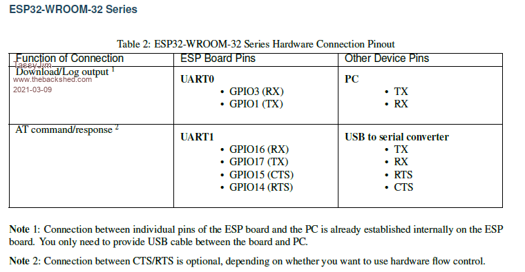

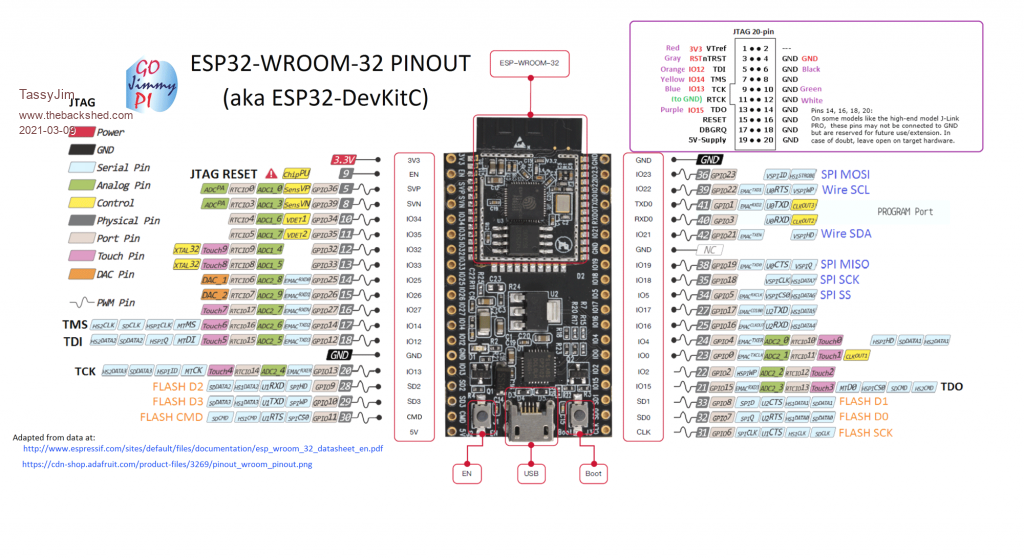

Posts: 6638
Posted: 08:33pm 08 Mar 2021
The only pins I have used are the serial port ones.
I am not using CTS (pin GPIO15) but it is worth having it available for future uses.
The layout of the board does not matter. As long as it has the 4 IO pins available - GPIO 14,15,16,16.
They are the pins that the current firmware uses but I can not guarantee that the next firmware uses the same pins.
The board you are looking at should be fine. They have the required pins broken out (if the photo is to be believed)
The ones I have use this layout:
The GPIOs are in the correct position but the 'purpose' for each pin is not necessarily correct on the diagram.
No point referring to the exact purchase I made, it was an Australian supplier and the item has been 'updated' since my purchase.
Posts: 4410
Posted: 12:01pm 09 Mar 2021
Thanks Jim,
Am I also going to need a firmware programmer for the ESP32 of some sort ?
Posts: 3888
Posted: 01:59pm 09 Mar 2021
  thwill said  Am I also going to need a firmware programmer for the ESP32 of some sort
Modules with USB onboard should not need additional hardware (unlike the ESP-01).
If you need to update the firmware, there are a number of uploaders available, including the one in the zip file in matherp's ESP-01 thread here or from Expressif here .
I'm not sure where the latest ESP32 AT firmware is (if that is needed).
Edited 2021-03-10 00:04 by lizby
Posts: 6638
Posted: 08:35pm 09 Mar 2021
Latest AT binary (if needed)
https://docs.espressif.com/projects/esp-at/en/latest/AT_Binary_Lists/ESP32_AT_binaries.html
You will need the first one on the page.
espressif also have plenty of documentation available.
It can take a bit to sort out which docs you want.
