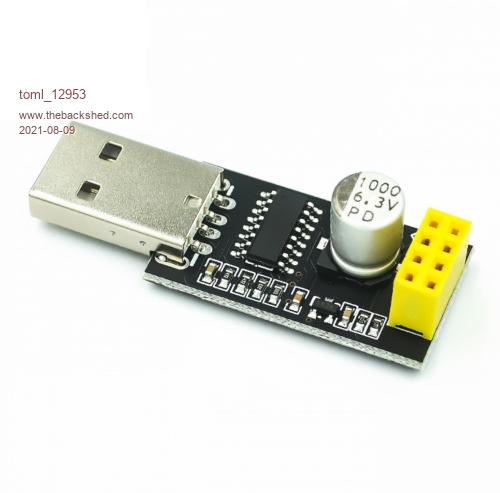

Can the device pictured below be used to flash new firmware into the ESP-01? I don't see a switch on it to allow that. Also, what is the URL of the latest firmware? I see 1.7.4 listed in this forum but when I go to the Espressif website it looks like the latest version is 2.1 or 2.2 and there's a choice of VROOM, WROVER, PICO, and SOLO. Which one (if any) can we use?

Yes if you add a tack switch and a jumper per this YouTube video.  https://www.youtube.com/watch?v=6uaIWZCRSz8&ab_channel=CsongorVarga  It works for me.  I am not sure if that bodge wire is necessary but I did it anyway and it works fine.  It also works as the serial link if you do not push the switch while plunging it in.

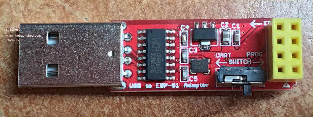

  Quote  Can the device pictured below be used to flash new firmware into the ESP-01?
Don't buy this version. Look for the same but with a switch

Toml--this link shows how to solder two wires (fiddly) to the module you showed and then flash mode is automatically set--no need for a switch.
I've used it many times, and it has greatly reduced my frustration level in flashing ESP-01s.
Use a fine (for smd) soldering iron tip.
OK, I got one of those. It works fine in UART mode. I'd like to use it to update my firmware but I can't seem to find exactly which file(s) to use on the espressif site. Do you have a URL to the latest version?

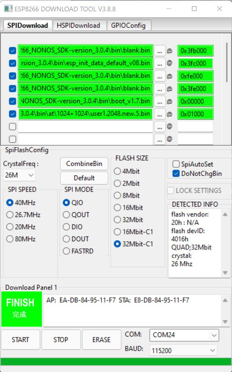

Two months ago I used this 2017 link: flash esp8266
I used flash_download_tools_v3.8.8.exe with this setup:
I didn't save the exact url I used to get the NONOS_SDK files.

I found a download site for Non-OS v1.7.4. I don't know what addresses to use, however.
My unit has this configuration:
flash vendor:
20h : N/A
flash devID:
4016h
QUAD;32Mbit
crystal:
26 Mhz
No matter what addresses I use for the files, when I change back to UART mode and start my terminal program (TeraTerm), all I get is a constantly scrolling display of garbage. My flash size is 32Mbit. Does this use different addresses from 32Mbit-C1? The docs don't say what addresses to use for 32Mbit, only 32Mbit-C1. I tried flashing using the 32Mbit-C1 addresses but still get only the scrolling garbage.

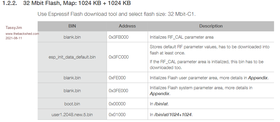

Posts: 6638
Posted: 03:32am 11 Aug 2021
https://www.espressif.com/sites/default/files/documentation/4a-esp8266_at_instruction_set_en.pdf
The manual has a section on firmware loading.
Have you tried those settings?

toml_12953
Joined: 13/02/2015
Posts: 740
Posted: 06:08am 11 Aug 2021
  TassyJim said  https://www.espressif.com/sites/default/files/documentation/4a-esp8266_at_instruction_set_en.pdf
Edit:
Thanks. I did try that. Here's what it looks like:
Here's what I see in the uploader text:
CONNECT BAUD: 115200
Stub is already running. No upload is necessary.
crc_efuse_4bit: 0
crc_calc_4bit: 2
48bit mac
Compressed 4080 bytes to 2936...
Compressed 413444 bytes to 296955...
Compressed 4096 bytes to 26...
Compressed 128 bytes to 75...
is stub and send flash finish
I still get nothing but garbage in the terminal. It could be a defective ESP-01 or maybe the cheap uploader interface. I have a bunch of ESP-01s coming in soon so at least I can check that possibility.

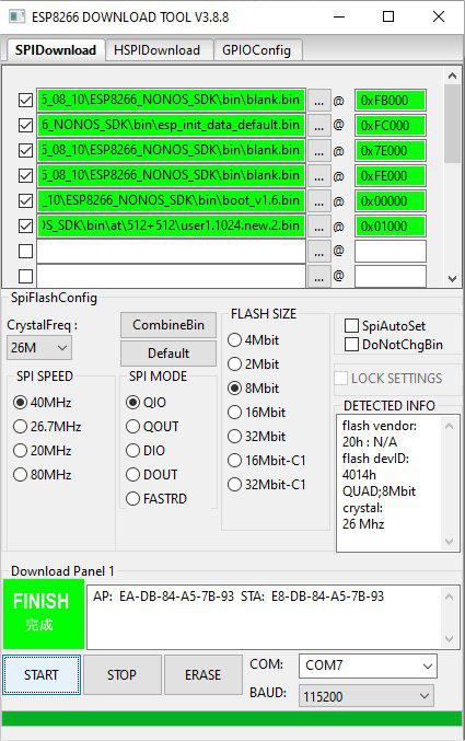

Posts: 6254
Posted: 07:16am 11 Aug 2021
Honestly, I just tried to program my ESP-01 (512+512 version) with the 1.7.4 no-OS version, and it only outputs garbage. I took the image files from the 512 folder, and burned them using esptool (linux).
I got a success message after programming. But when I powered them the blue LED kept flashing, and garbage came out of the USB port. Tried several baudrates, tried interrupting, tried blindly typing AT+RESTORE, nothing worked.
Tried 2 times, then I could not program the esp-01 anymore. It simply came with a error message, cannot write bootloader (the first to get programmed).
Then I made the modification lizby suggested (2 diodes) and using the Arduino toolchain I could write the esp-01 (blink program). So the esp-01 is not dead.
I already downloaded the 1.6.2 no-OS version (the last said to fit in 512k chips) and may try this tonight.
I did some googling, and there may be an issue with the programming button (GP0) rework of the UART interface. The original bootloader seemed happy with pressing the button during powerup. There have been people suggesting that the newer bootloaders need this pin low constantly during programming. Maybe that is why the diode rework may have worked.
I used esptool in the ubuntu repository (sudo apt-get install esptool). This is not the esptool.py everybody else is using, it has a different command set.

Posts: 12186
Posted: 01:51pm 11 Aug 2021
  Quote  I don't know how to change the partition table
Look at the post by lizby above. Use the 512+512 image and his address settings. If you have a black ESP01 it is almost certainly 8Mbit/1Mbyte
