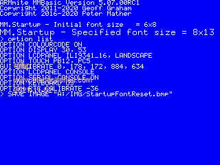

I thought I had tried the MM.Startup method and have just retried to confirm that it doesn't work, well not totally. It does change the Font within MM.Startup but then when the interpreter completes it's initialization ready to do something, the font has switched back to font 7 again.
I have this code added to my program:
sub MM.Startup()
   ? "MM.Startup - Initial font size   = " + Str$(MM.FontWidth) + "x" + Str$(MM.FontHeight)
   Font 1
   ? "MM.Startup - Specified font size = " + Str$(MM.FontWidth) + "x" + Str$(MM.FontHeight)
end sub
I used OPTION LCDPANEL CONSOLE 1, RGB(WHITE), RGB(BLUE) to enable the Console on the LCDPanel. This sets Font 1 and that is fine until the next power cycle.
After a power cycle the following image shows the display on the LCDPanel. Note that the line from MM.Startup displaying the "Specified" font size is actually 8x13 (Font 1), but the command prompt and subsequent console output is displayed in Font 7 again!!
Posts: 11984
Posted: 10:17am 02 Nov 2021
OK now I understand, it is a bug and I've fixed it
