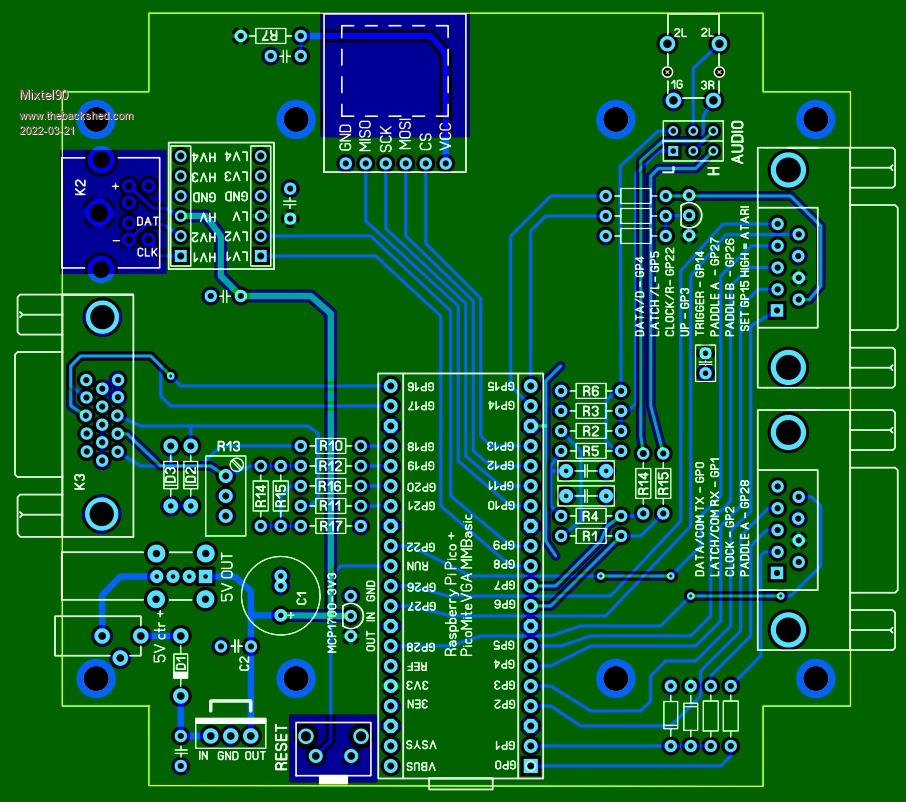

I have a preliminary design now and have run out of pins. :)
Any comments on this spec before I take it further?
PicoMite VGA (plugged in) - standard setup with PS/2 keyboard, level shifter, VGA, SD card etc.
Audio socket has a header to select low/line or high/headphones
Two Nunchuck ports (anyone know where to get the proper sockets? they would be nice.)
Reset button
MCP1700-3V3 Linear reg - onboard SMPS is disabled.
5V supply input via 3.5/1.3mm barrel jack
USB-A socket for 5V out only. (can be used to power a VGA-HDMI converter)
9-pin Atari-compatible joystick port up-down-left-right-trigger-paddle A-paddle B - 3V3-GND
1-wire networking (but I'm not sure about a connector. 2.5mm jack?)
Fits into the Hammond 1593WBK case if you happen to have one available. Costs too much to get a single one here, although they are available from Mouser, Digi-Key (6 UKP + 12 UKP postage!) & Farnell.
PCB is 100mm x 98mm
I realise that the 1-wire system may not be ideal for networking, but with a small number of players connected by twisted pair it should be fine if the message lengths are kept short, I think. There was only one pin left. I could have sacrificed the joystick port but I thought someone might fancy writing a simple flight simulator. ;)

Added position for additional 78xx-compatible switching regulator. This is to allow the board to be powered from up to 40V for use in caravans, on boats etc. The 5V supply from the USB-A socket is taken from this. Max total load is 800mA with short term up to 1A. It's purely optional and would normally be replaced with a wire link.

I'm not sure about the Atari joystick - it's digital (except for the 2 paddles, they need analogue pins) so not really suitable for a flight-simulator and it only has the one fire button.
Also if you're going to have networking I think for a retro computer you really want to  provide enough pins for serial, at least a TX and an RX - and I know you don't have enough pins, but I'm just saying .
Anyway just to confirm that you are not alone in your madness, and with no obligation, and you'd probably be doing me a favour if you didn't, but if you design a version with 2 x DB9 connectors on the front to take NES controllers (found them cheap as chips on AliExpress):
and another one on the back connected for minimal TX/RX serial then I will build at least one and (endeavour to) write a game that will run on the contraption - strictly speaking I will try to make a multiplayer version of @vegipete's "Rocks in Space" - unless he objects.

A basic flight sim could be done. You only need analogue ports (the paddle inputs) for the two joystick axes, everything else can be keyboard driven. I know it's not ideal, but it works - Microsoft flight sim used to work like that. I happen to have an analogue Flightstick which has a single DB9 connector, which was my main reason for putting one on. :)
Hmmm... Not only have I never met a Nunchuck face to face, neither have I any experience with NES controllers. :) No idea how they work at all. Are you sure the modern equivalents aren't USB?

The design for an *NES* version is coming along. Can't fit 2x DB9 along the back so might need to think of something else for a network socket (RJ11). I need the VGA, power and power out sockets on the back. Got 2x DB9 along the front ok though. :) Keyboard, SD card & audio on one side, PicoMite & Reset on the other. No power switch - pull the plug. :)
I *could* make the board bigger to fit the CMM2 case but I have the same problem (P&P costs) getting those, they cost more and the PCB costs more. Anyway, I'm an awkward so and so. :)

This time I have the IO but not quite as much space. :)
At the moment the two game ports are separate and COM1 has its own pins too.
"Port 1" is currently on GP2, GP3, GP4
Yep... I could get COM1 to that easily enough.
"Port 2" is currently on GP26, GP27, GP28.
The latter isn't pin compatible with a "normal" joystick port, unfortunately, mainly because Trig is on 3V3! It might be possible to get enough connections to it to make it compatible with a Flightstick. I'll think about that one.

Prelim PCB later this evening. Have it sorted, I think.
Port 1 is NES + PADDLE-A / COM1
Port 2 is NES / ATARI with both paddles. Select ATARI mode in software.
Port 1 would need an adapter for a normal paddle as + is on the wrong pin and there is no Trig - one of the other pins would have to be used.

Preliminary design:
Yes, Tom, I rather enjoy designing PCBs. :) I used to be an electrical design draughtsman in earlier times so it's nice to do CAD type stuff where I can see the finished results.

Circuit diagram tomorrow night, probably, then you can see how I work my magic. lol
Not sure if I should put some sort of protection on the joystick inputs - or external pull-down resistors anyway. Might be a good idea.

@Mick, I don't know about the Pico but I've had trouble using the Micromite's weak internal pullup resistors for switch inputs even on a short length of wire. I was getting false triggering from noise.
Do you mean PULLUP resistors?
