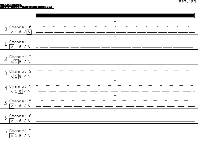

Hi All,
As suggested by Peter, the logic analyzer project get's a new thread.
Pluto: maybe this is of interest to you. PAN and SCAN (zoom and scoll) is working on the cursor keys. The trigger indication is not yet live, but you can set the trigger typing "t". Changing the sampling rate under UI control is next.
Current focus is on:
1/ faster plotting
2/ trigger jitter

Sub set_screen
 MODE 1:Colour 0,RGB(WHITE):CLS :Font 7
 Local f%,i%
 Dim a$(2)=("x","1","0")
 Dim tr(7)=(0,0,1,1,2,0,0,0)
'text
 For f%=0 To 7
   Font 2:Print @(0,84+48*f%); f%
   Font 1:Print @(30,84+48*f%); "Channel";f%
'color
   TILE 0,5+f%*3,0,RGB(WHITE),7,2:TILE 7,5+f%*3,0,RGB(yellow),33,2
   TILE 0,4+f%*3,0,RGB(midgreen),40,1
   Line 0,64+f%*48,640,64+f%*48
'trigger boxes
   For i%=0 To 2
     If tr(f%)=i% Then
       Box 34+i%*14,96+48*f%,16,16
     EndIf
'trigger text
     Print @(38+i%*14,98+48*f%) a$(i%)
   Next i%
 Next
End Sub

Don't know if it is relevant for this application but the next beta will allow you to execute a PIO instruction from a CFunction (same functionality as the PIO EXECUTE command) and a CFunction can in turn be triggered by a H/W interrupt such as an edge triggered pin change.
Posts: 3411
Posted: 11:42am 28 Jan 2023
Thanks Volhout this will be very useful.
Displayed pulse widths seem to fluctuate a bit.
Posts: 6169
Posted: 01:42pm 28 Jan 2023
In this version, the display shows all samples when you zoom in maximum. When your sampling rate is 10kHz (100us) a signal of 120us can appear as 1 sample, 100us, or as 2 samples 200us. Depending on the exact moment of the first sample. To minimize this effect the trigger program runs fastest.
This effect will be less if you sample faster (press + key few times.)
When you zoom out, you will start seeing aliasing effects, since the display will show 1 in 4 or 1 in 8 samples. The LA samples 4096 samples, but shows only 128 or 256 at a time.
I hope this explains a bit...
P.s. if you have optio audio set, channel 6 and 7 will show aliasing signal of 44kHz. Only when you turn the samping up to 1MHz it makes any sense. At the moment you can not trigger on channel 6 and 7.
Edited 2023-01-28 23:50 by Volhout

I have taken your code and will paste it into the logic analyzer. When there is anything you are working on to improve, just let me know. I have done what you suggest, and pasted it in the logic analyzer.
My target is to print the decoded text (start/stop/read address/R/W) in the green bar above the waveform at the location where it is in the serial stream.
In my logic analyzer (I progressed to version 0.13) I have edge trigger implemented and single trigger. It is not yet finished, but do you want it to base the decoder on , I can post a zip.
I very much like this way of working together. DMA from Peter, graphics from Martin, I2C decoder from you, PIO engine from me.... A true community project.
User interface:
+/- to adapt sampling rate
s = single trigger
r=repeated trigger (run)
0...6 toggle through trigger options for that particular channel.
It may not be stable, please provide feedback.
P.S. it is default 6 channel now
known bug: when the DMA times out (at 21MSps this is after 2 minutes) and you press a key, you get an error message and the program stops. If you are running 500kSps, this happens after 1 hour waiting for a trigger.
Edited 2023-02-01 02:29 by Volhout
