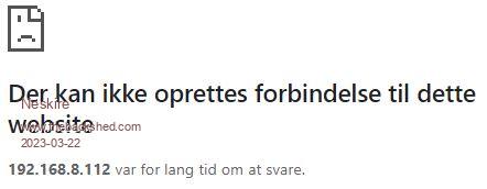

I have been testing 5 PicoW's running 5.07.07a19 and 5.07.07a21 connected to a TP-Link TL-MR3020 router (stand alone, no internet),
all working  great, no issues. They have been running for dayes now.
I am using Tera Term and Wireshark to monitor.
Then I switch PicoW1 and PicoW3 to a Huawei Soyealink B535-333 router (with internet) and some issues showed up.
"Unable to connect to this website 192.168.8.112 took too long to respond.
ERR_CONNECTION_TIMED_OUT"
It takes from minutes to hours before it stops responding to a page refresh. Same experience with PicoW1.
The only  way to get it working again is a Power reset. The MMBasic seems to be working ok.
Anyone have an idea what's going on? My knowledge of tcp/ip communication is limited.

Start by updating your picoWs to the latest firmware.
a28 has a lot of improvements which might solve your problem.
You can use the version in the first post on this page
https://www.thebackshed.com/forum/uploads/matherp/2023-03-21_181400_PicoMiteWeb%20(4).zip
or the a28 from earlier in the same thread.
https://www.thebackshed.com/forum/ViewTopic.php?FID=16&TID=15696&LastEntry=Y#200555#200536

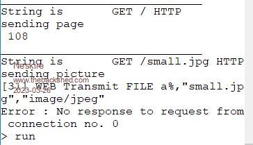

The 3 PicoW's connected to the Huawei Soyealink B535-333 router all failed.
Then I switched PicoW1, PicoW3 and PicoW4 to a Huawei B525s 23a router.
After a short time PicoW4 stopped with an error.
Picow4_Huawei_error.zip
OPTION AUTORUN ON
Dim buff%(512)
Dim counter%=0
Dim mystring$="4 The PicoMite Web is GO!!!"
WEB tcp interrupt tcpintr
? "OK"
Sub tcpintr
inc counter%
print counter%
Local p%, t%, a%, s$
For a%=1 To mm.info(max connections)
  LongString clear buff%()
  WEB tcp read a%,buff%()
  p%=LInStr(buff%(),"GET")
  t%=LInStr(buff%(),"HTTP")
  If LLen(buff%()) Then Print "_____________________________"
  s$=""
  If (p%<>0) And  (t%<>0) And (t%>p%) Then
     s$=LGetStr$(buff%(),p%,t%-p%+4)
     Print "String is ",s$
  EndIf
  If Instr(s$,"small") Then
    Print "sending picture"
     WEB Transmit FILE a%,"small.jpg","image/jpeg"
  ElseIf Instr(s$,"favicon") Then
     Print "sending icon"
     WEB Transmit FILE a%,"favicon.ico","image/vnd.microsoft.icon"
  ElseIf Instr(s$,"HTTP") Then
     Print "sending page"
     WEB transmit page a%,"t5m.html"
  EndIf
Next a%
End Sub
How is this possible ??
Restarted PicoW4 and all have now been runnig for 40+ hours, great.
My conclusion: the Huawei Soyealink B535-333 router has an issue with the PicoW as an IOT.
I will now ask my ISP why (both Huawei router has been supplyed by them).
Now I am able to continue with some more exiting programing.
Thanks to Peter's and Geoff's great work, which gives the Rpi Pico a very big advantage, built-in "OS" with a very advanced Basic programming language.
Many thanks Peter and Geoff
