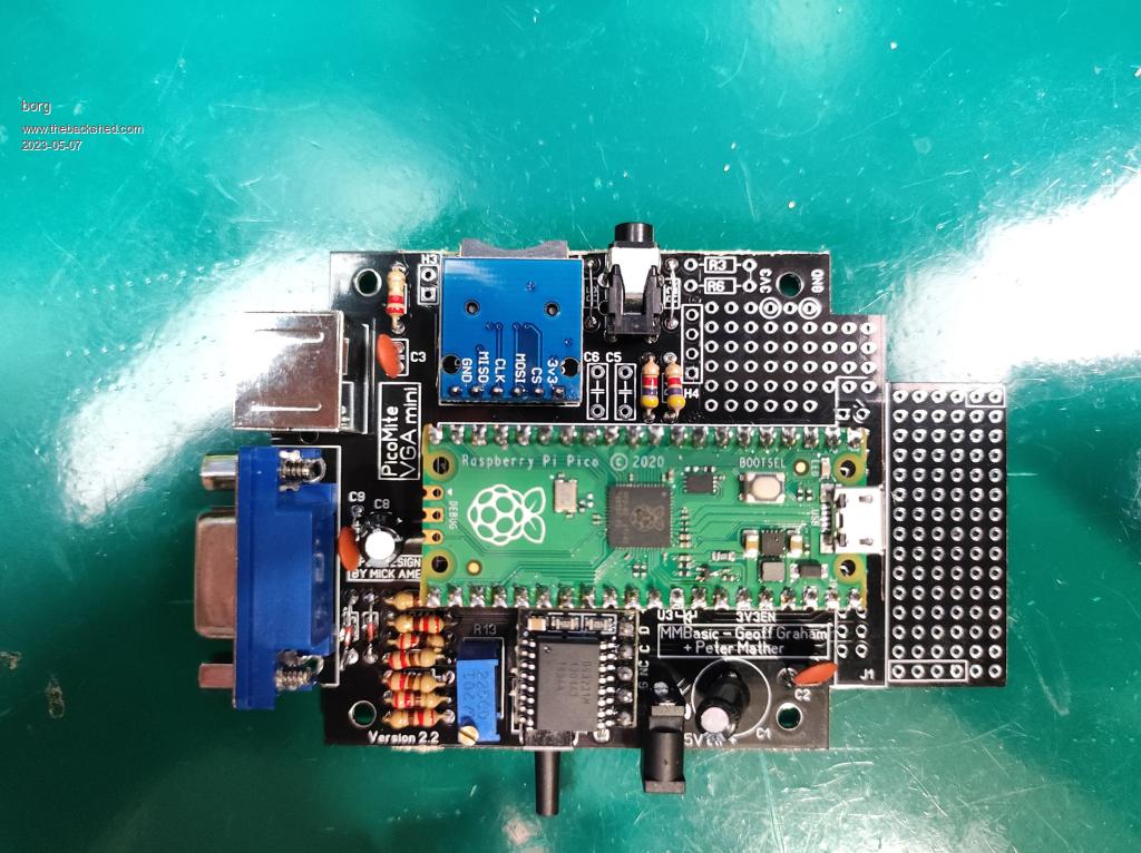

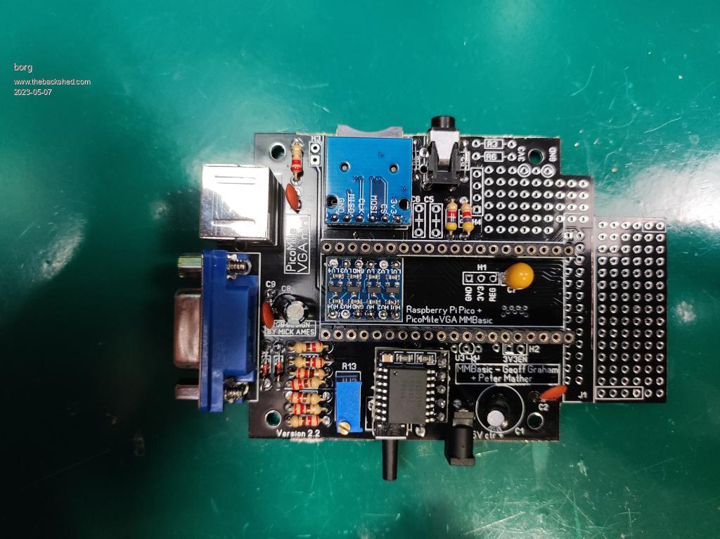

My PicoMite do not boot.
I can connect to terminal by USB when Pi is outside the board, but after inserting it - nothing happens. No VGA, no terminal connection...
Am I missing something?
Maybe diodes are inserted backwards? Or must I connect something on H1/H2?

I should be able to get you going on this. It's my design. :)
Have you got the regulator fitted underneath the board? It's not essential.
What test gear have you got? A multimeter should be enough.
I can't see from your pictures, but underneath the RTC there should be D1, with the striped end towards the centre of the PCB.
Check that pins 36 (3V3) and 39 (VSYS) have been soldered under the board.

Posted: 08:06pm 06 May 2023
This is a version without regulator. The diod you asked is mounted OK.
I have multimeter :)

Posts: 9030
Posted: 08:15pm 06 May 2023
Take the Pico and RTC out.
Find a GND connection (the + end of D2 & D3 will do, or anywhere else. :) )for the black lead of your meter and check for low resistance or a short from 3V3 to GND. You might get a very short charging pulse from the capacitors but that's all. It should settle down to a high resistance.
The regulator is optional. It's surface mount and is fitted underneath the PCB.
I can't see anything obvious on the top side of your PCB that would prevent it from booting. Check for solder whiskers between pins, especially between 3V3EN and GND as that would shut down the 3V3 supply.

Posted: 08:31pm 06 May 2023
I have short circuit between GND and 3V3...

Posted: 08:35pm 06 May 2023
Ah, that'll do it. The regulator on the Pico will shut down in that case.
On this PCB the top copper surface is connected to 3V3 and the bottom one is connected to GND, if that's of any help.

Posted: 08:51pm 06 May 2023
F.....ck. The PCBs are defected.... I have short cirrcut on empty pcb...

Posted: 08:56pm 06 May 2023
Oh! That's unusual.
Have a look wherever traces run between others on the Pico connectors. A typical place is by the centre pin of H1, where a 3V3 trace passes next to a GND one.

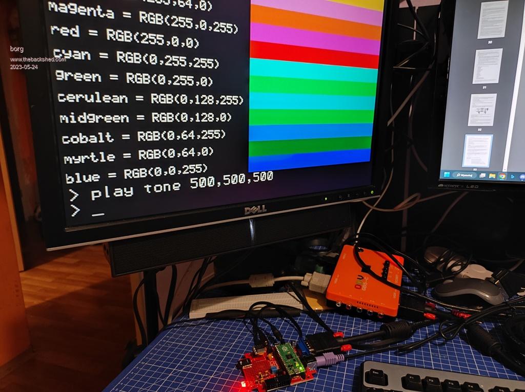

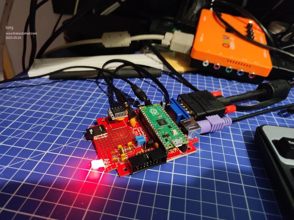

borg:
This is quite an old design for me and I've learned a lot since then :)
It's currently up to version 6 and the files for it can be found by following the link in my sig below. PicoMite VGA mini 6. Fits the same box but no longer has a plug-in "sea of holes" board.
borg
Joined: 09/12/2020
Location: Poland
Posts: 12
Posted: 10:42am 07 May 2023
I will try newer design :)
I was starting to think I am missing something obvious... I'm glad I'm not crazy :P

Posted: 04:50pm 07 May 2023
The right side of the J1 outline looks unusual. Is that edge scored? Also some of the board edges look rough - it would only take thin copper sliver on the edge to connect the top and bottom sides. I would place sand paper flat on a table and sand the board edges smooth.
Posts: 9030
Posted: 05:07pm 07 May 2023
That's a very good point. When I cut mine I always give them a bit of a rub with a file to smooth them off a bit. It's a worthwhile step to take.
