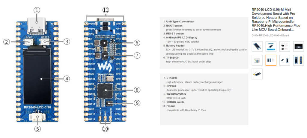

Hello,
on amazon I found this: RP2040-LCD-0.96-M
Does anyone know whether it runs with PicoMite?
-andreas
Posts: 9030
Posted: 09:49am 29 May 2023
On first glance I think so. The display uses GP8, GP9, GP10, GP11, GP12, GP25 so no PS2 keyboard. No guarantee for any speed over 133MHz though!

I can't see anything that would prevent MMBasic from running on it. However:
The display is ST7735S, which has MMBasic support.
There is no heartbeat LED. GP25 is connected to the backlight.
The only speed specified is 133MHz. It may or may not overclock.
If you are willing to take the risk then go ahead. :)

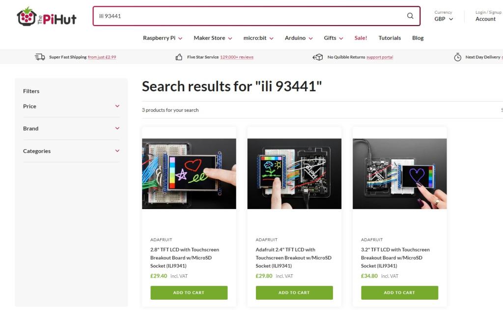

Hmmmm? £15.10 seems ok... if it works ok. Why over clock not work? pi hut... must be ok?
cheers stan
Posts: 2807
Posted: 07:37pm 29 May 2023
nearly ordered one, £3 postage. the display is £8.10. wow ili9341 £24+.

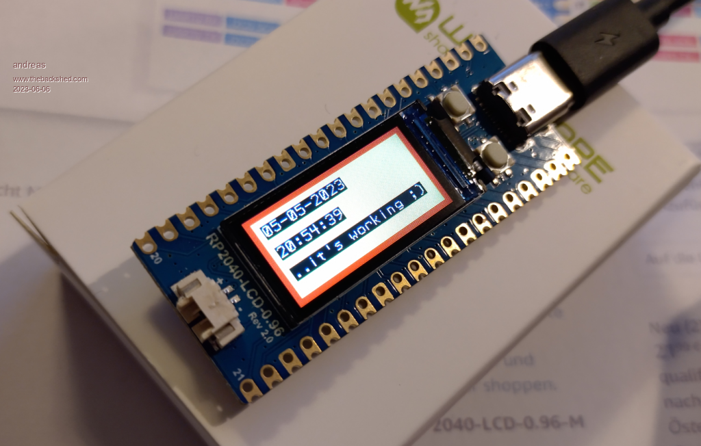

Hello,
the RP2040-LCD-0.96-M  is Picomite compatible
PicoMite MMBasic Version 5.07.07
OPTION COLOURCODE ON
OPTION HEARTBEAT OFF
OPTION DISPLAY 50, 100
OPTION LCDPANEL ST7735S, LANDSCAPE,GP8,GP0,GP9,GP25
(this is out of experimentation, if someone knows a better setup for system spi and lcdpanel I would be very glad to hear!)
Brightness can be tuned by "BACKLIGHT N" N=[0..100]. In the picture backlight is 40%.
> LIST
Box 0,0,160,80,5,RGB(red),RGB(yellow)
Text 10,10,Date$
Text 10,30,Time$
Text 10,50,"..it's working ;)"

Posts: 9030
Posted: 08:02pm 05 Jun 2023
Great to see it working. :)
You've no choice of IO pins for either system SPI or the display IO pins (including GP25) as they are all hard-wired on the module.

yes the pins on the board are fixed, but there is one degree of freedom for the 4th parameter of the OPTION LCDPANEL:
I took GP0 to write anything, but I'm loosing a gp port this way. Thank you by the way for the display type tip - it has shortened my experiments considerably.
