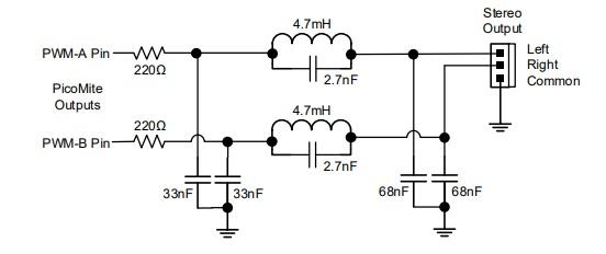

I finally got around to trying out the playing of some WAV files via the PM, and I must say, I am extremely impressed with the new LPF design as in the manual, page 31.
I believe that Volhort had something to do with the design of this filer?
It's really excellent.
Playback of a standard 16-bit 44.1kHz WAV file ripped from an audio CD, the sound quality through a decent set of speakers is audibly so good, I can't actually detect any imperfections in the playback.
Audiophiles will no doubt find it inferior, but for all intents and purposes of audio playback via the PM, it is astoundingly good - right across the entire frequency range.

Hi Grogster,
In essence the picomite has dual PWM (left/right audio) running at 44.1kHz (CD sampling frequency) or lower. The WAV file contains DAC values,and these are send to the PWM (after some scaling for i.e. volume). The PWM acts like a DAC, but it has one drawback. The PWM frequency (i.e. 44kHz) is stronger than the audio in it.
We are lucky that we cannot hear 44kHz, but audio amplifiers can, so there is a filter that removes the 44kHz. It is a very good solution for CD audio.
But ... it will not be perfect in removing other frequencies  (i.e. if you play a 16kHz sampled waveform). In that case the MCP4822 DAC that Peter also prototyped is better.

It's all done by the built-in PWM handlers on the RP2040. There's no DAC. Volhout did indeed design the filters. All versions of them since Geoff's original RC filter.  :)  Getting rid of the 44kHz carrier is non-trivial.

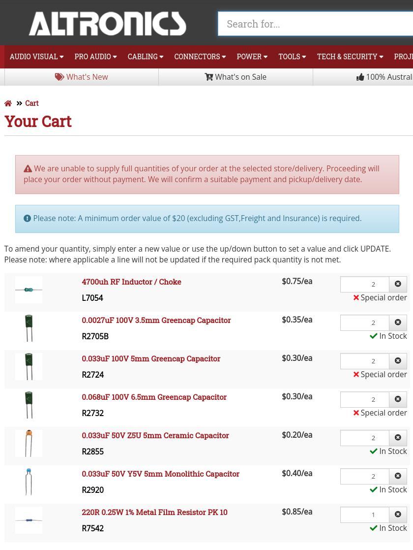

This is good news, as I am also planning to add audio to my Silicon Chip PicoMiteVGA.
Has anyone created a shopping list for the components?
I'm guessing that the resistors are all 1/4W common resistors, and the capacitors are common ceramic capacitors, but I am unsure about the inductors.
Will these ones from Altronics do the job?
Altronics 4.7mH inductor
2.7nF also seems to be less available than other values (2.2nF or 3.3nF).  Probably means an online order, unless these would do the job.
Jaycar 2.7nF Capacitor
Hawk
Altronics shopping list added.  I'm not sure which capacitors are best to use for audio.

Posts: 6169
Posted: 08:31am 31 May 2023
The film capacitors are best, but the ceramics also work fine. I have used both for the 2.7nf. My boards all have film caps for the 33nf and 68nf.

Posted: 10:23am 31 May 2023
  Volhout said  The film capacitors are best, but the ceramics also work fine. I have used both for the 2.7nf. My boards all have film caps for the 33nf and 68nf.
Thanks for that.  Looks like Altronics, which is just down the road from work, don't keep some of the items in stock, so I may have to just bite the bullet and pay for Element 14 or Mouser postage.

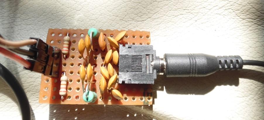

Posts: 2807
Posted: 03:44pm 31 May 2023
I built the non vga circuit but it must have changed to preferred capacitor values. I had to parallel and series the caps I had to get the values.
My circuit was then more un-necessarily complicated.

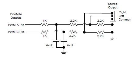

Is this vga manual circuit ok? It's simpler.
Posts: 9194
Posted: 04:03pm 31 May 2023
It will work after a fashion, but the filter isn't as steep and doesn't reduce the 44.1kHz by very much at all. It's nowhere near as good as the inductive version.

Posts: 2807
Posted: 04:49pm 31 May 2023
I had the preferred value caps used but the circuit seems updated since I built it.

Posted: 07:33pm 31 May 2023
  LucV said  I am still using the old version of the filter (the one from the VGA manual stanlyella posted) and I was blown away when I first heard it.
Oh, and no !!
You may not use this idea for the upcoming contest.........
If this is the old version where is the latest version/circuit please?

Posts: 6169
Posted: 03:43am 01 Jun 2023
Hi Grogster,
The inductors you specify are fine. In general you will find leaded inductors in the range of 10-30 ohms internal resistance. These ones are 20 ohms.
note: In the earliest discussions on the filter I designed with different values. With these different values the filter was more critical on parameters, and it would require certain manufacturer/type number with narrow tolerance. Not anymore. The final 4.7mH filter is easier on tolerances.
Posts: 6169
Posted: 04:06am 01 Jun 2023
  stanleyella said  daft idea but can't a wave at the same frequency but opposite phase or in this case inverted be used to cancel the carrier and just leave the audio?
The audio output is PWM when using the filter, and DAC when using the MCP4822 DAC.
To remove the 44kHz from the PWM signal the simplest option is a filter.
More advanced methods can be implemented, but these required significantly more electronics. Alternatively you can use an electronic FIR filter (chip) but that requires you to provide a clock signal.
The inductor filter is simply the simplest solution, not requiring any extra IO pins, is relatively cheap and forgiving.
The filter in the older VGA user manual (and on the earlier VGA picomite designs) is not performing as well, but may be adequate for some applications.
A lot has been said about audio in the picomite threads, it is an continuous discussion item since most forum members have
- different parts in their junk box
- different applications
What I advise to all that want to design their own filter: borrow/rent/take and oscilloscope and measure .... very educative ... Look at the picomite IO pin, and look at the audio signal from (any) filter.
A simple PLAY TONE command will help you. Then set PLAY VOLUME to 0. The remaining signal you see on the scope should be close to nothing....
