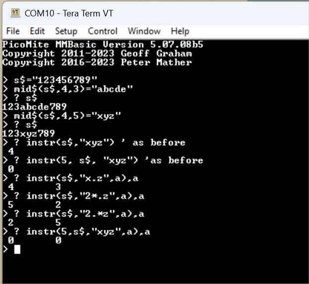

V5.07.08b5
Changes to WebMite as per this thread
Other new functionality.
The MID$ command can now insert a string that is a different length than the selected section
Full, optional implementation of regular expressions in INSTR and LINSTR
INSTR([start],text$, search$ [,size])
LINSTR(text%(),search$ [,start] [,size]
In both cases specifying the size parameter causes the firmware to interpret the search string as a regular expression. The size parameter is a floating point variable that is used by the firmware to return the size of a matching string. If the variable doesn't exist it is created.
e.g.
Other changes:
Fixed bug in MM.INFO(OPTION ANGLE) returns an incorrect value
Fixed minor bugs in CALL and MM.CMDLINE$.
LOAD SPRITE no longer requires exact spacing of the width,number,height fields.
Fixed issue where changing volume when PLAY TONE is playing the same on both channels causes one channel to disappear.
Fixed bug where EXECUTE command does not work at the command prompt
Fixed bug where CLS after NEW when a framebuffer is active can crash system.
Fixed bug where using EXECUTE in a program that has been AUTORUN crashes the system.

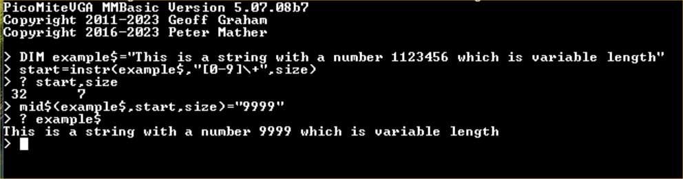

Thanks for the documentation. We will include it in the next manual.
Another good use is to substitute sub-strings in strings using the new flexibility in the MID$ command
e.g.
