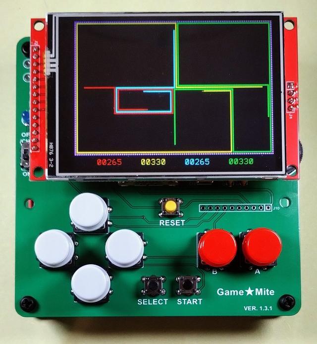

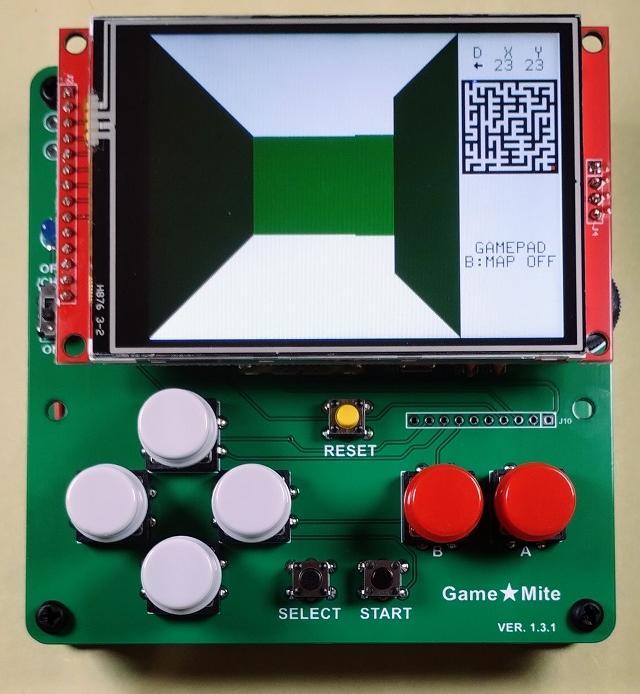

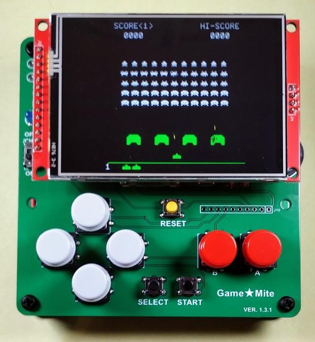

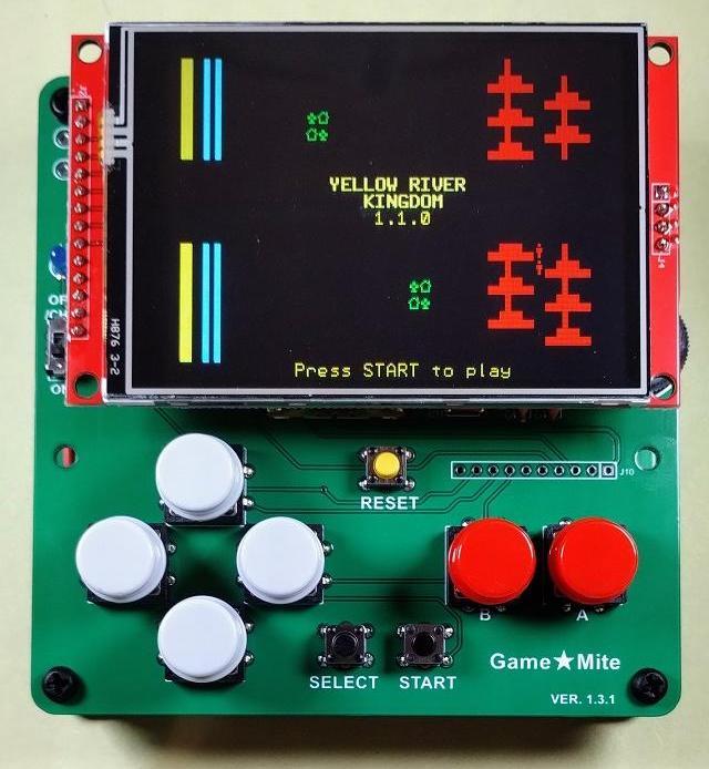

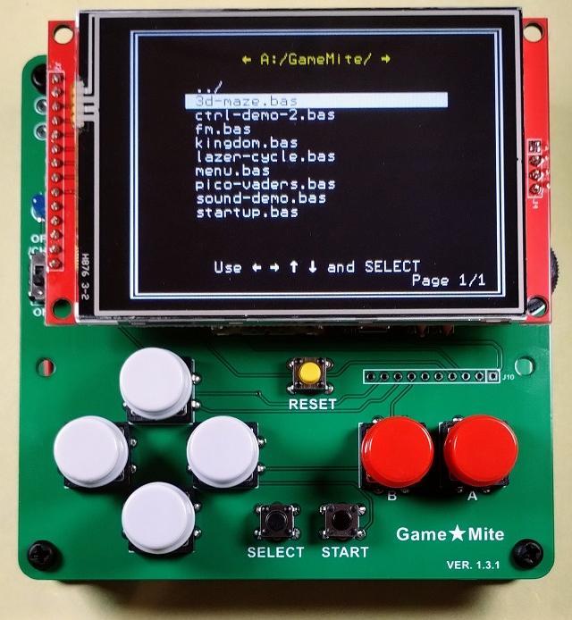

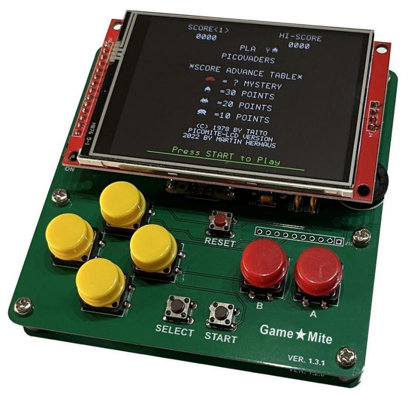

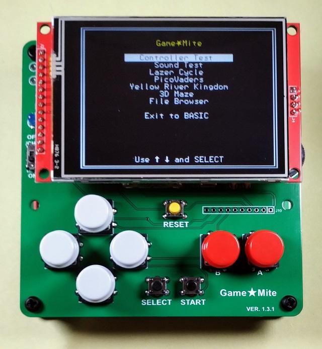

Hey folks,
It's been a journey but I'm pleased to announce the public release of the Game*Mite v1.0.0.
Features:
- Raspberry Pi Pico Microcontroller
- 320x240 ILI9341 SPI TFT display + integrated SD card reader
- NES style game controller (very clicky)
- Mono audio via PWM capable of playing 4 notes simultaneously
- 3v7 LiPo battery with charging and protection circuit
- MMBasic programming language
Links:
   GitHub
   User Manual & Build Instructions
   Gerbers
   Previous thread about the prototype
Acknowledgements:
- Mick Gulovsen (@bigmik) for his many, many hours work on the PCB, writing the early draft of the manual, reviewing the subsequent drafts and all the great advice and friendship.
- Bill McKinley (@Turbo46) for the BOM, reviewing the manual, helping me finally decide on an audio circuit, advice, friendship and keeping me and Mick on the straight and narrow.
- Geoff and Peter without whom all this fun would not be possible; Geoff also reviewed the manual.
- @Martin H, @Mixtel90, @Mozzie, @Volhout and several others here on TBS who helped me when I was wrangling the prototypes.
Apologies to anyone I've forgotten, speak up and take your share of the blame .
How do I get one?
That seems rash, are you sure?
The Game*Mite is all open-source so everyone is welcome to build (and in the unlikely event, sell) them provided the various attributions are kept on the PCBs, User Manual, etc. and the PicoMite/MMBasic license is respected.
For convenience I can sell partial kits (without Pico, TFT or battery) directly to UK shedders at 20 UKP + P&P.
For anyone outside the UK I will have to sell via eBay to deal with taxes and similar red-tape. Unless I find myself making a loss due to additional fees these will still nominally be 20 UKP + P&P but I understand eBay will add destination appropriate taxes, etc. when you get to the checkout so probably not worthwhile.
Please note my kits include the light-grey (not yellow) and red key-caps and four (not six) sets of black nylon (not steel) spacers and screws.
As an alternative for our antipodean members @bigmik will be selling limited kits consisting of the PCB, PAM8302A, TP4056 and the "funny" volume control, I'll let him post separately about price.
Pictures:

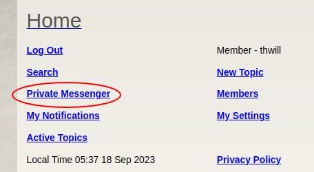

The forum has a "Private Messenger" facility, I'm user "thwill":

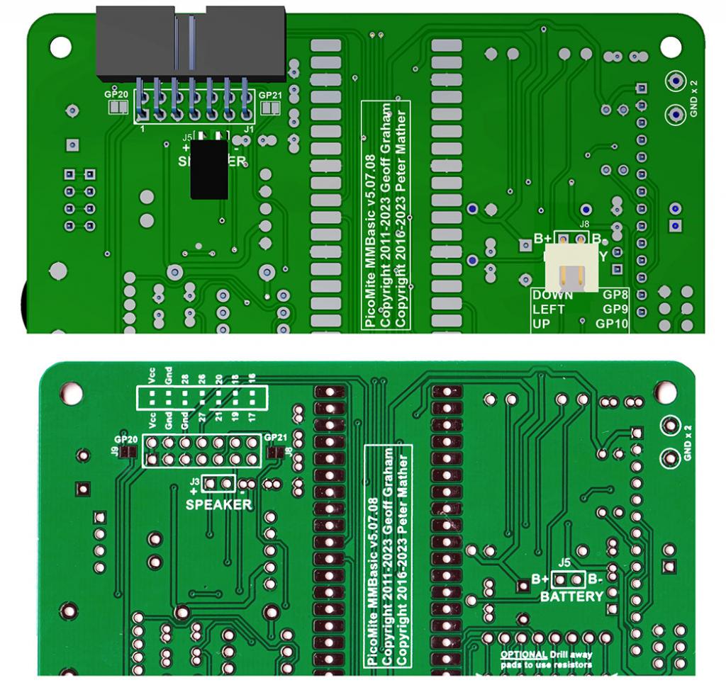

Hi Tom and 'team Game*Mite',
GameMite looks very interesting. Well done!
Lots of comments & suggestions:
- The manual is great - congratulations. Perhaps one might add:
  . a pic of the underside, eg the battery etc?
  . how to access the .bas software, eg for updates, other programs etc.
  . could there be more comment on J1 and how it might be used?
  . rather than 'wasting' a PCB for the base how about a dimensioned pic for a sheet of say acrylic etc?
- is there scope for a clever shedder to come up with a 3D printed enclosure?
- how long does the battery last with the LCD on full power?
- any means of showing battery charge level?
- can the 'BACKLIGHT' command be used to change display brightness?
(I'm thinking of an option to progressively dim the display if no button presses etc.)
- can a WebMite be used instead of the Pico OR as well as? (The LCD could be spaced more). This then makes it a very useful portable controller/monitor.
- I'm thinking of how to add an HC-12 but that might only be of limited use?
- I'd love to fit a 4" LCD!
- Switch S1, for charging, should it be rotated so it is accessible at the edge rather than almost under the LCD? (Maybe a silly idea)?
A great project and I can't wait to get my hands on one.

Posts: 4410
Posted: 11:09am 18 Sep 2023
Hi Andrew,
Thanks for the interest and the questions.
  Andrew_G said  - The manual is great - congratulations. Perhaps one might add:
We will look at adding for the next revision / FAQ, but in the meantime here are some answers:
  Andrew_G said  . a pic of the underside, eg the battery etc?
@bigmik is the master of the photos, I'm sure he will oblige.
  Andrew_G said  . how to access the .bas software, eg for updates, other programs etc.
The Game*Mite is 99.95% a PicoMite so you can connect USB and use a serial terminal or MMEdit as per usual. To get to the MMBasic prompt you need to send a Ctrl-C or select "Exit to BASIC" from the main menu.
  Andrew_G said  . could there be more comment on J1 and how it might be used?
J1 is a 7x2 right-angle boxed male header bringing out all the unused GPIO: GP16-19, GP26-28. There are also solder jumpers to route GP20-21 to this header if you don't need the onboard audio. It also has 3xGND and 2xVCC (3v3), note there isn't 5V anywhere on the board unless being powered by USB. These pins are (I believe) sufficient to allow access to a limited combination of ADC,I2C0,I2C1,RxTx0 or SPI0 (shared with display and SD card). I believe it could be used for the simple DSO code currently being developed y @NPHighview and others and for a 6-channel logic analyser (@Volhout) though in the latter case you have to sacrifice or re-route the audio to other pins. We could have made more I/O available by copying the NES controller design and using a shift-register and additional pull-up resistors with the buttons, but we sacrificed that in the name of reduced complexity / component count.
  Andrew_G said  . rather than 'wasting' a PCB for the base how about a dimensioned pic for a sheet of say acrylic etc?
I'm sure @bigmik can oblige. Though at less than 1 GBP per PCB I'm not sure it's a waste to use one as the backplate, especially since it is printed with useful information about OPTIONS and pin allocation.
  Andrew_G said  - is there scope for a clever shedder to come up with a 3D printed enclosure?
That is up to the "clever shedders" and outside my pay grade.
A prominent constraint in the current design was to try and create something ergonomic that would still fit on a single 100mmx100mm PCB because JLCPCB will fabricate those incredibly cheaply.
However if you wanted to fit a case then you would probably want at least two PCBs:
Bottom: 100mmx100mm containing the top half of the current PCB with the Pico and other modules but in the bottom half instead of having the controller you would mount the speaker, battery and a header (c.f. J10) on which to mount the controller PCB (below).
Top: A 100mmx40mm PCB containing the controller.
This would allow the TFT and buttons to be put in approximately the same horizontal plane making it easier to enclose and provide the necessary cut-outs.
  Andrew_G said  - how long does the battery last with the LCD on full power?
With the volume turned right down the device draws ~100 mA. With the volume cranked up (and sound playing) is draws ~200 mA. You can do the maths yourself with the recommended 1000 mAh battery ... though those are Chinese mAh, so ... I've not had one give up on me yet.
  Andrew_G said  - any means of showing battery charge level?
I'm guessing that has to be done by measuring VSYS (from the battery) and doing some mapping of V vs. remaining charge in software. Does GP29 carry that information (VSYS/3) ?
  Andrew_G said  - can the 'BACKLIGHT' command be used to change display brightness?
Not as the hardware is currently configured. I *think* you could patch one of the unallocated PWM pins to the LED pin on the TFT but I've never tried it. In the absence of an operating system each program would then have to be able to handle this independently or the firmware would need some serious hardware configuration specific titivating to monitor the GPIO allocated to the buttons.
  Andrew_G said  - can a WebMite be used instead of the Pico OR as well as? (The LCD could be spaced more). This then makes it a very useful portable controller/monitor.
I think so, though you might want a version of the WebMite firmware that includes the Game*Mite's modifications, or Peter would have to be persuaded of their general merit.
  Andrew_G said  - I'm thinking of how to add an HC-12 but that might only be of limited use?
I know nothing!
  Andrew_G said  - I'd love to fit a 4" LCD!
Not for the Game*Mite, but perhaps it may serve as inspiration for another device. The Game*Mite uses the ILI9341 because of its ubiquity, low-cost, and also most importantly because its resolution is the same as the PicoMiteVGA which makes porting games between the two platforms easier. I believe the 3.2" is the biggest of the ILI9341 displays.
  Andrew_G said  - Switch S1, for charging, should it be rotated so it is accessible at the edge rather than almost under the LCD? (Maybe a silly idea)?
It looks like you can get similar right-angle DPDT but the PCB might need titivating to fit one.
  Andrew_G said  A great project and I can't wait to get my hands on one.
You know a fellow Aussie who can provide .
Edited 2023-09-19 19:24 by thwill

More on that 'wasted' board
  Andrew_G said  rather than 'wasting' a PCB for the base how about a dimensioned pic for a sheet of say acrylic etc?
  thwill said  I'm sure @bigmik can oblige. Though at less than 1 GBP per PCB I'm not sure it's waste using one as the backplate, especially since it is printed with useful information about OPTIONS and pin allocation.
In the manual, bigmik has described a clever method using the extra board when soldering the male headers used for mounting the modules. The extra board is worth it just for that.

The bottom board could be cut from perspex or ply wood or other suitable material and thus save a PCB but the truth is that I (and no doubt Tom) have quite a few spare, blank PCBs from previous revisions (that are fully functional as they are all minor changes such as moving the switches lower and changing the name from Bintendo Tomboy to Game★Mite) so these are more than suitable and IMHO would look better than a blank baseboard and don't need any cutting to make work.
As to a 3D printed case, well, maybe someone will do that but I think the size and feel as it is, is perfect, adding a case would make it more awkward and cumbersome to use, however if someone does come up with a case that can only be an improvement to possible options.
Also the expansion header has the text for the Pin out under where the header sits (as there was no other suitable place to fit that text) and by using a 2nd PCB that text is visible as shown in this mockup.
