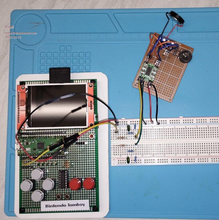

I'm working on the audio for the Mk2 using a PAM8403 and have two questions:
1. Where do I put the variable resistor / volume control?
   a. Between the Pico and filter
   b. Between the filter and amp
   c. Between the amp and speaker
My guess would be (c)
2. This really only needs mono sound, can I just leave the "right" input and output of the PAM8403 flapping in the wind or do they need grounding (or something else).

Posted: 01:04am 15 Mar 2023
A volume control pot normally goes before the amplifier. See this  for an example.
Putting it between the amplifier and the speaker would have the amplifier operating at full power continuously and the volume control pot would have to handle the full power output of the amplifier. Not good.
I would ground the spare input via a 10k resistor.

Posted: 04:23am 16 Mar 2023
Regarding the spare amplifier, I have no experience with digital amplifiers but I do seem to recall that some analogue amplifiers could be unstable if a load was not connected. Maybe connect a (say) 100 ohm resistor across the speaker terminals as a precaution. Wattage shouldn't matter.
Bill
Posts: 4412
Posted: 07:46am 16 Mar 2023
Thanks Bill, my first tests with the PAM8403 were not successful, lots of distortion, noise and clicking, probably not helped by it all being lashed together by jumper leads and breadboard. I need to spend some more time on it.

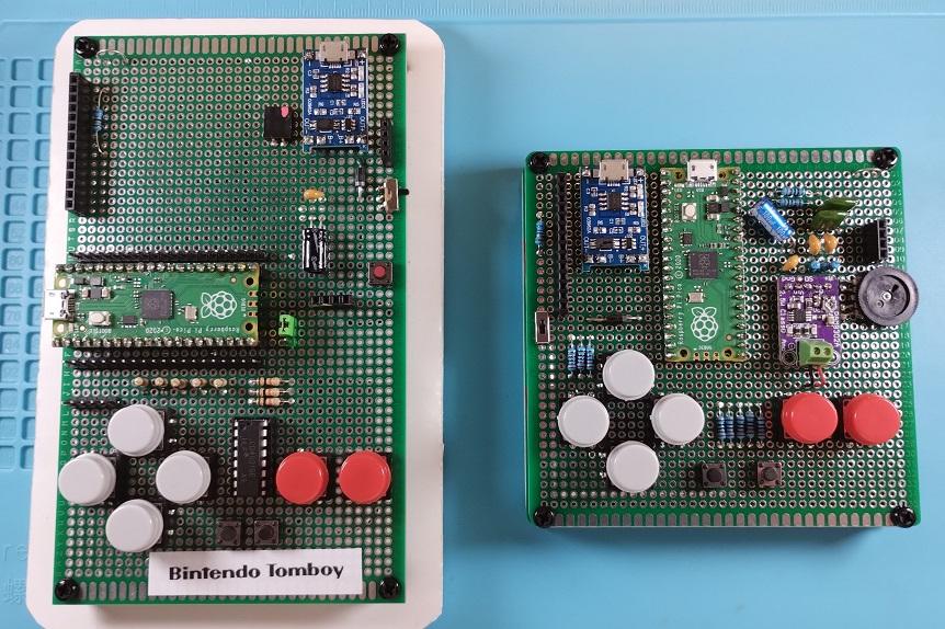

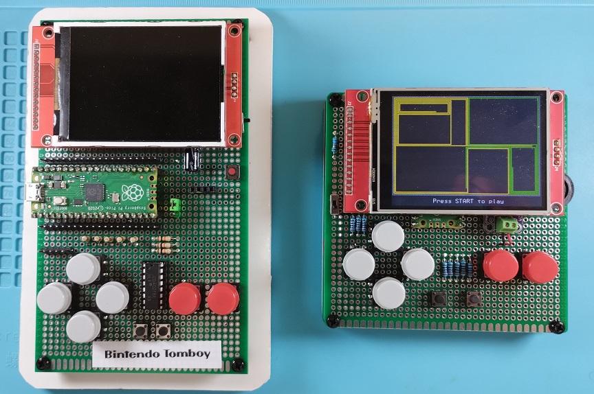

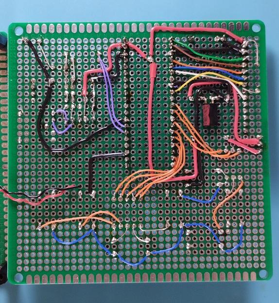

Hi folks,
I've still got a little titivating to do (wire up SD card, touch, reset button) but the Mk2 prototype is up and running, many thanks to everyone who advised me on the audio side and to Peter for the firmware changes to PLAY SOUND:
   https://www.youtube.com/watch?v=7Is_RnQhM64
Here are some pictures with its older, bigger brother:
Posts: 2807

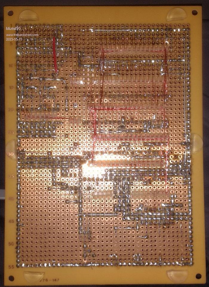

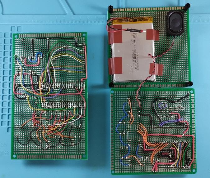

Posted: 02:50pm 14 May 2023
Looks tidy from the top... er.. each to their own with wiring, don't they make a wire wrap tool for these boards?

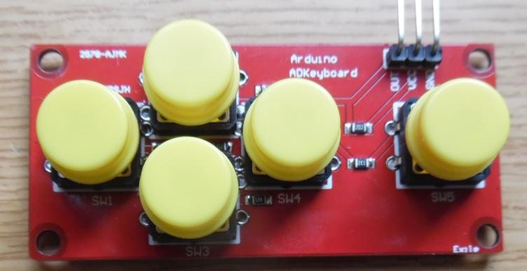

My 5 switch "analaogue" boards arrived. Must test but working on mcp23017 i2c port expander which is working ok with code from phil99.
Posts: 4412
Posted: 02:57pm 14 May 2023
  stanleyella said  Looks tidy from the top... er.. each to their own with wiring, don't they make a wire wrap tool for these boards?
I did look at other techniques a couple of years ago. Wire-wrap pins are pretty expensive and I very much doubt I would be able to hack prototypes together, or pull them apart quite so quickly if I was using wire-wrapping. I quite liked the sound of using a wiring pencil with solderable enamel wire, but all I have ever managed to create with that is a burnt mess, not sure if that was because the wire was not as advertised or because I was incompetent. I've settled on the pictured as an adequate protoypting technique within my capabilities, if I need anything more then I'll be learning to make PCBs.
EDIT: as to veroboard, of which I do have a big slab, I found it to be inflexible when prototyping on the fly (i.e. you need to do more up-front layout), and even if you do that planning, you require more real-estate because of the fixed tracking.
Edited 2023-05-15 01:02 by thwill

Using invisible touch area for u,d,l,r isn't perfect hence the button board.

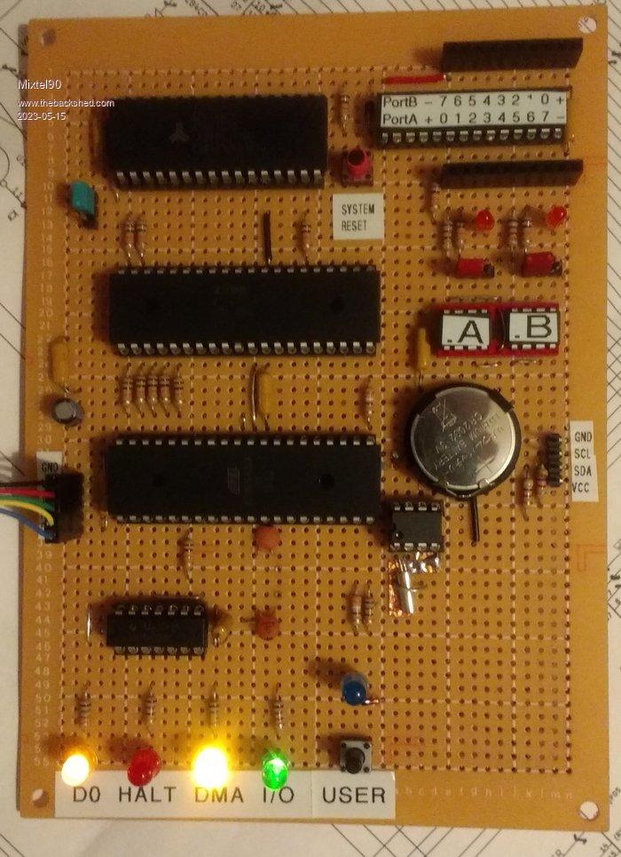

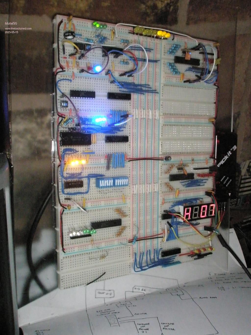

Posts: 9407
Posted: 03:40pm 14 May 2023
I did a CP/M computer using a wiring pencil.
And a special computer just for Stan. Well, it's just about a computer. More of a CPU really. I replaced chunks of logic with PIC chips (but they only work as multiple logic gates) to keep the breadboard size down to something manageable. It's a bit underpowered for Tom's project, unfortunately.

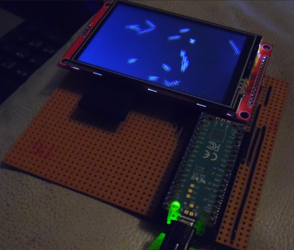

Posts: 2807
Posted: 02:39pm 15 May 2023
Hi lizby. imho the ili9341 using mmbasic is not "slow". "Missile command" is just the
Bresenham's line algorithm but pixel at a time and the explosions using circles I've done before.
I worked in an arcade games factory in the 70's and there was a run of atari missile command machines. think they used 6502 and a raster scan crt not x-y monitor like asteroids and battle zone.
The tracker ball was new but just 2 ir led and sensor with slotted discs driven by the ball. Before ball ps2 mice.
It would work nice with a touch screen as an alternative to buttons/joypad.
