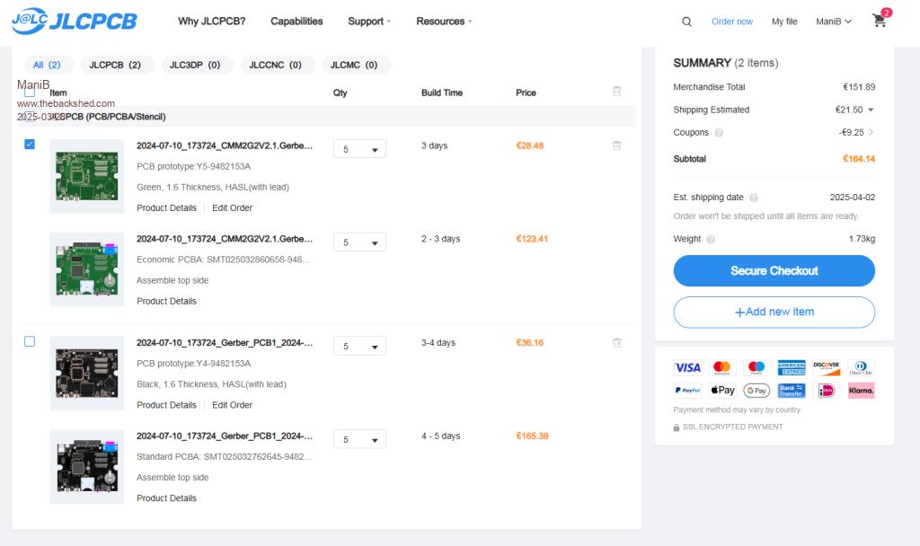

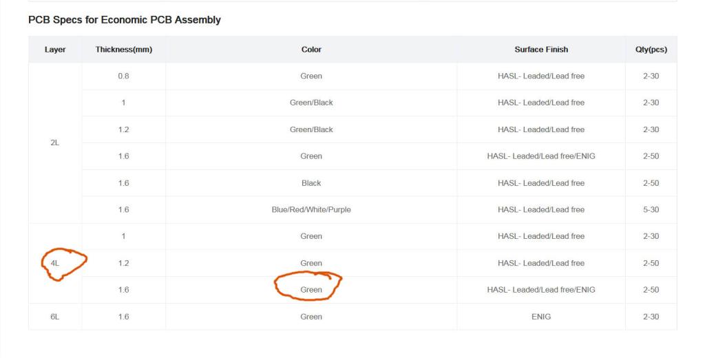

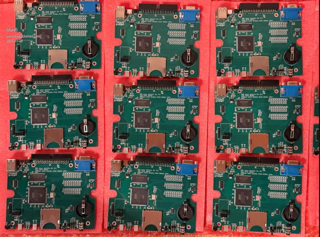

The CMM2 G2 V2 is designed to be much cheaper to manufacture than all previous designs. JLC can build it ready-to-run for about £133 for 5 boards (+, of course, shipping and any local taxes). It is functionally identical to the previous versions with the exception that it does not support the Hobbytronic USB mouse I/F chip. PS2 mice are still widely available and plug directly into the bottom USB socket (USB keyboard in the top). As before the Microsoft Basic Optical Mouse is highly recommended and both the V1.1A and V2.0 versions work well the the CMM2.

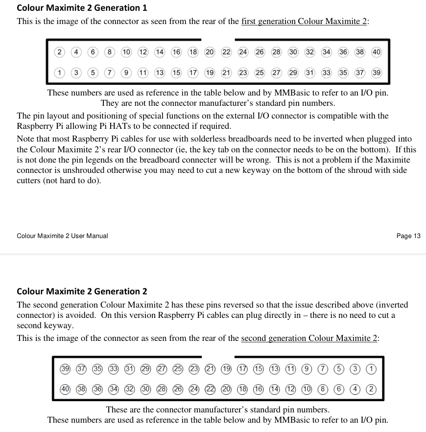

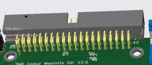

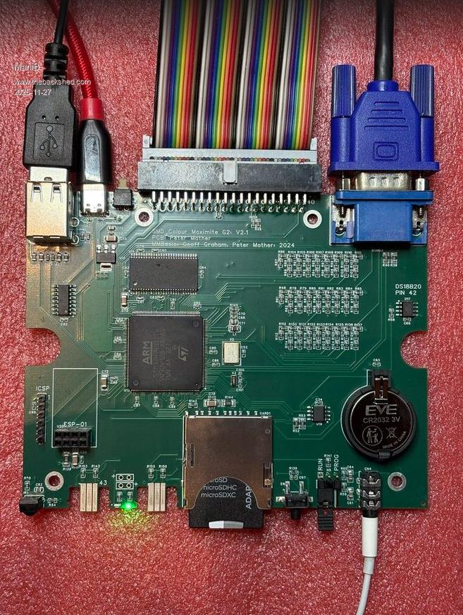

My CMM2G2V2 board has also arrived and is working perfectly. The Microsoft mouse also works perfectly. The picture is razor sharp. The system only hangs (frozen, have to reset) from time to time with subdirectories of my SD-card (which works in the old G1). I still have to test it with other SD cards.
I have only noticed that the I/O pin assignment corresponds to the CMM G1 again. The 180 degree rotation of the G2 is no longer necessary.
But the PIN-numbers are switched. Pin1 is now Pin 40 in schematic. How to set the Pin now? With the old system?

I just got my oder from JLCPCB.
I programmed it with the latest firmware V5.07.02b11.
All five boards are working. The packageing from JLCPCB was a bit cheaper than for my first order last year, but the boards are ship shape and bristol fashion. Nothing to complain here.
The first startup of the board was sometimes quite rough. Multiple resets were necessary.

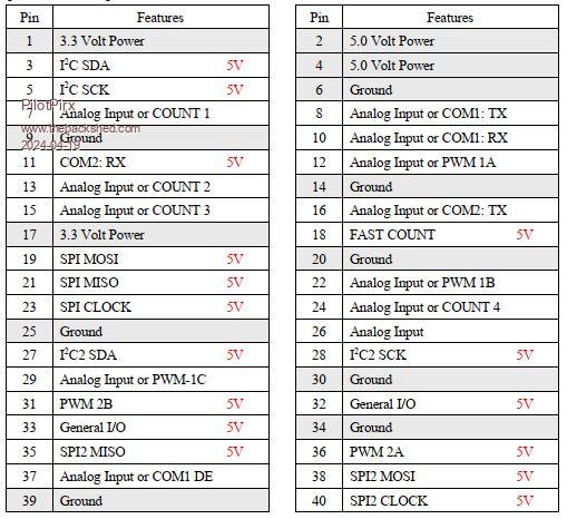

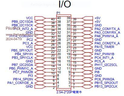

PilotPirx
Joined: 03/11/2020
Posts: 138
Posted: 07:41am 19 Apr 2024
The pin assignment is not as printed on the board. If you look on the back, pin 40 is upper right (where the arrow is)and pin 1 is down left. I measured this with a voltmeter- its like first Gen CMM2. But the print on the board is vice versa.
And Pin40 in the schematic was previously Pin 1.
Here the new pinning
and here the old one:
same functions, but pin numbers switched
Edited 2024-04-19 18:02 by PilotPirx

  PilotPirx said  The pin assignment is not as printed on the board. If you look on the back, pin 40 is upper right (where the arrow is)and pin 1 is down left. I measured this with a voltmeter- its like first Gen CMM2. But the print on the board is vice versa.
@peter: Can you clarify this?
I am now totally confused.
Since I have the CMM2 Gen2 as V1.5, a new change would bother me now :-(
I'm also thinking about getting one of the new boards from Matthias (@matthias: I'll get back to you after I hear back here).
Matthias
Posts: 11867
Posted: 09:29am 20 Apr 2024
Sorry about the confusion. The boards made from the gerbers published on this thread should have the same pinout as the 1.5 G2
The two G2V2 development boards sold to PilotPirx and stoke_ferry had the G1 pinout as a result of me copying the wrong layout. I had forgotten I made this change between the prototype G2V2 and the final version as above and should have communicated this to the two recipients

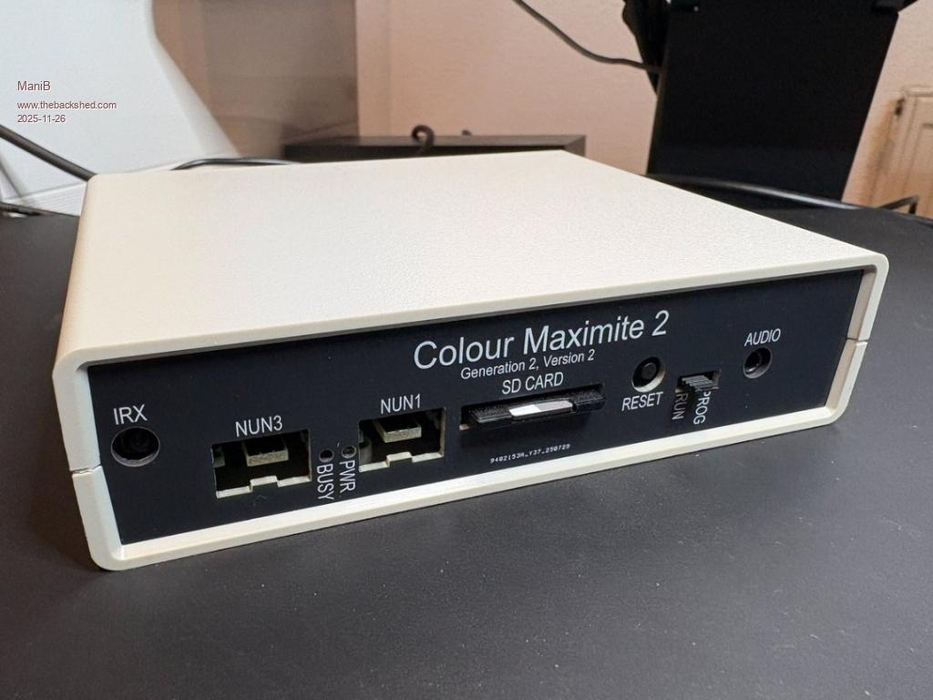

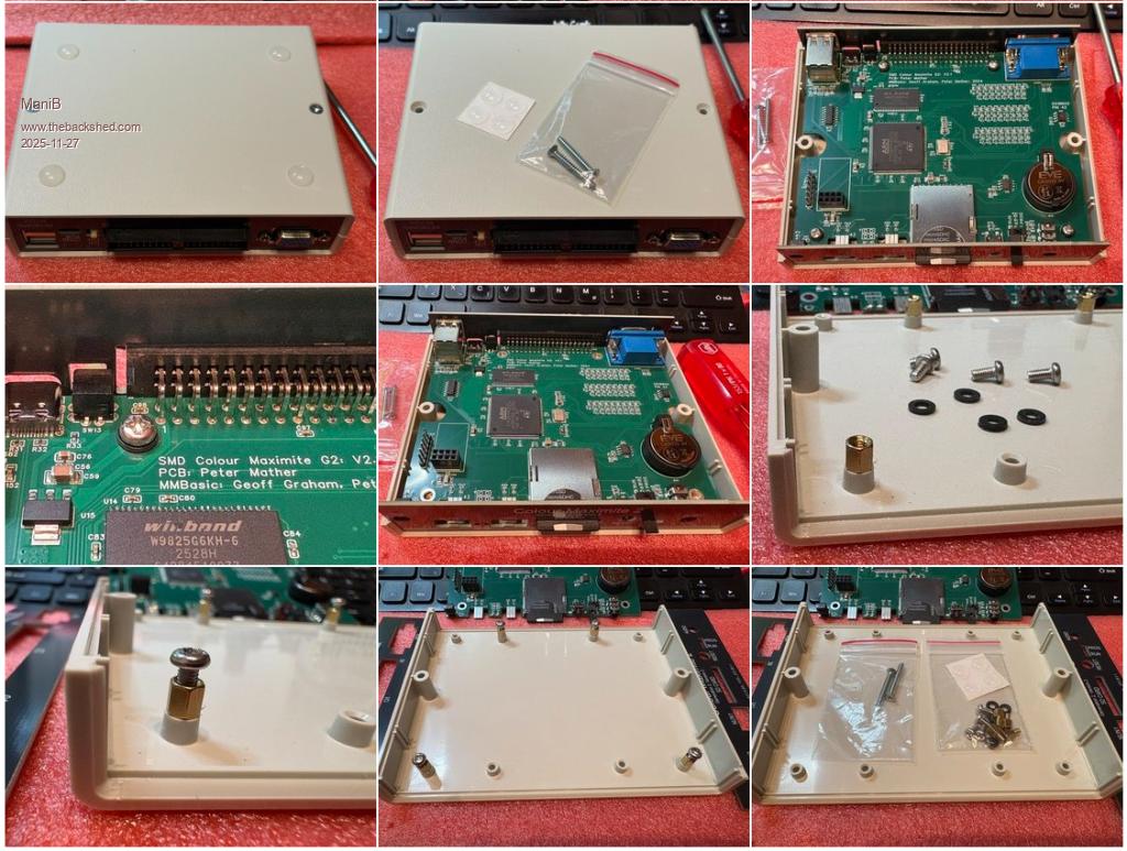

Another question about the CMM2 enclosures.
Where can you buy them in Europe? I only found one source in Australia. But shipping is too expensive for me.
Do you have 3D print files for them?
Kind regards
Matthias
Posts: 11867
Posted: 12:57pm 20 Apr 2024
Its a very standard box G738. Try de.farnell.com part 1526699 or 1094711

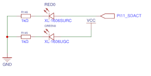

I have a question to the Status LEDs.
I currently try to integrate the CMM2 in a nice retro housing and the last step is to adapt the LEDs to the new housing. But I have problems to access the Drive LED control signal. I found these connection points in the board, but they are connected between the LED and the resistor to GND, so I get only signal too small for my circuit. I need at least TTL levels.
What are these connection points for?
They are not mentioned in the schematics
I need to connect to the positive pin of the Drive LED but it is a very small spot and close to the board edge and the Nunchuk. Not the most ideal place to solder a cable to.
If I bridge the LED, will the port be able to handle the increased current?
Any advice is appreciated.
Best Regards
 Matthias
Posts: 9134
Posted: 07:49pm 04 May 2024
I'm not sure of the CMM2, but I doubt if the LED signals are at 5V anyway, so not TTL level. They are more likely to be 3V3. I can't open the schematic at the moment to check.
