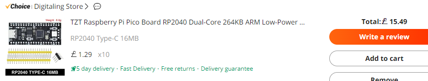

Posted: 02:51am 30 Jun 2024
Just received:

Posted: 07:59am 30 Jun 2024
MMBasic runs beautifully on all the Chinese clone boards that I've tried so far, including the lovely little RP2040-Zero, which has become one of my favourites. :)
To use pins that are normally reserved by MMBasic (e.g. GP23 and GP29) use OPTION PICO OFF then you can use them for anything that the RP2040 Datasheet specifies.
The module shown by PhenixRising looks like the YD-RP2040 under another name. This may not run at over 252MHz but that's fine for VGA. I have a few of them and they are great. :)

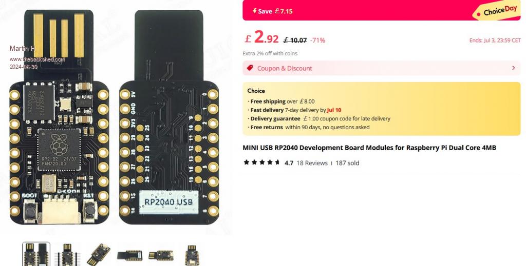

Posted: 08:22am 30 Jun 2024
  Mixtel90 said  MMBasic runs beautifully on all the Chinese clone boards that I've tried so far, including the lovely little RP2040-Zero, which has become one of my favourites. :)
This would be a nice Choise:
I'm thinking about ordering a few and running my 3D MonsterMaze version for VT100 there :-) so as "Monster on a Sick"
Have a nice Sunday
Martin

Posted: 10:24am 30 Jun 2024
That's one that *might* not be fully compatible. It depends on what they did with the USB. A schematic is needed.

Posted: 02:00pm 30 Jun 2024
Hi Mick, this is my second batch of 10. No problems with 378MHz
I believe that I also successfully tested 420MHz.

Posted: 02:51pm 30 Jun 2024
Perhaps they've finally run out of the cheap and slower flash chips. :)

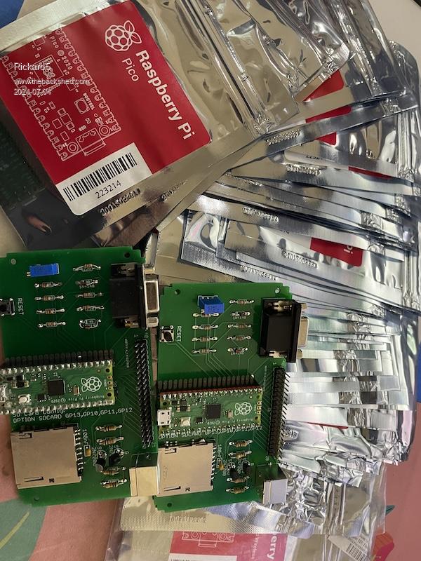

Posted: 03:22pm 03 Jul 2024
@ Mick,
Not to Gloat or Nothing but when the Pi Pico first came out Microcenter had them for $2 Limit 2, So I'd go in every morning on the way to a client's and get my limit 2. then at lunch I'd walk across the parking lot and get my Limit 2, then on the way home I'd Stop and get my limit 2. and when they were out I'd get my Rainchecks. Then low and behold I go in one day and pay $5 each still limit 2, but I notice they must have just got a shipment in and I got like 80 something Rainchecks, so by the time all was Said and done I collected more than 150 of them and I've used tons of them ;) and the PFY (pimply Faced Youth) tried to tell me I can't do that, but the Microcenter Mgr. Knows me from the DOA Laptop incident, that ended up costing them! so I got my picos in one shot  I also did this same thing with Pi 0 and Pi 0W when they first came out.:)

Posted: 04:13pm 03 Jul 2024
Worra lorra Picos. lol
I haven't got many in actual projects. Almost all of them are plugged into various experimental systems and get re-used. I have a mix of genuine ones, YD-RP2040 and RP2040-Zero though, and I've just ordered some more of the latter from AE.
