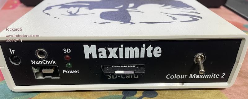

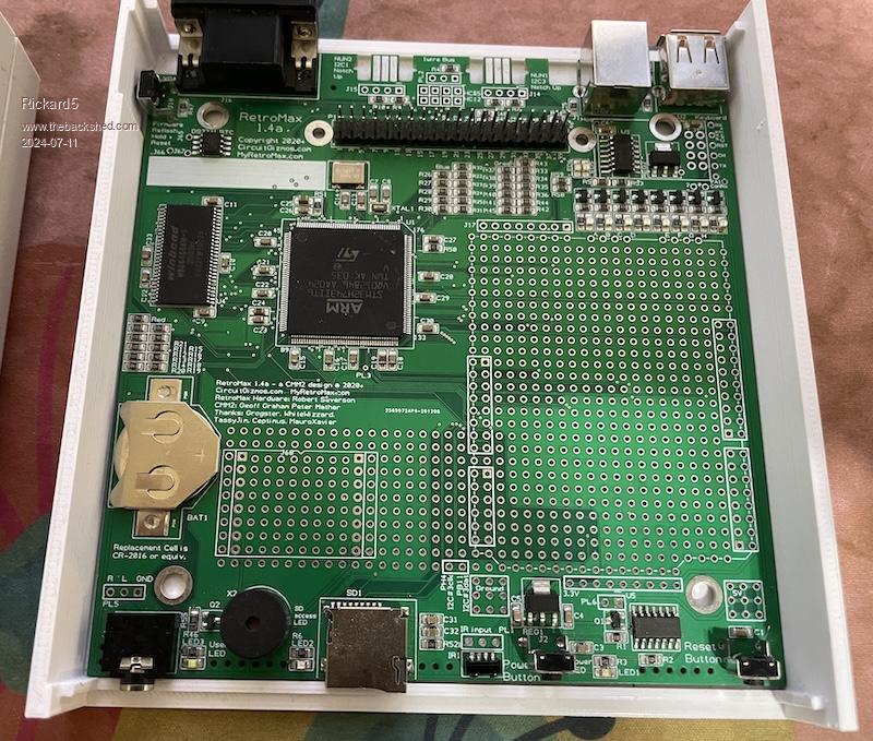

I was Reading another CMM2 post and there were Port Maps (I don't know the proper name) for CMM2s that look nothing like the 2 I have, I love my CMMs so much I'm scared to fiddle with GPIO Port. That's why I love the Picomites worst thing I can do is blow up $2  that I have 150 of them. My CMMs have the PIN numbers labeled but not defined, how can I find the right pin definition for each one?
Posts: 9036
Posted: 09:07pm 10 Jul 2024

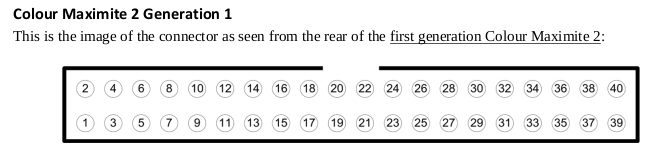

It's very much like the PicoMite but the pin numbers are different - you use SETPIN to configure what you want a pin to do. The various options are shown in the manual.
The layout of the GPIO port is also shown in the manual (get the right one for your CMM2 version). AFAIK the RetroMax will follow the same layout, but you will need the manual for that to be sure. The diagram shows what you can configure pins for, but they can be standard digital IO pins.

Posts: 3351
Posted: 01:40am 11 Jul 2024
Try https://geoffg.net/maximite.html , the downloads are at the bottom of the page.

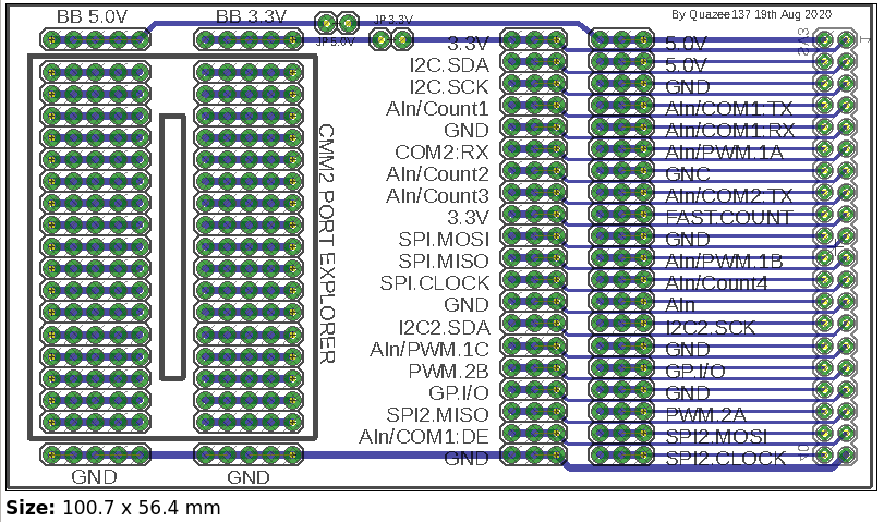

Rickard5
A while back I made this for a school TBS
I have more if you want one. I think I may have the full kits.

Hi Quazee137,
For what version of the CMM2 are these. I seem to remeber that the original connector (on the CMM2G1) was upside down. And that was changed at the CMM2G2. And if recall right, the latest incarnation CMM2G2V2 is back to G1 pinout.
I guess this is made in the high days of the CMM2, so for the G1..??

Volhout Yes it is for CMM2G1. I also used it on a RPi Zero

I bought one of Quazee's cmm2 breadboards 4 years ago. Worked perfectly. Very Useful.
Also useful have been bigmik's CMM2 header breakout boards: (Big) Mick's CMM2 Breakout PCBs

Sadly its going away. It works great for many projects that use the
 RPi 40 pin buss.
 last chance :(
 I have used around 25 of these for my MM170 Hatstand based controllers making
  use of a few RPi hats and my own pcbs.
