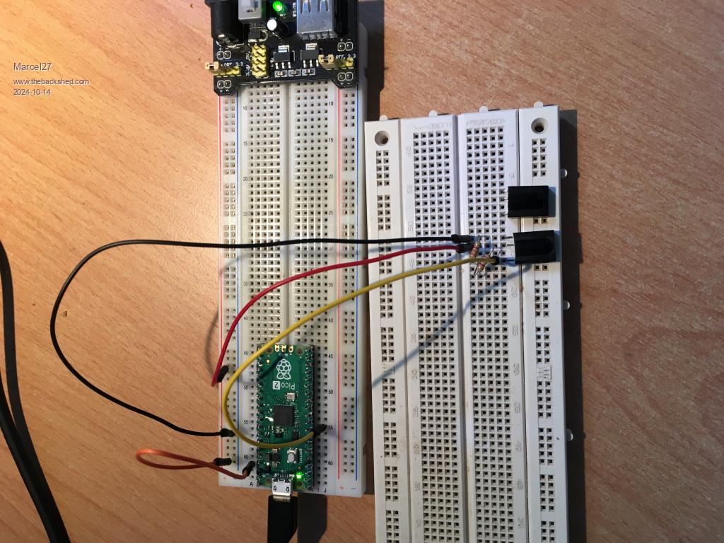

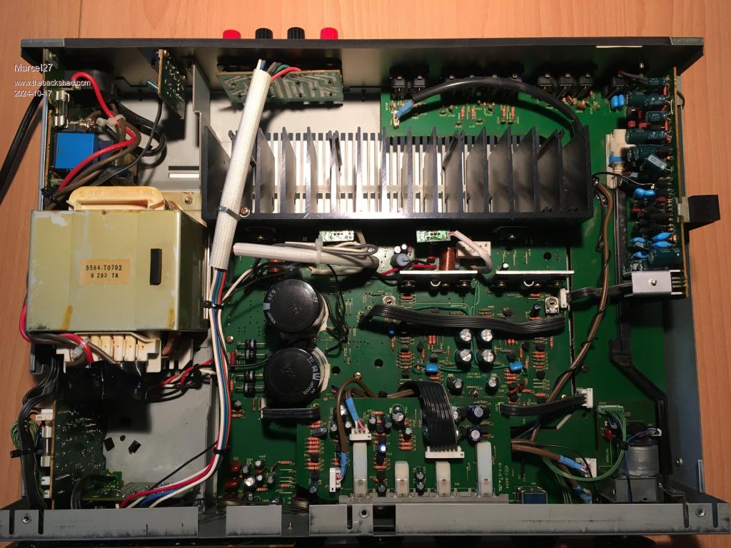

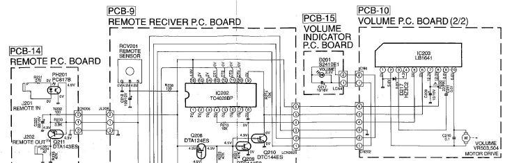

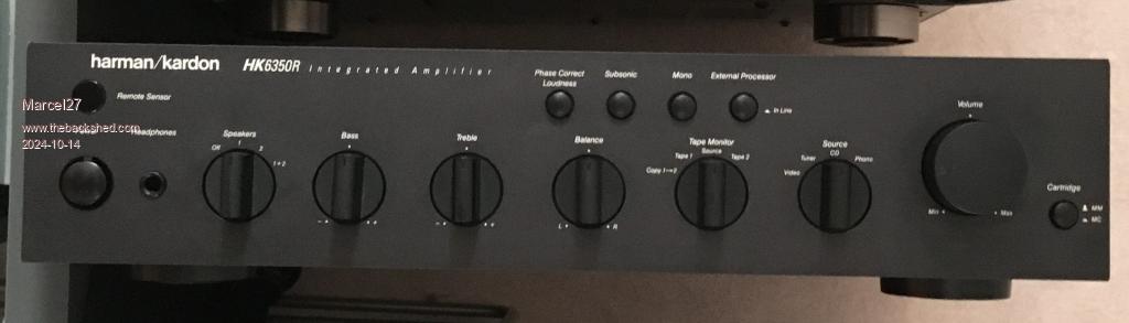

I have a beautiful vintage amplifier, HK6350R, without a remote.
The device had some strange problems, the volume runs high or low at random or dropped random in standby mode. The problem was the M50761 processor IC201. After I removed this chip everything worked normal albeit without remote control.
I built the example in the MMBasic manual with an infrared receiver and the simple program example. I had to add 2 resistors of 3k3 and 2k2 because the receiver is fed with 5V. But the first test went smoothly.
edit
SetPin GP6, IR
Dim INTEGER DevCode, KeyCode
IR DevCode, KeyCode, IRInt
 'body
Sub IRInt
 Print "Received device = " DevCode ", key = " KeyCode
End Sub
ESC:Exit  F1:Save  F2:Run  F3:Find  F4:Mark  F5:Paste
Below you can see the results of the test, volume +, volume -, Power On and Power Off.

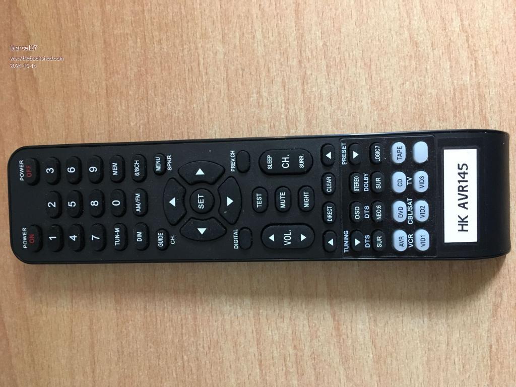

'Test with TFMS 5360 IR receiver 5V type and Harman Kardon substitue remote HK AVR145
Received device =  270, key =  227  'volume up
Received device =  270, key =  19   'volume down
Received device =  270, key =  3    'power on
Received device =  270, key =  249  'power off
The next step is to set up an IR transmitter with a 2nd PICO and check if the communication can be emulated from the HK-remote. If that works, the next step is to modify the program so that it can be embedded in the HK6350R electronics.
To be continued

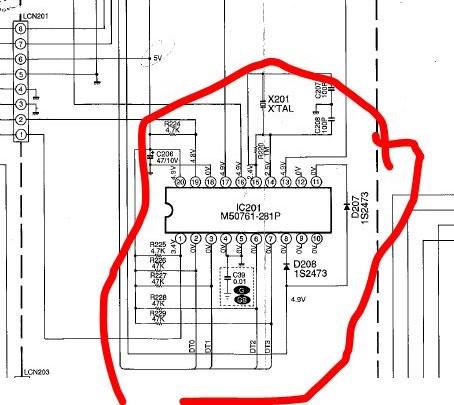

The next thing that needs to be done is to look at the operation of the TC4028 and the LB1641. The first is a BCD to decimal decoder and the second is a bi-directional motor control.
The motor control has its input on pins 5 (IN1) and 6 (IN2) and has a switching point of 1.5V. Everything above 2 V is High. Both pins H or L is the brake. In fact, they can be controlled directly bythe Pico if the BCD-dec decoder is bypassed in the new circuit. However the situation around the TC4028 must first be investigated. There are still a few loose transistors included in the circuit.
IMOH, it's all designed in a very cumbersome way, I think the BCD-dec decoder could have been omitted and the motor control could have been controlled directly from the processor. They're going to make things difficult by toggling between (ABCD inputs) -> (Dec output) HHHL and LLLH to make Q7 or Q8 high. They could have used just 2 pins on the processor voor Q7, Q8 (up/down). Of course it's also possible that I'm missing something, that happens more often. This is my quick conclusion.

Some thoughts on using a Pico for this.
As noted above, it would be easiest to replace both IC201, IC202 and associated transistors with the PicoMite.

The upshot of the story is that I agree with you to remove the ICs and transistors in the circuit or at least cut the printed circuit traces to disabled the BDC-dec function and get bare access to the LB1641 motordriver IC.

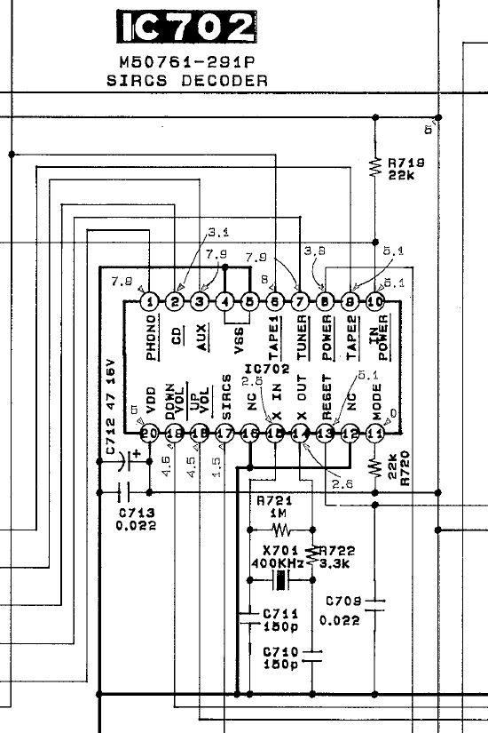

I looked at some other information of a Sony TAF319R unit. There they use the same processor M50761-291P, but it has a complete different function, different firmware. The device IC201 might be a SIRCS decoder with NEC protocol firmware?

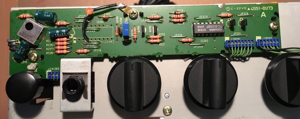

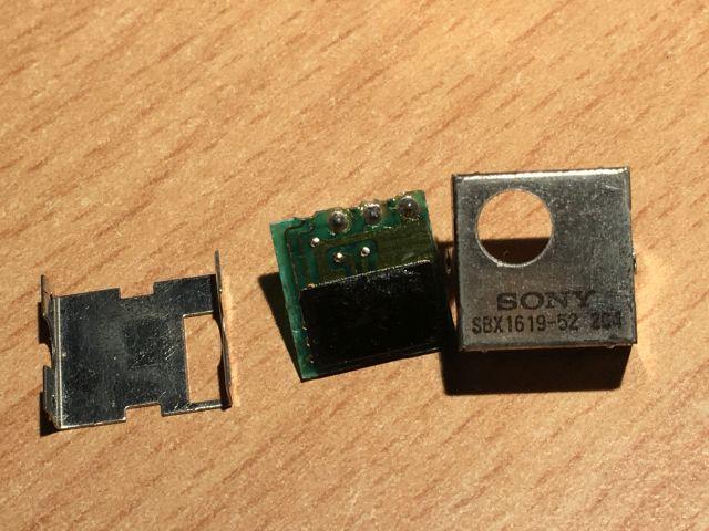

The Sony infrared sensor is a SBX1619-52 with TTL level output. The transistors on the right side are Q209, Q210.
The transistors Q206, Q208 and IC202 will be removed. The two transistors Q209 and Q210 will be reused as level translators for the control of the LB1641. I have to test how these transistors behave when they are driven by the Pico with 3.3V. When the amplifier is switched on in the normal usage situation, pins 4 and 11 of IC202 are low. In the new situation, these are connected to 5V and R213 and R214 serve as pull-up resistors. LB1641 is on brake when both inputs are low or high.
When IC201 pin 1 is connected to ground, the system goes into standby. In normal operation, there is 3.4V on this pin. I have to check whether this can be solved with a voltage divider or whether a transistor must be used, for example Q208 when the amplifier is switched.

Edit: corrected some typos and added amp photo.
It is a nice amp and it had some problems when I bought it. It was repaired by another repair guy but it had still the random remote issues and some problem with the bias current of one channel. The guy had "repaired" some bad soldering joints but introduced by that a shortage. Fortunately not a severe shortage but you could hear the distortion in one channel and the bias current was fixed at 0 mA. It took me 1 hour to disassemble the mainboard because of the many soldering connections and more time to find the tiny shortage. This amp is far from service friendly built but the sound is goooooood!

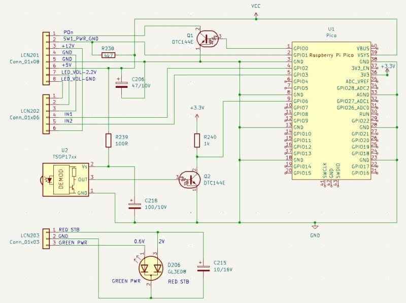

Thought about your remark. I removed all unnecessary components from the PCB. Everything still works as it should and drew a schematic of the remaining components. Still have to test it in real live.

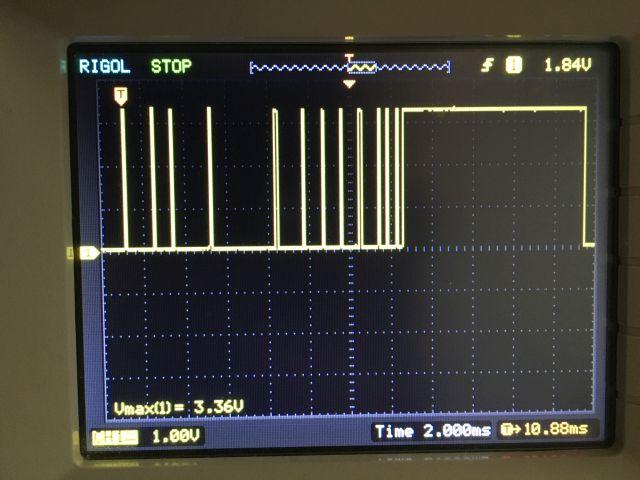

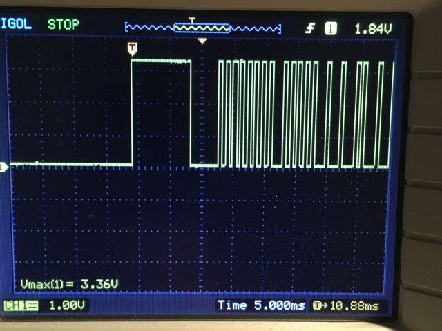

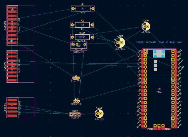

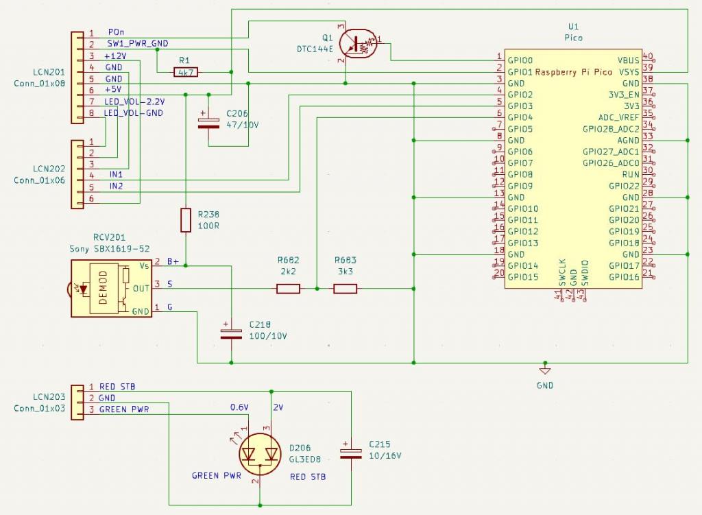

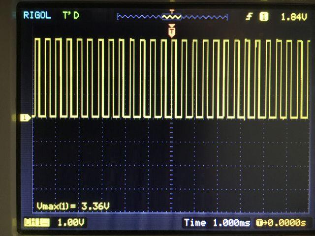

Posted: 04:02pm 30 Oct 2024
I built the circuit as indicated in the KiCad schema but it did not work. I read somewhere on the net that these Sony sensors sometimes gave problems due to the presence of dried out capacitors, so I dismantled the sensor. There appeared to be no capacitors in it. I wanted to know the details and made a simple circuit to measured the sensor with an oscilloscope. It appeared that the sensor did work, but that there was a square wave on the output. After I had modified the circuit with a DTC144E (level shifter) transistor and had offered the signal to the Pico, the signal was converted. The Sony sensor does work but to a certain extent. PON and POF buttons were not read by the Sony. Values ​​did come through but not all buttons were read correctly. With another sensor, for example the HRM36002P, which looks like a TSOP1738, all buttons were read. I am not stuck with the original Sony sensor and therefore choose the sensor that gives the best result.
The square wave at the output of the Sony SBX1619-52.
Signal from the Sony sensor.
Signal from the HRM36002P sensor.
The Sony sensor.
Next step is changing the KiCad drawing.
Posts: 9283
Posted: 04:28pm 30 Oct 2024
It's probably 38kHz modulated IR. Some receivers decode this and output a simple TTL signal. Others are basically a IR diode with an amplifier and leave the decoding to external circuitry.
