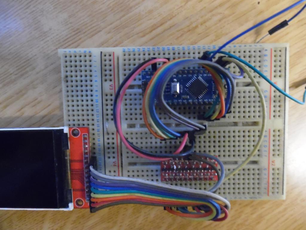

Posts: 2807
Posted: 05:19pm 22 Oct 2024
I used 8 channel bi-direction level inverter with arduino and ili9341 as arduino 5v logic and ili 3.3v
their cheap and should be ok to raise 3.3v logic to 5v

Posts: 2807
Posted: 02:55pm 23 Oct 2024
  Plasmamac said  Thx for all ,
@stanleyella link please
bought years ago, something like this. 8 fets, marked LV and HV, LV is 3.3 device, HV is 5V device
https://www.ebay.co.uk/itm/192441573509
