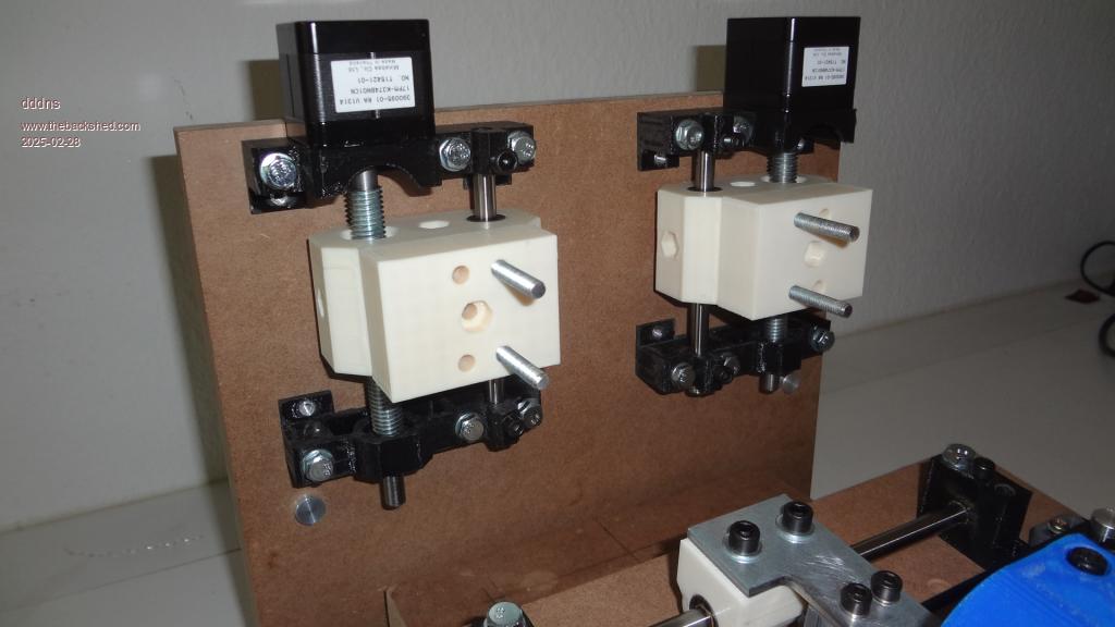

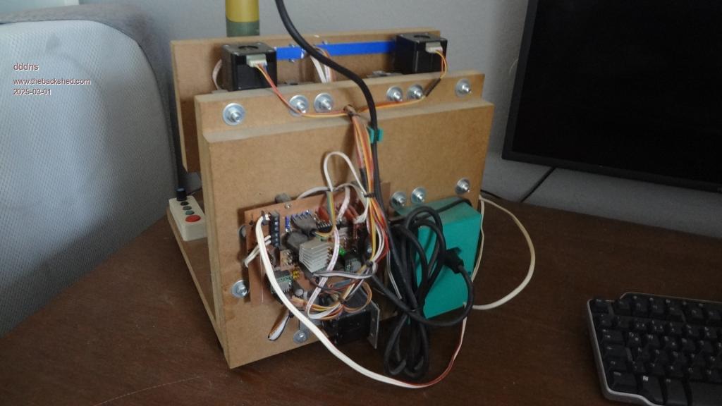

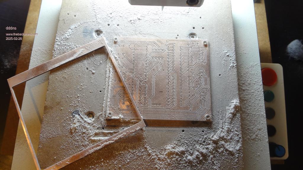

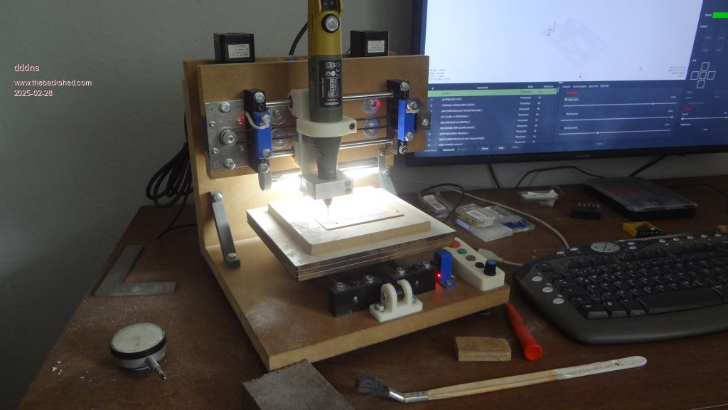

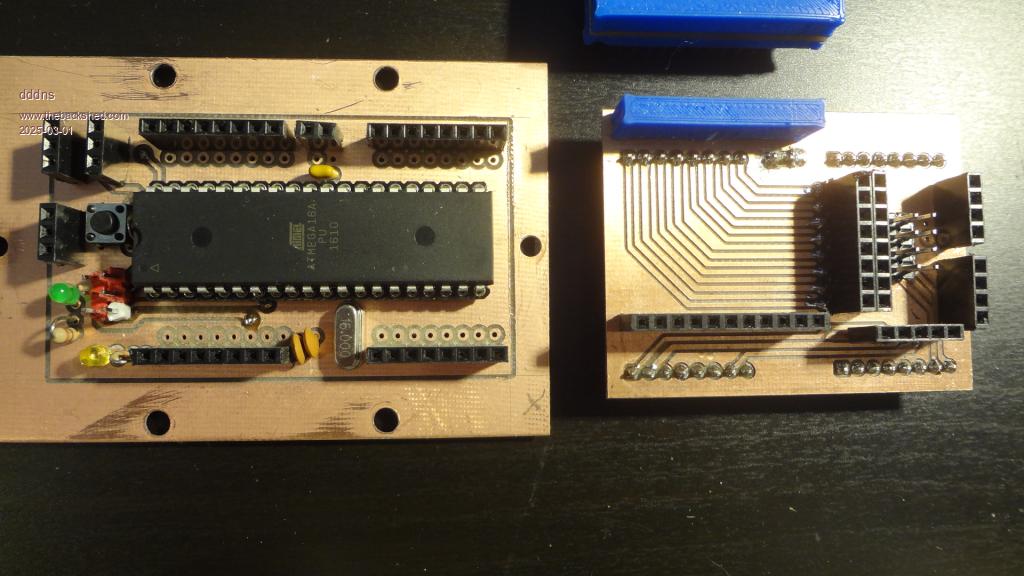

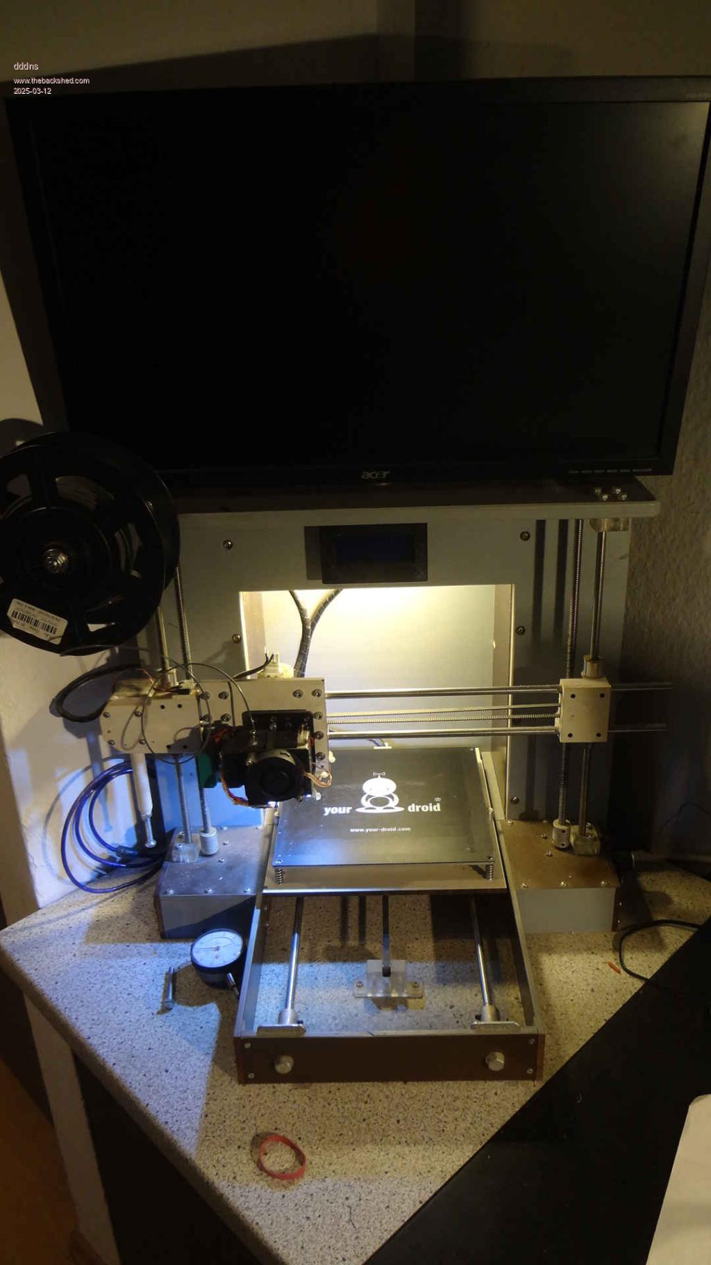

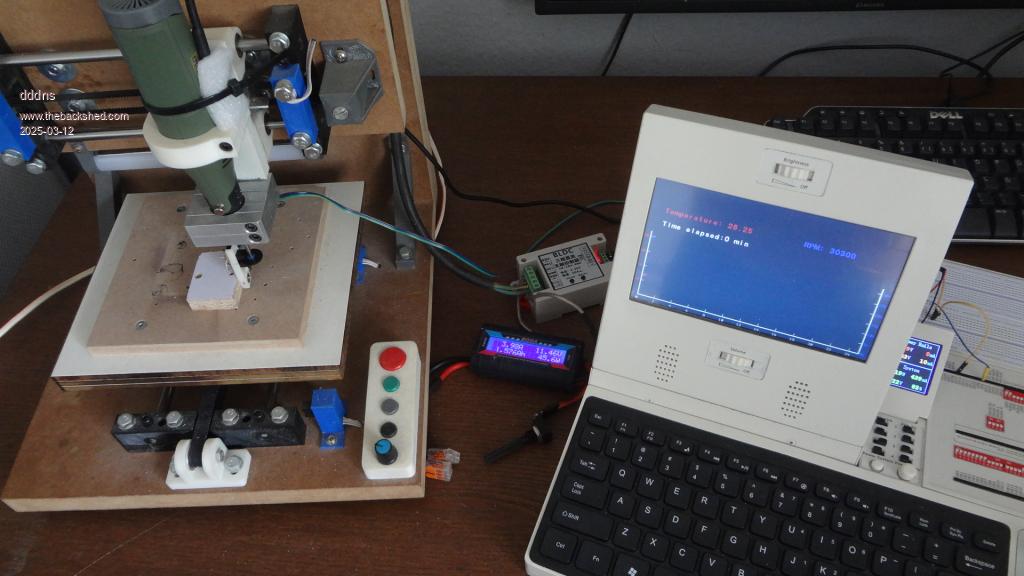

Hello All!
As every transistor or screw goes off my mouth I love this hobby so much that there is usually some kind of solution. In this case it meant for me to spend time not necessarily money. Have fun

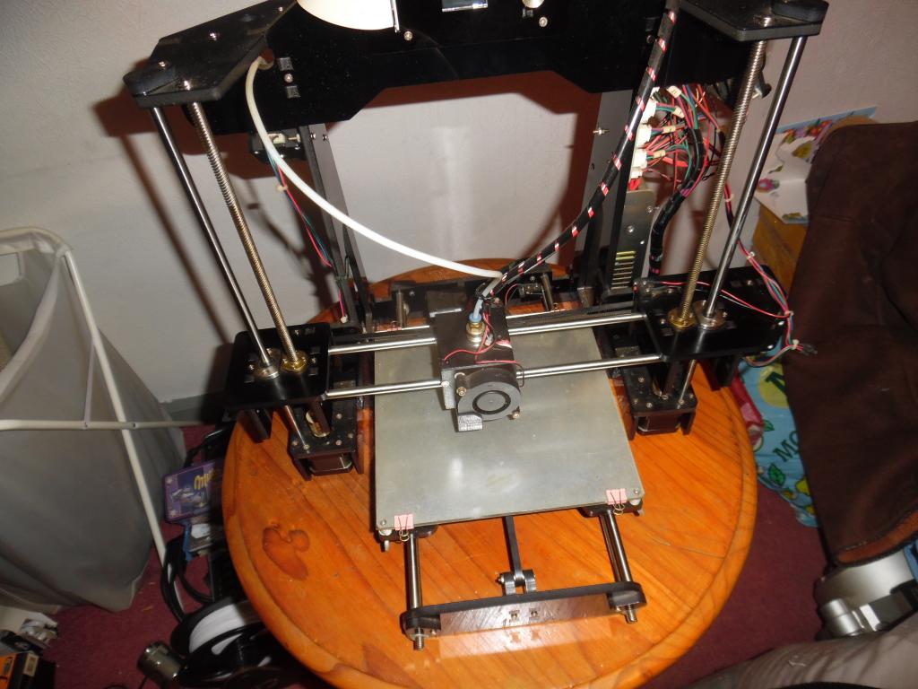

I got 2 anet A8 3d printers and a "dremel". Hmmmmm? could I do that?
does it drill the holes to? Looks tidy, impressed.
what software you using?

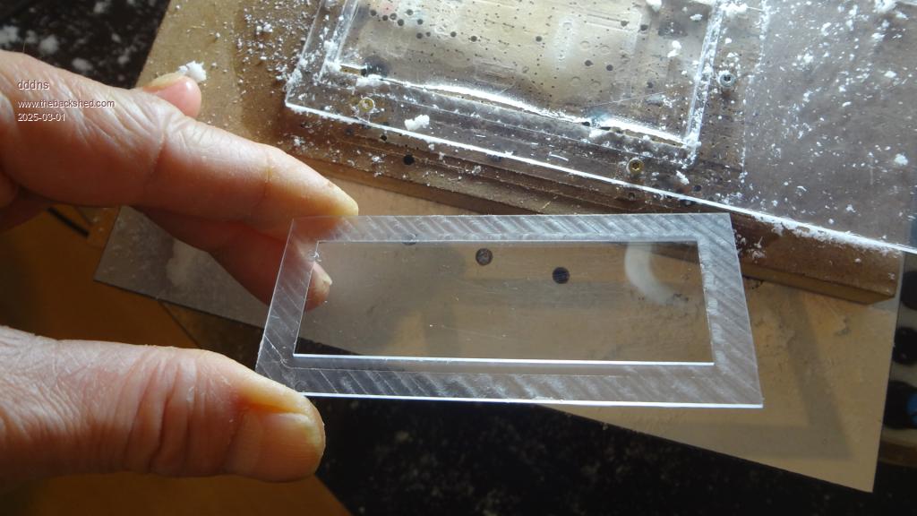

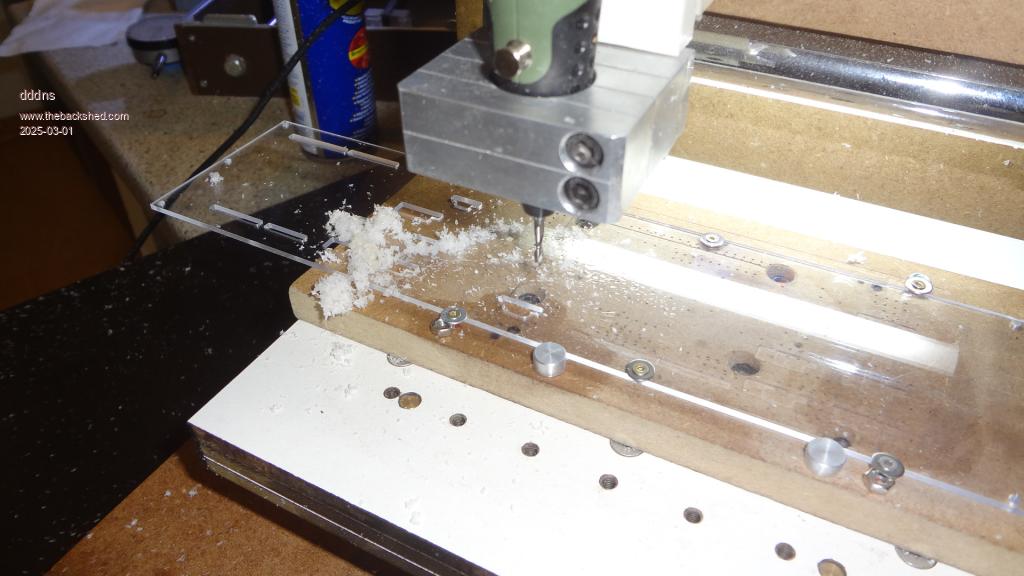

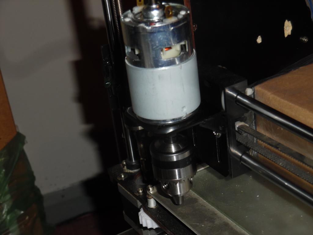

yes you can! :))

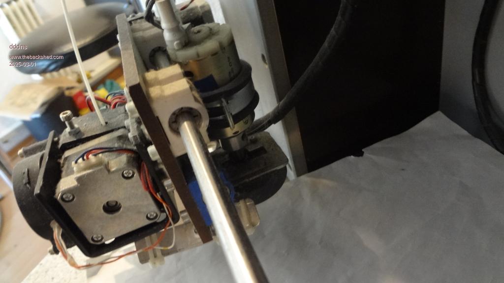

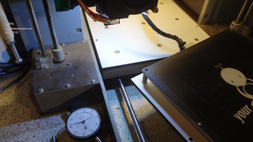

My first tries were, to pimp my selfmade 3D printer.
I simply mounted a 1,50€ motor with a barring.It works!
Attached is a result done with this solution.
And yes, you can decide from which side, but drilling is essential that it is done
by the mill.
But doing that with Marlin is a pain..
So I decided to have a dedicated mill with GRBL.
Edited 2025-03-01 02:28 by dddns

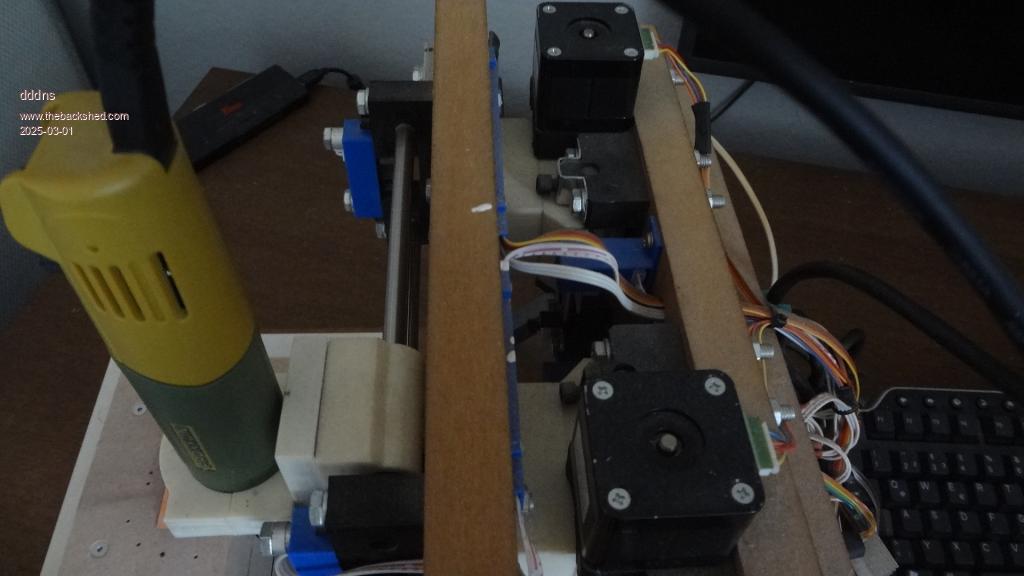

Beautiful.  I have a couple of CNC routers and mills and an LPKF PCB grinder.  Your boards actually look better than the LPKF- very good.
Be really careful with the dust from fiberglass cutting- it makes and aerosolizes tiny glass fibers that are terrible for your lungs.  Its not the dust that you can see, it is invisible stuff that kills you.  The LPKF has a full time vacuum that leads to a very fine HEPA filter.
Nice work.  I like that you have bulk and stiffness where required.

AFAIK it's not possible at home, to evaporate copper. Very high energy consumption and very difficult to fulfill requirements.

  jwettroth said  Beautiful.  I have a couple of CNC routers and mills and an LPKF PCB grinder.  Your boards actually look better than the LPKF- very good.

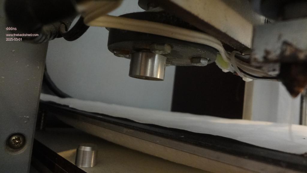

Thank you for the hint! Never paid attention to..
Apropos vacuum :) I plan to build a small vacuum tension plate with help of my vacuum cleaner :))

Thanks.This was build in my single room apartment. If I would have the opportunity I really would like to build it at least out of Aluminum and the frame out of steel.
I searched the market, but there is nothing under 1000€ which is worth to buy. You can buy, but it will be garbage for like 300€.

dddns
Joined: 20/09/2024
Posts: 925

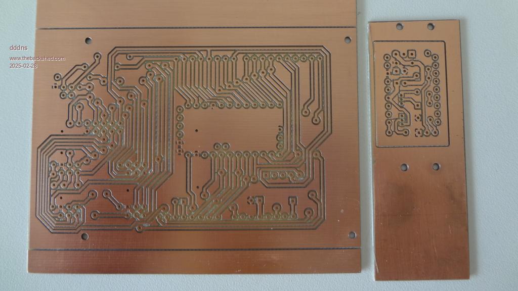

Posted: 08:33am 03 Mar 2025
I think it is possible, to do the exposition with a laser and then develop and etch.
One big advantage of milling is to drill the wholes in the same clamping.
Some hundred wholes are no fun to drill by hand and hard to align and center.
