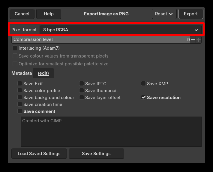

The CMM2 user manual has detailed explanation about sprites and other commands and functions.
https://geoffg.net/Downloads/Maximite/Colour_Maximite_2_User_Manual.pdf
The CMM2 graphics manual expands this material.
2021-04-05_114624_Graphics Programming on the CMM2-v3f.pdf
Usually I edit my images on Gimp and export them as PNG selecting the appropriate pixel format
