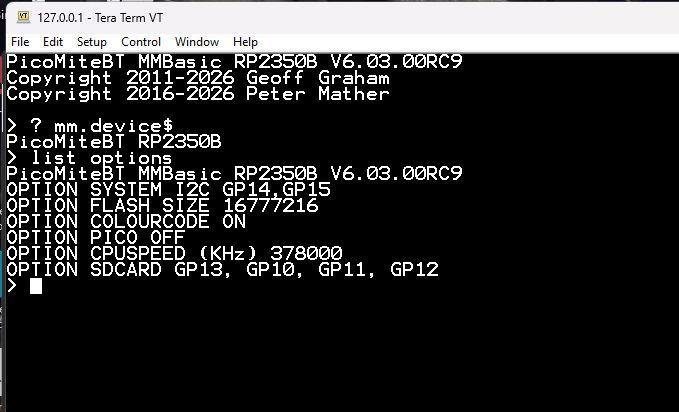

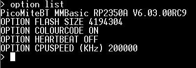

Posted: 03:59am 19 May 2026
Hello
Have tested the PicoMiteBT version, and it works ...
I have tried using a Windows 11 computer, and TeraTerm.
"I am as happy as a penguin in a microwave", quote from QI TV series

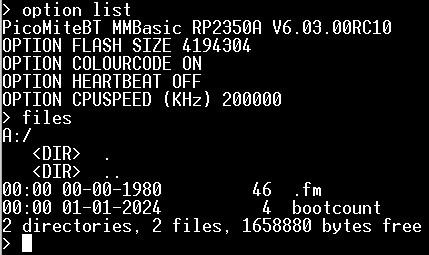

Posted: 08:57am 19 May 2026
Yep, PicoMiteBT RC10 works too. I will try a little more...

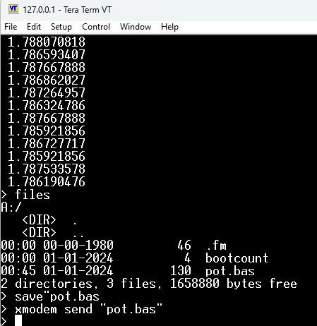

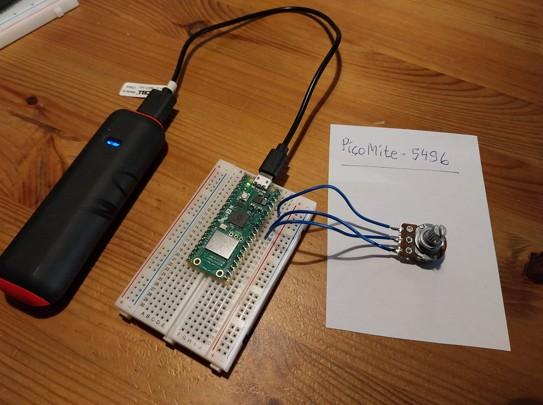

Test of PicoMiteBT, RC10.
A small test program that shows the value from a potentiometer (10K).
' Read a pot. , using PicoMiteBT RC10
SetPin gp26, ain
'SetPin gp26, araw
Print Pin(gp26)
Pause (100)
End
Setup:
Test XMODEM SEND ...
/Peter63

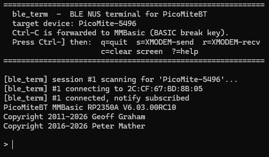

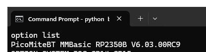

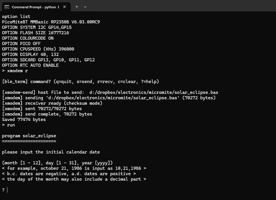

I've created a standalone MMbasic specific terminal for BLE NUS. You can use this instead of the bridge. Should work on Windows or Linux as long as Bleak is installed (pip install bleak). Just open a command window and execute the python command. e.g.
python ble_term.py PicoMite-77BA
Assuming you have the PicoMiteBT paired as explained in the manual then you then are in a vt100-like terminal. No teraterm or putty required.
ctrl-] is a magic key for exiting and invoking xmodem
ble_term.zip
PicoMiteBT.pdf
Edited 2026-05-19 23:57 by matherp

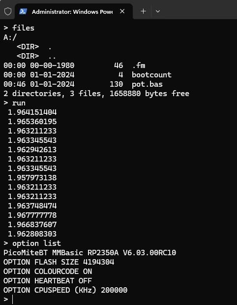

Posted: 03:43pm 19 May 2026
  Quote  I've created a standalone MMbasic specific terminal for BLE NUS. You can use this instead of the bridge. Should work on Windows or Linux as long as Bleak is installed (pip install bleak). Just open a command window and execute the python command. e.g.
Tested on RP500+
