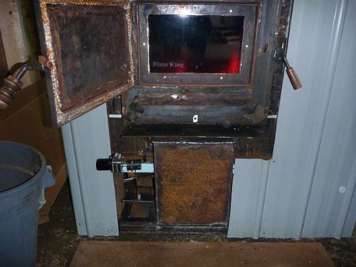

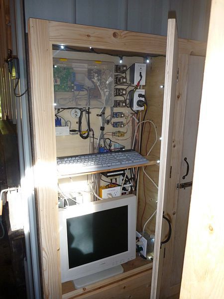

The MM does monitor the boiler water temp. That is what lets it know when to shut the air intake. But if the air intake was put off its calibration by the motor turning for a few seconds at start up, before the MM took control to keep it from turning, then the MM does not know it is not really closed.
I do have a sort of low tech work around that I’ve been thinking on. During the testing phase last winter I often forgot to turn off the 24 volt transformer before I booted the MM. The result was that the chain that wraps around the air intake motor drum would turn too much during the boot and physically disconnect and tear away from the air intake plate. It would rip the plate up and away from the surface it was supposed to lay flat on when the air intake was closed. I got around this by connecting the chain from the Air intake motor to the air intake plate with a small copper wire link that was only bent over, not twisted to lock it tight. This allowed the chain to pull open the copper “link” if the motor got away from me and ran during a boot up.
You have the scenario correct. The MM crashes and reboots causing the air intake motor to set in an incorrect position. I do have a routine in the program that constantly monitors the boiler water temp, but I only wrote the program to close the Air intake when it thought the Air intake was open. Never thought it would be important to close the Air intake when MM thought it was already closed.
But I’m thinking of putting in another safety sub routine that always checks the water temp (Air intake open or closed) and if it gets say over 95 degrees C then turn the air intake motor three full revolutions in either direction. This would rip the copper link open, causing the air intake plate to fall or drop back down and shut off the air until the system was manually checked on later. Using this method the MM couldn’t reopen the air intake until the copper wire link was reconnected. I kind of like this plan for its safety. I also have a sub routine that monitors the water temp while the air intake is open (and the fire usually increasing). That routine monitors the water temp, and if it continues to go down instead of up, and goes down by more than 5 degrees, then the MM closes the air intake and flashes the message “TEND TO FIRE” meaning that you are either out of fuel or the fire went out. This can happen when the air intake is closed too long between cycles. This happens sometimes when the time between firings is more than six hours.
To Centrex;
I am using MOSFETS. I mounted them in slot receptacles so I could replace or swap them out if needed. But I don’t know if I can change them for other types of transistors. That is beyond my knowledge or level of understanding at this time.
I like the idea of having a micro switch monitor the actual status of the Air intake plate. I’ll think on that too.
The Air intake is open in the upper photo. Note the plate is lifted by the Air intake motor.

The pictures show a very interesting project you have embarked upon, how often do you have to put wood in the fire.

The motor controls are configured in the first few lines in the program. One is SETPIN 20,8 and the other SETPIN 19,8.
If I load the fire box full up, (takes about 3 large wheelbarrows full which is about 1/7th of a cord), it will run for about 48 hours. I have found that by putting in much less wood, like maybe 8 to 10 18" long split logs at a time, it will easily go 12 hours. Lately I've started putting in about twice that, one wheelbarrow full at a time (about 15 to 20 split logs or 1/21st of a cord) and it easily goes for 24 hours. I burn mostly spruce or hemlock. These are both soft woods, but they account for abot 90% of what we have in these parts. Oddly enough outdoor temperature does not seem to have much impact on fuel consumption. I'll know more on this as more winter data is collected. The MM reports significant daily data go the SD chip each night at midnight.
Lately I've taken to loading up the firebox in the morning and then checking it in the evening. I don't usually load more wood at night. I just use a rake or hoe to stir it up and level the charcoal and logs. That way the next morning I have a fairly flat bed of burned wood and coals to load the next 24 hour's supply of wood on.
The house has never been so warm, nor has it ever had such even heat. The temperature in the house never fluctuates by more than 2 degrees F (about 1 degree C) from the requested temperature. I have night and day modes with different desired temperature settings. The program could easily be expanded to create any custom temperature/time or calendar controls anyone would want. It is just so nice to have rock steady even heat after years of wood stoves in the livingroom. As most folks that have heated with wood stoves will tell you, 'When you face the fire, your front will be toasty warm and your back will be half frozen.' That is not true with hot water heat! Yahoo!
