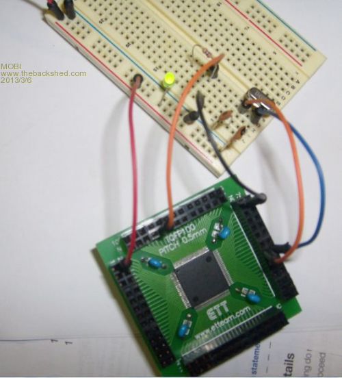

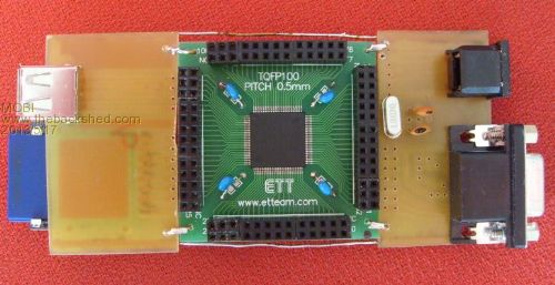

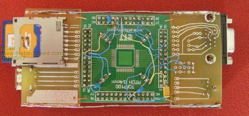

Hi all,
I have two colour MMs and am really having fun with them.
I wondered If I could grow one from the ground up, so to speak.

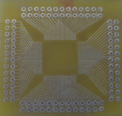

I have made a lot of PCBs using the Kinsten method (UV)and wondered how hard it would be to etch a 100 pin pic32 footprint. I am staying with Downwind so we decided to give it a go. The trace size is about the same as for "through pin" tracks with which I have had fair success. The 100 pin fotprint is a bit more daunting, but we did up some artwork on plain paper using a mono Brother laser, exposed and etched a board.
The board turned out quite good although the tinning rippled up a bit. No shorts and no breaks. So far so good. Now I wait for my pics to come for the soldering bit.
I know one can purchase boards like this one from futurelec (and I have some on the way @ $1.25ish each), but wanted to try it anyway.
Work in progress. It is only the hardware I'm tackling. I intend to load MMbasic.

  paceman said  yet to put the PIC on though - a bit chicken I think!
Do you want to wait until I get the 100 pin pic32 chips and see how I go before trying them yourself?
Have you read Geoff's article on his web site on smd soldering by hand? It is under the maximite mono construction section. Worth a read.
PS. I had a look at the site you posted - very cheap and impressive - there are even better prices if you go looking.
However, my aim is to build it all from the ground up, the idea being that if it can be done "home grown", it will be so much easier using the "ready rolled" versions of boards. That way, others may be tempted to take the plunge.Edited by MOBI 2013-01-20
David M.

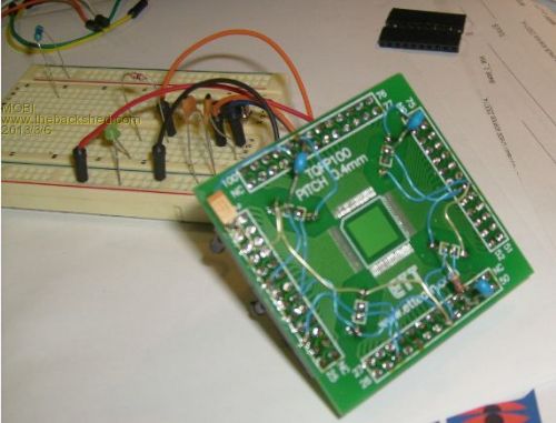

i had a couple of those ebay adaptor boards arrive last week, with a view of building up a few colour maximites using only wires - no main PCB. there are SD card boards available on ebay for only a couple of dollars that bring the pins out to an 8x2 header (auction number 280780639068), and the VGA components will be suspended on the back of the d-sub socket.
soldering SMD ICs is pretty easy, you just need to use LOTS of flux. you don't try to solder individual pins, but instead use your iron to 'drag' the solder across the pins such that as you go the flux causes the solder to un-bridge. then just tidy up the odd bridges with solder wick.

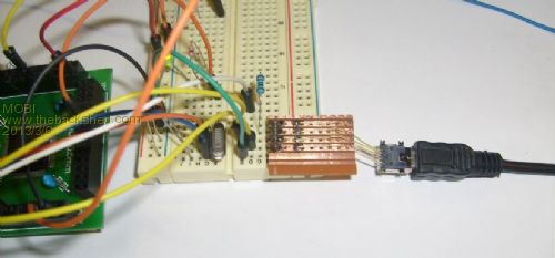

the only problem is how to get the bootloader into the PIC32... can anyone tell me the cheapest option for achieving this? i've been looking at a thing called a PICKIT2 (ebay auction 251195999655), or is a PICKIT3 needed?

   robert.rozee said  the only problem is how to get the bootloader into the PIC32... can anyone tell me the cheapest option for achieving this? i've been looking at a thing called a PICKIT2 (ebay auction 251195999655), or is a PICKIT3 needed?
I bought a Pickit3 for that purpose - unless someone knows a better way, I think it is the easiest. I haven't tried it yet but looks straight forward enough. They should be available for sale in NZ.
I am waiting for some blank pic32 chips to arrive to try things.
Thanks for the tip on the smd soldering. I had an old board that had a similar size and style of smd chip. I desoldered it with a heat gun and using some tin paste, resoldered it back on the board. All lined up ok and no bridges, so am confident enough.
I'll let you know in a few days hopefully. I am away from home for a few days so not much will happen until I get home again. Perhaps we can do this thing together or at least swap notes.

There are two main ways to programme a pic - both use the programmer module (e.g Pickit3).
1. hook up the programmer to the PC usb and the 6 pin programming end to the appropriate pins on the pic to be programmed. Then load the hex file to be programmed into the MPLAB IDE or IPE. Then activate the programme function on the PC.
2. The other way is to download the hex file into the pickit3 device and take it (without the PC) to the field where you want to programme or update a pic. That is where the button on the pickit3 comes in. It makes it easy to take an update somewhere without having to cart a PC or laptop around.
