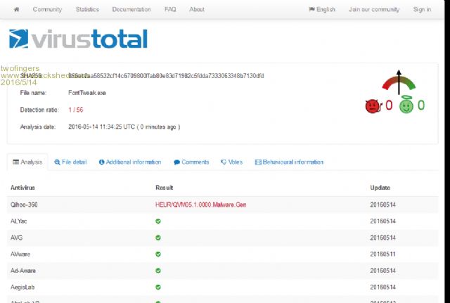

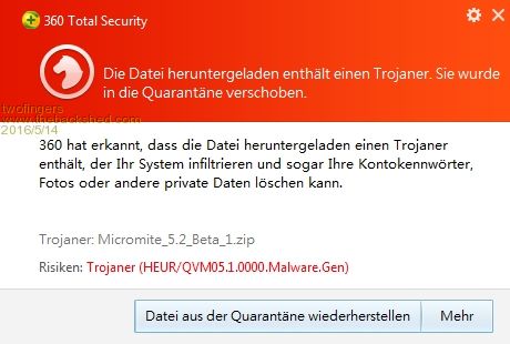

Strange:
I hope this is a false alarm! I'm on it ...
Uploading FontTweak.exe to Virus Total --> seems to be safe!
Michael
