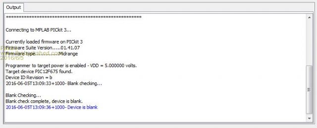

Hi All,
My 15 Year old son & I completed a Kit last night & it doesn't work.
This a first in this household, never had a kit fail in the past.
Can anyone help with diagnosis?
Construction is perfect, he's done a great soldering job.
No misplaced components.
Basic things like 12V (from SLA Battery), and 5V to chip is OK,
but that's where our testing has stopped.
It uses a preprogramed PIC12F675.
Where would we go from here to identify either dead or blank PIC etc.
Test gear we have on hand a multimeter, USB Scope and a Pickit3.

A few connections on a bread board would allow you to use the PICKit3 to read the chip. If it comes back all 0x3FF you know it's blank. If it returns 'code protected', you know there is probably something there. Or you get a firmware dump. Just be very cautious of what buttons you press in the PICKit software - you especially don't want to hit the 'Erase Chip' button!

Posted: 05:13pm 04 Jun 2016
Finally got to check this out again on a rainy day......
No Wonder it doesn't work......
I'm sure I'm reading it correctly.
Cheers.

Since this is a learning project, now is your chance to learn some PIC12 assembly. The circuit sounds simple so the firmware should be pretty simple too. The only potential difficulty is the output signal for the noisy part - is it simply on or is a particular frequency pulse train needed?

So everyone needs to own a PIC programmer?
Can't send out firmware; it's copyrighted...
Can only be distributed with a complete kit...
(This seems to apply to programmed PICs too)...
Not refundable once construction has commenced...
I do think that:-
"the goods are significantly different from the description",
Applies though. As a programmed PIC is "Significantly Different" to a blank one.

If you want to reprogram the PIC the hex file should be available from the Silicon Chip web site.
