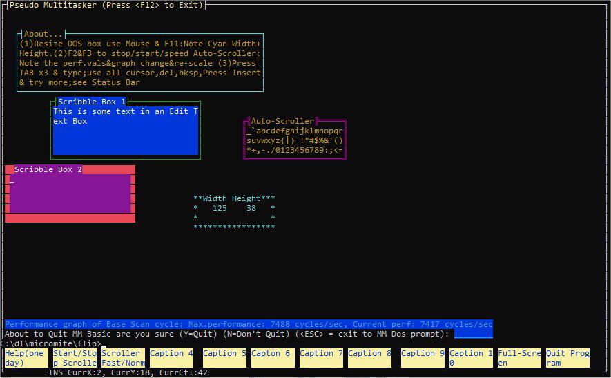

Hi all,
Going nuts (in a good way) with MMBasic for DOS, and would like to share where I want to go with it.
This is a DOS-based windows look-alike, with Function keys, Frames & Controls, Cursors, pseudo events, etc.
I think it's safe (doesn't alter anything)...it currently will crash under some conditions (e.g. string length >255)
Plans for Immediate future is uM scan and chat, program pass-through to uM (extension of one of my previous), and edit.
It is pretty rough and by no means a comprehensive thing
I suggest you Read the 'About...' Window and use as a guide to the current very limited functionality.
2017-08-28_133202_MultiTasker.zip Requires Latest Beta 7 for MMasic for DOS
Hope you enjoy playing with it as much as I enjoyed developing it !!
EDIT: A few bugs squashed and cleaned up a bit (much more to do)
2017-08-29_032038_MultiTasker0.2.zip
EDIT: And another..
2017-08-29_053415_MultiTasker0.3.zip
No more edits until I add some new features (and restructure it a bit more object orientedly).. MM DOS seems to be 100% stable so far with the punishing this code is giving it... (the only 'crashes' are not crashes per-say, but my bugs)...a real credit to Geoff's great work.
Phil

Phil--this is quite fine and fun work. Very compact code, but I could follow it well. It deserves more attention--perhaps screen shots would help. This is what you get when you run the code as-is:

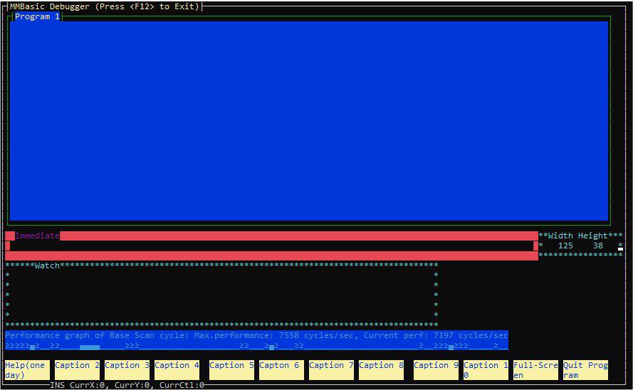

This is after I spent about an hour puzzling things out and trying to make my own windows:
(Warning--there is no code to do what the window headings imply can be done.)
This is just what I've been looking for (and it's been sitting here neglected all along.)
