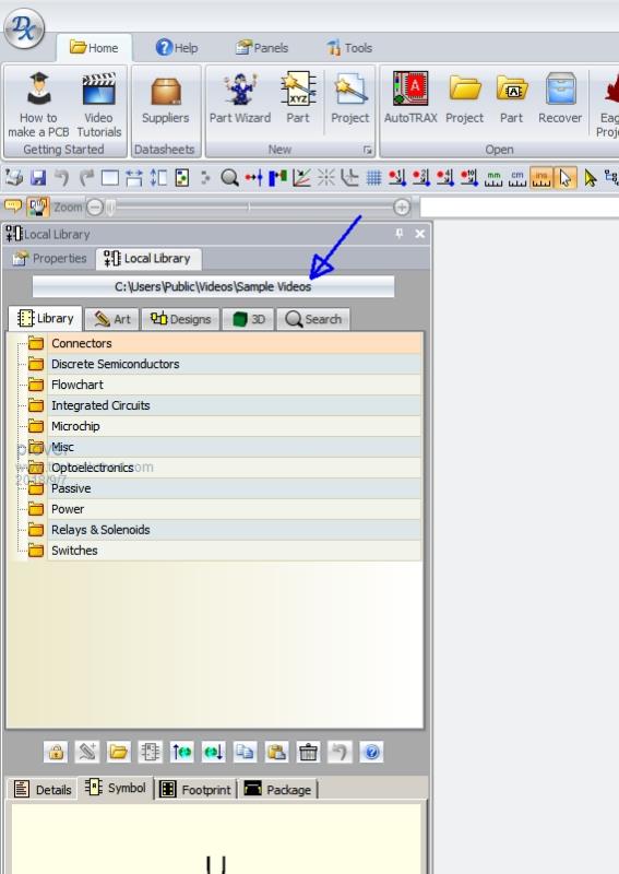

First when I decided to follow Mik's tutorial did I find the Library is completely Empty
My question has any of Forum members experienced that? Could be, I thought I would be smart and have the Library located somewhere outside default placement? I do this sort of thing but nowadays I have short memory so not so smart any longer.
I have just while writing this downloaded Library from the AutoTrax site but so far has no idea what that is. I guess I will find out.

When I went looking a bit closer in the empty Library frame I found by wight cliking that I could "download and refresh" which I could not resist testing.
Got a bit concerned that the download was 96 MB, I was going to pull the plug at 100 MB this seems more like downloading a whole new version?
Well I see no library after that. So I will have to leave it at that for time being. I will go the the lates version running in the other Guest and continue with Mik's Tutorial.

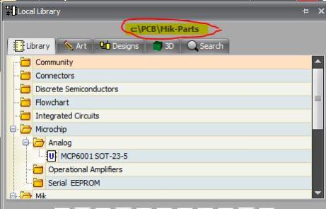

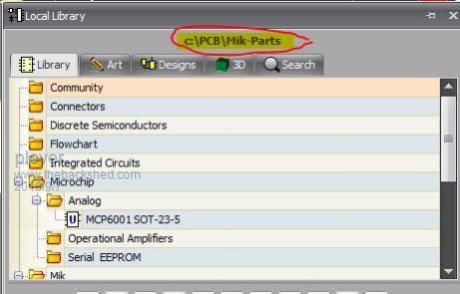

As to the library..
You can copy files into the library (and the directories themselves) using standard windows commands so if you find more sections just add them.
If you wish to point to a different location for the library right click on the path the library is stored in (just above the library panel) see this image.

Well from this section of forum I believe the file "Mick's parts" held library details for your tutorial and I unzipped and plonked the content in a new folder under library and it worked fine.
Just accidentally discovered that using Win Explorer view of the library I can drag parts onto the schematic too but of course no 'preview' available.

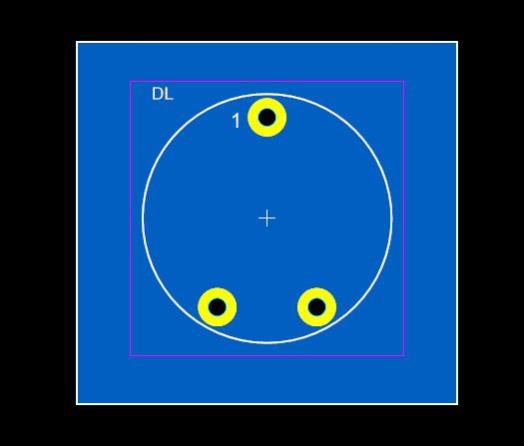

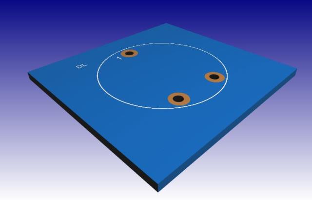

Ah yes one thing I need soon is a new very simple part, it is a Deuterium Lamp symbol
something like the following will do me.
Since I have not got to making parts how do you recommend going about making this symbol, without the annotations of course. Admit I have not got to that stage in your tutorial. I was hoping to find a symbol like this and modifi but my quick scrounge in the parts have not yielded anything yet.
Posts: 2982
Posted: 11:33am 20 Apr 2018
Hi plover,
First, Dex may not work in XP, I vaguely remember that support was going to be dropped due to more advanced features in later windows or was it 3D ??
If you can post a link to the part you want I can have a go at creating it for you..

Posts: 2982
Posted: 05:47am 21 Apr 2018
GDay Plover,

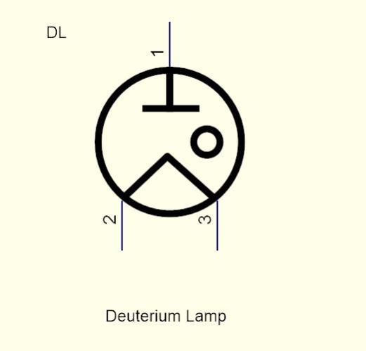

Try this for a start.
2018-04-21_154404_Deuterium_Lamp.zip
I have no idea of PCB footprint and 3D model of course but these can be editted later of course.
plover

Thank you, will have a play tonight with it the symbol is what I had mind.

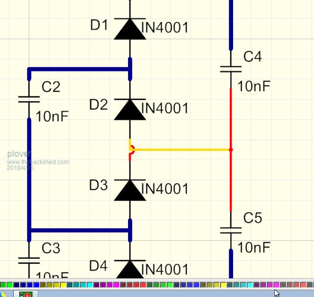

Now I have however a little problem with schematic. In the picture attached I have a problem with connecting a wire to two other wires. There is an insistence to do an 'overpass' I need a connection.
Can be solved with moving to one of the terminals but this 'does not look right' the symmetry suffers.
As you can see from the colouring I am just about to delete the yellow line to have another go.
It will not hinder the operation but .....

Hi Plover,
Yes I get that bug often..
You don’t need to delete the link, just click and drag the junction and it will fix..
The junction is where the 2 wires actually join, in your case on or just below the diode.
It is just the appearance that is wrong, electrically they are connected.
There are many little funnies like this but I forgive DEX because it otherwise does an excellent job of everything else.. in fact it does much MUCH more than I will ever use..

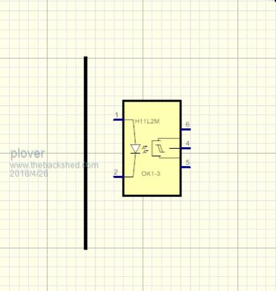

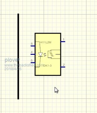

At the moment I am trying to mirror horizontally an optocoupler, the pins do but the internals do not. I just getting around to think that mirroring do not apply to graphics?
Now I have mirrored horizontally
Have you run into this one?
I think I was used to just highlight a section in Protel and flip. Not a big deal will probably just have to make a flipped part but at the moment I struggle making parts.
added later
So far from reading manual around 158 to 168 mirroring a symbol does not include the graphics. Edited by plover 2018-04-27
Posts: 2982
Posted: 07:27am 27 Apr 2018
Hi Plover,
Can you post your part in a ZIP and I will have a look at it for you.

Hi Mick,
The problem is partly gone, seems I was approaching making parts the wrong way. I need to train myself a it better on that.

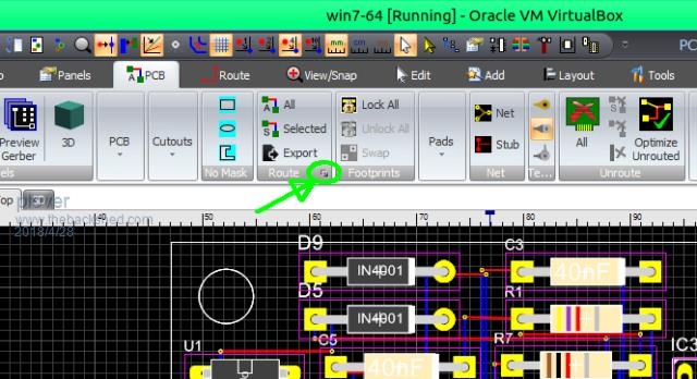

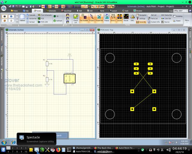

More important now for me is why my system does not route. I have a circuit finished enough to be able to build. When I hit the go button in the 'schematics tab' it seems to do the right thing. Places the components and shows the pcb with the net but no tacks laid in.
Thought it was me that no doubt has made mistake, so placed a simple optocoupler a couple of resistors. Minimal wiring and let it run, same thing not sign of routing taking place.
Last thing I used the sample amplifier and let it route that. took several minutes and only net shown at the end, no tracks laid. I could fin no errors when checking my board.

There is autorouting that uses ELECTRA-free that does a reasonable (NOT as good as protel but easy to fix any irregularities)
and
Manual routing..
Which routing is not working for you?

Bit of a battle but progress, I am pushing too hard as I feel I am not getting there fast enough and consequently not reading the manual carefully enough. The problem was router selection. Finally found that tiny little icon that gives you Router Selection.
When I found the place I believe from memory that it was set to Manual. Did not try to manually route as at that stage I had not worked out how to start tha by simply double clicking on the net lines, now I do.
Now however it is starting to get interesting, another couple of weeks I should be feeling much more comfortable navigating around.
I do have some nasty surprises which may be due to running a VBox Guest Windows, this virtual box stuff is also very new to me not even sure it is set up proper. I am finding however that the Windows system locks up almost completely. I say almost because there is a bit of cursor movement in Windows but not in DEX.
So far my way out has been to shut down the VBox to get back to Linux and then restart again. I had a bit of luck here as it was a big for me new part I had made and just going to replace in the Schematic went like the cursor took off racing off the sheet too far not to come back again in DEX. Here I learnt the value of 'Recover' worked very well.

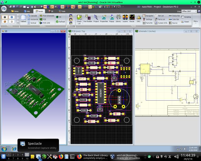

Below my effort on a real circuit so far, and it is far from being more than the beginning needs lots more work.
I was going to upload two pictures but I can't at the moment. Same thing happened last night or very early this morning, thought maintenance on the site may be in progress. Simply can not connect to the website if I try to upload picture.
'Add Image' and add Zip file icons both respond, 'Uload File' no response will check when I come back from a restart later today.
No problem it seems to edit and update the text.

Below shows where the "secret button/icon is hidden" and I have probably missed out any other obvious icon, if so I would like to know!
The green arrow shows the icon that opens up the 'Router Selection', which was set to manual, so in reality my system was working all the time I just did not get it, should have swallowed my pride and asked question fairly soon after knowing I was stuck. (It is in the manual too, which I scan too quickly)
Below is what I have arrived at, the parts count is about right but values are random. the deuterium tube is not known yet but I appreciated Mick's effort getting one to me so I could get going.
