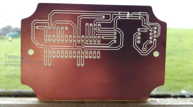

Posts: 6606
Posted: 02:44am 25 Aug 2018
One of my early attempts with a CNC.
Traces, holes then outline all in one sitting.
It takes a bit of fiddling but once I had a procedure that works, I was happy with the results.
I stick to single sided boards.
Etching will get finer traces.

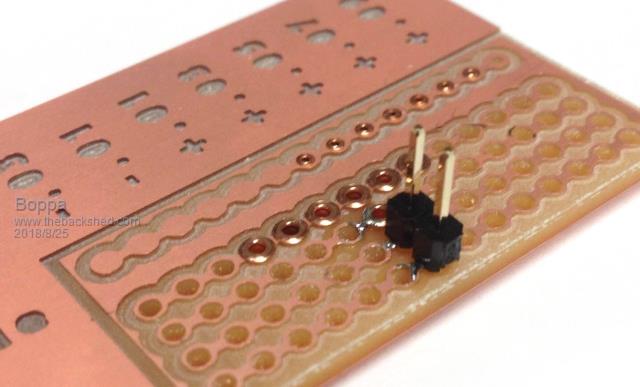

One thing I havent seen for a while, I used to use them years ago, was the 'through hole rivets' for diy doublesided pcbs...
I used them with homemade etched boards- you could use the old 'solder both sides of a leg' system, but that was awkward on some components (like single ended electrolytic caps), these were a hollow 'rivet' made of copper that had one end already 'belled' into a inverted cone shape, and you did the other end either with a special tool, or like me, used a centerpunch and then a pair of multigrips...
made through hole 'plating' easy as
eta nice pcb btw
eta2
these
from http://fab.cba.mit.edu/classes/863.16/doc/tutorials/PCB_Rivets/Edited by Boppa 2018-08-26
