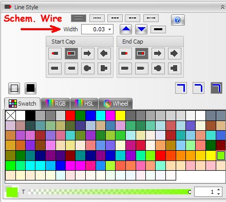

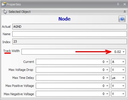

I still have a few questions about track widths.
When you hover the mouse over a wire in the schematic, a hint pops up with some data, including the track width of that particular wire. How can that width be changed on the schematic on a wire by wire basis?

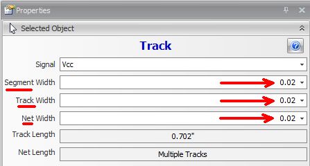

How can you change the width of tracks in PCB layout mode on a section by section basis, not an entire net basis? (Typically I like to make my power traces very thick near the power source, such as the regulator, and get progressively thinner as the tracks radiate out and branch to different sections.)

OK In the Schematic, To change the widths of the TRACKS on the PCB do the following:
Have the Properties panel pinned.
Right click on a `wire' in question.
Brings up this in the properties panel. This will set the width of EVERY track on that selected NET on the PCB only!
If you want to change the look (Colour or width) in the Schematic in the properties panel (probably collapsed - Use the chevrons to expand it) you will see this section. You can set the Wire width and colour and few other settings.
Now, In the PCB work sheet, we have some settings for the PCB only.
With the properties panel pinned, click on a section of a track you wish to change its width. Brings up this section n the Properties panel.
Note there are 3 WIDTHS to play with..
The NET width sets EVERY section of EVERY track on that selected NET. Great for setting a power line's default width.. This is the same as the first selection I mentioned in the SCHEMATIC work sheet.
The TRACK width sets EVERY section of the selected track between 2 points (ie. pads, or other tracks) so this could set 4 or 5 segments of track at the same time.
The SEGMENT width sets ONLY the selected segment(s) - You can select several SEGMENTS of track by holding down the Crtrl button.
So in your case of fattening up nearer the power input, use either TRACK or SEGMENT widths.
