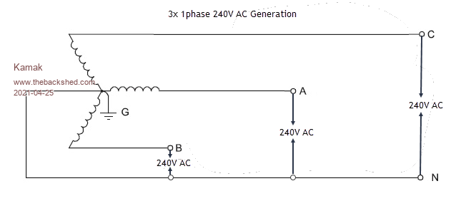

Posted: 12:42am 25 Apr 2021
  Technophiliac said  What wattage power are you expecting to get out of this device?
What are your wind conditions, mounting means, and height planned, and propeller blade size and speed? Do you have information on the planetary gearbox planned?
Well, maybe something like 480V AC @ 1200W = 2.5A AC, speed would be approx. 1000rpm, through a planetary at the sun gear, with the ring gear spinning at 100rpm, 10:1
Blade size unknown at this point. I need to determine the required torque, and determine what blade/prop diameter would produce said torque.
48V DC @ approx 25A (not considering any losses) would be my intended charge controller endpoint. I could consider DC voltage dividers to multiple charge controllers.

Three fairly cheap single-phase 240V AC to 48V DC 10A adapters might be an option.
But these are not regulating type devices, per se, they won't take a large swing in input voltage. So some kind of switching-on at minimum voltage production of the turbine and max rpm control would be required.
There are 10-20A ver, much cheaper, but 200-250V ac gives it some wiggle room.
AC-200V-250V-To-DC-48V-50A-2400W-Power-Supply-For-ZVS-High-Frequency-Induction-Heating-Module
