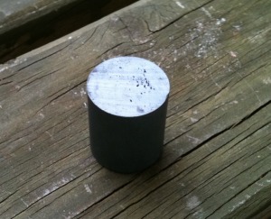

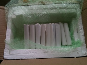

Posted: 03:13am 09 Jun 2011
The magnets arrived today.
Well packed.
One of the magnets.
Also in the box was product catalogue leaflet, a fridge magnet and a information sheet that covered some interesting tip's, like how to separate the magnets, what they are made of, etc.
Pretty happy with the order, top marks to aussiemagnets.

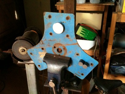

Posted: 12:42pm 09 Jun 2011
I stuck the magnets on some 3mm plate. In the pic you can see a single 50mm neo N50 magnet and two of the ferrite magnets side by side.
I wanted to see how much flux was leaking out the back of a 3mm thick steel backing plate, and if I could side two ferrite magnets side by side without them pushing apart from each other. They would sit side by side ok, just. A drop of superglue underneath will help, but I also think a cable tie around the pair would ensure they stay put.
I used my gauss meter to take the measurements. The max gauss my meter can read is about 1500, so it was pegged out on the faces of both the ferrite and neo magnets. Reading the back of the plates was interesting. I could detect 23 gauss behind the ferrite magnet, and its a 1800 gauss magnet, so less than 1.3% is lost. What was surprising was the neo magnet, with a reading of 124 gauss. At a guess its a 5500 gauss magnet, so I'm loosing only 2.3%. I'm thinking the 10mm thick plates used on the larger axials might be a bit of overkill.
Anyway, I'll use 3mm plate for this prototype. I may gain a fraction of a % in power if I use 4 or 5mm plate, but 3mm plate is much cheaper and easier to cut. I think it will have more than enough strength too. The 23 gauss wasn't even enough to hold a small nail to the back of the plate.

Posted: 01:47pm 09 Jun 2011
Hi glenn
I think the main problem with 3mm plates will be to get them to run true as they are a bit thin I would be more comfortable wit 5 or ^mm.
All the best
Bob

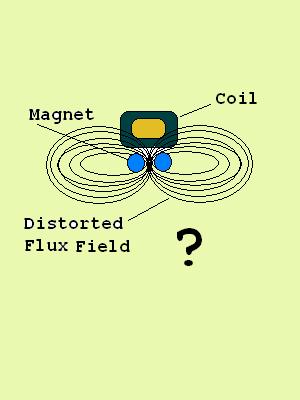

Posted: 04:27pm 09 Jun 2011
Gizmo,
Just Curious whether this would effect Inductance?
Looking forward to the Test Phase, it's a good looking Design. Cheers------Roe
Posted: 09:57pm 09 Jun 2011
Hi Roe
Both magnets are facing the same way, not opposite. N to N, S to S, so it becomes a single larger figure 8 shapped magnet. If they were fitted N to S, yeah, it would cancel out across the coils and you'll get no power.

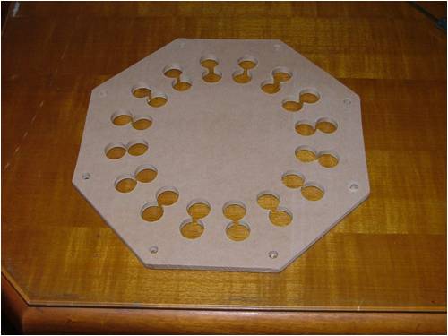

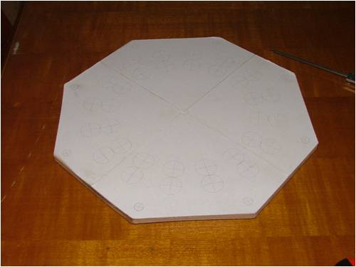

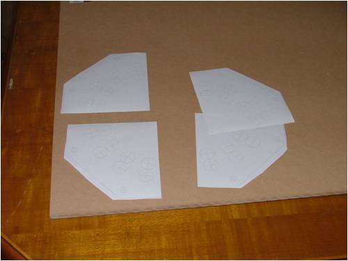

Posted: 02:09am 22 Jun 2011
This morning I made the magnet locating jig. Printed out part of the cad drawing at full size and cut into sections, it was too big to fit on one sheet.
Lightly glued in place and then center punched the holes. In hindsight I didn't need to glue at all, some tape would have worked, just to hold the paper in place while I center punched the holes.
Finished jig, holes drilled. The magnets are 22mm diameter, and I just happened to have a 22mm wood bit in the tool box.
Next up are the coil formers.
