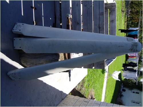

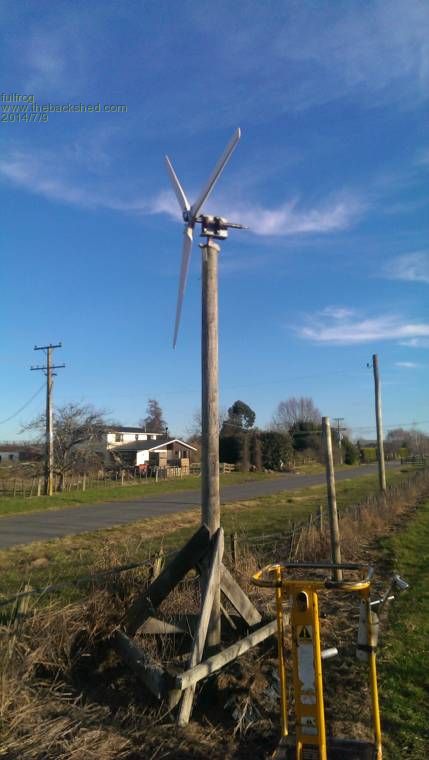

Hello guys iam new to this site and would just like to show you a windmill i am working on at the moment
these are the blades i will be using 2.5m set
as you can see it is qwite big any help with mounting will be greatley apresheated Thankyou .

Posted: 04:37am 12 Jun 2011
Hi Angus
Looks good so far. Where did the blades come from, and what are they made of?

Hi Glenn
i got the blades off http://www.ecoinnovation.co.nz im not to sure what they are made off but i think some sort of plastic

fulfrog,
Is this going to be a down wind machine? or are you going to have the prop upwind and try to furl it with a tail? Also do you already have a tower, or one in mind...monting ideas might be easyer if we had more of this information.

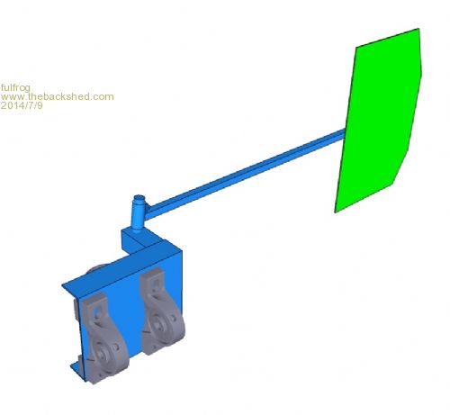

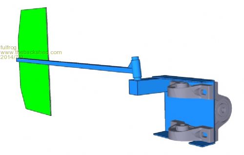

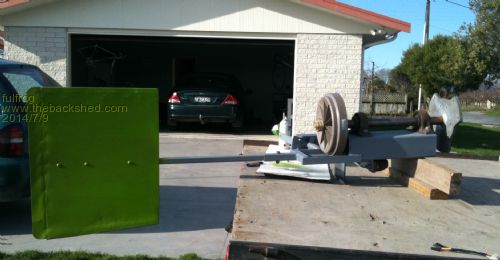

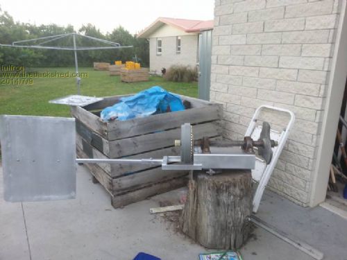

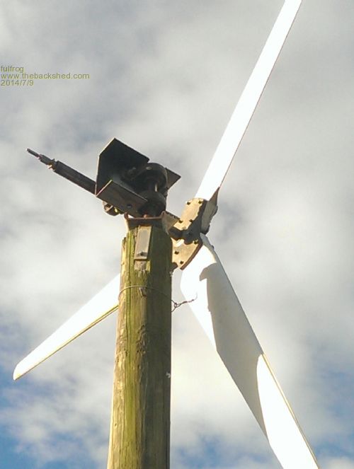

Hi all
it's been awhile but I forgot I had it up here on the forum.
Thought it was about time to continue to develop my design it's been sitting in the shed for nearly 2 years now.
I mostly had the mill running and producing decent power. The problem with this was that it was a)very heavy and b) it had no safety in the design in the case of very high wind speeds, this wasn't much of a problem living on an orchard having easy access to a hydralada(cherry picker) but it soon became a pain. some photos bellow
I am currently in the stages of building my second prototype this time lighter and with furling capability. I have done a little play on CAD to show a ruff idea of what I had in mind. I have started to create my mill to my cad drawings, I currently have the shaft at the local machinist getting shortened. Still thinking on how I will mount the stator open to help or ideas.
I still don't have an ideal tower but im planing on building/purchasing one in the future. When I get one, I will be changing the yaw bearings out for an option that will allow me to use slip rings.
Cheers Angus

Hi Angus,
I think this looks really good. I like the idea of moving the alternator back and opposite the blades. It seems like a good way to distribute the weight and better manage the loads on the shaft. Chris Olson has several builds like this. I forget his website (Dairy something or other?), but you could google him on OP.
The furling layout seems logical. Hard to tell from the photos what sizes are, but the tail looks a bit small to me. Hugh P. has a pretty good worksheet for calculating the torque and restoring moment. You'll need stops both top and bottom. Often the lower stop will be a bit past the 90 deg mark. I think ours is 100-105 degs IIRC. In lighter winds, where the tail boom stays pressed against the lower stop, this can help reduce the "skew" off the line of the wind.
A couple more thoughts/first impressions:
The yaw point takes a lot of slow speed thrust in addition to the radial loading. We used a bronze/composite thrust bearing. You might want to look at something - and it sounds heavy.
Not sure how deep that pole is, but I wouldn't rely too much on those diagonal braces. Maybe some temporary guys? Hate to see your hard work come down in a unexpected high wind.
Best of luck & keep us posted. ~kitestrings

thanks kitestrings
yeah ill look into some guy wires
i was planing on using the current setup on the yaw for now and later i was thinking of switching it for a stub axel and hub
with the tail it will be a bit of trial and error in reality.

  Quote  with the tail it will be a bit of trial and error in reality.
Yes, but while it is not exact science, there are some pretty good calculations and/or ROT that will get you very close, so it isn't all black art.
On this site there is this:
http://www.thebackshed.com/windmill/Docs/Furling.asp
Hugh P has a really good basic formula (note the subsequent change he explains):
http://www.fieldlines.com/index.php/topic,146065.msg997497.h tml#msg997497
Hope this helps.
~kitestrings

As for formulas to work out furl moment, its not worth the trouble and head scratching as there are to many variables ,as Hugh says ( But that formula should be close with the sort of blades that I make and describe.)
Different blades / different tails , weights and on and on - how can any one formular give an answer . In my experience is people read what is in the formular and then just use the example and go with-(So for our windmill to start furling at 72kmh, it needs a tail pivot angle of 20deg, a tail lenght of 1.378m and weight of 20kg.) 20kg tail weight with 20deg lay back which is a ridiculous figure for a 2m Dia Mill, then to go off and think this is a good starting point.
My advice to you is to experiment and try this as a start point , 80~100mm blade offset , make a tail light and long ( minimum being the blade radius ) the tail pivot is then 3~5deg laid back and then experiment with the side angle ( start at 12 ~ 15deg). By either just changing the side angle or adding and subtracting tail weight will increase or decrease furling .
Also Give the tail 10 ~ 15deg angle to the opposite side of blade offset to counteract the blade offset force.
Thanks so much for your help Phill. I am unsure if the tail pivot point is offset aswell, or is it in-line with the Yaw point, i couldn't really find a clear answer for that on those links?.
Your right the smart drive will never burn out so ill continue to build it strong (well attempt too).
Cheers.

If the blades are plastic and I have not read all the replies, then get a liquid primer from Bunnings, which sticks to plastic, then paint it white as UV is your enemy.
Good luck!

there fibreglass with a plastic type finish by the looks of it.

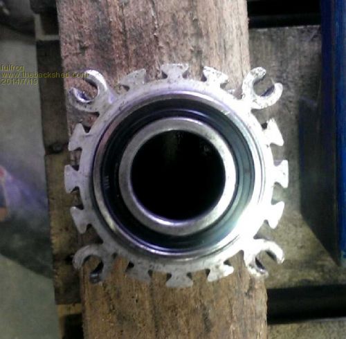

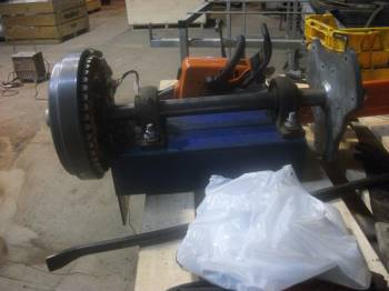

Posted: 02:05pm 18 Jul 2014

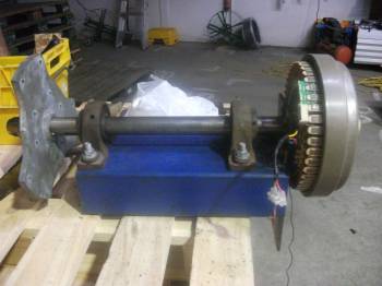

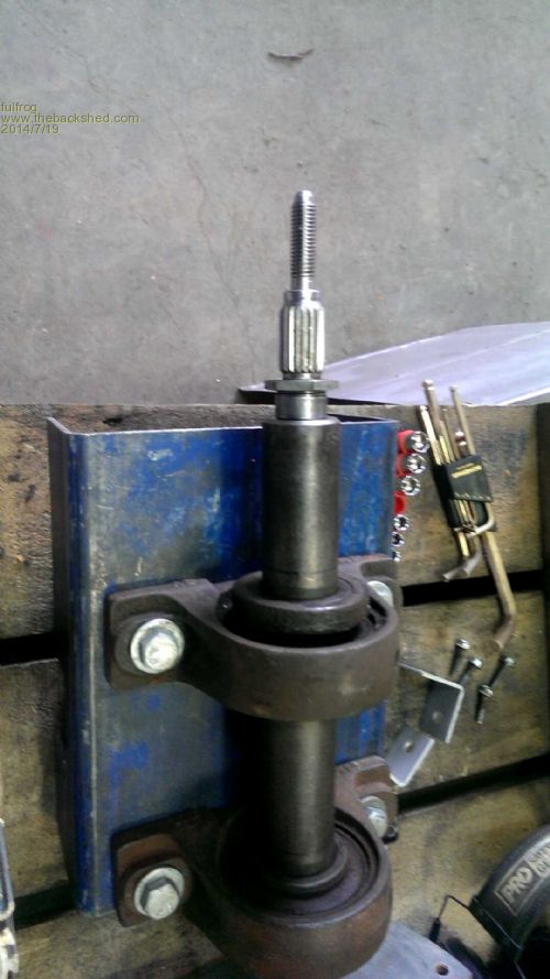

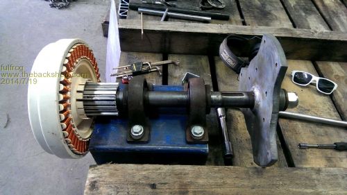

Did some work on the windmill this weekend hopefully will be able to so some more this weekend.
I have got my shaft back
I have melted the plastic of the stock bearing housing and have shortened it so that it only has the bearing at the stator mounting end
starting to get somewhere :)
am unsure if the tail pivot point is offset aswell, or is it in-line with the Yaw point?
can someone help with this?
fillm
Joined: 10/02/2007
Posts: 730
Posted: 05:43pm 18 Jul 2014
You can off-set if you want, some say you should have it the same distance as your blade off-set .... give that a go ,or whatever you can get to work best with your design.
