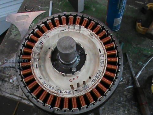

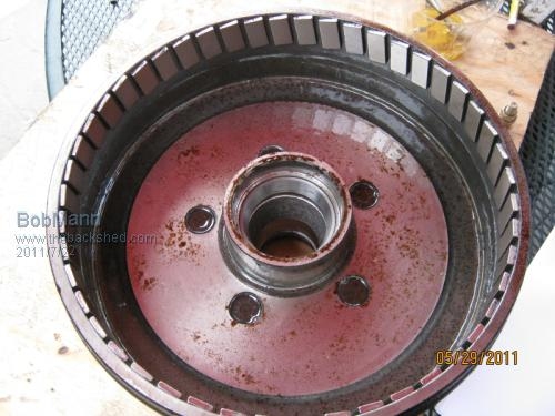

What I was talking about was the Mann Smart Drive ready to go.
It is a steel drum with neomagnets and uses the New F&P 38 pole stator.
Witch you can wire any way you like. 12 Volt=24/48/68/500.
The front is a flat front with 5 1/2 lugs on 4 center.
and a 2 inch OD tail shaft can cut to what you need 3 inch long.
Back view

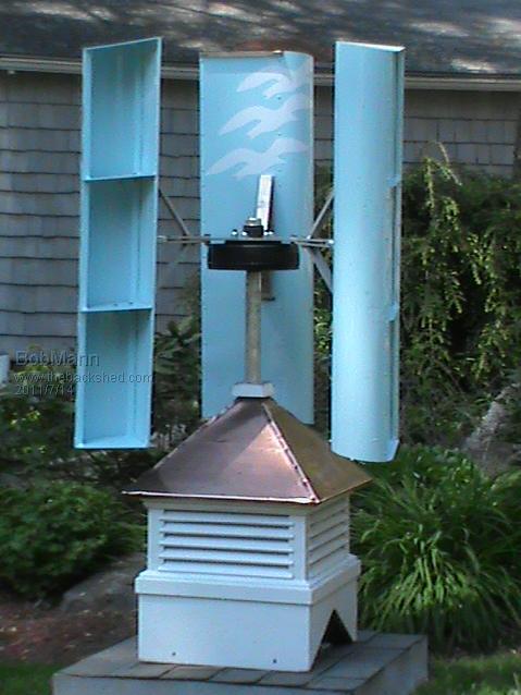

Side view with my wings you would just build a plate and add you wings
and add a nose cone would make it very cool.
Let me know I would like to see a few out there as HAWT and get some
fead back.

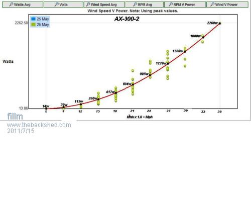

The output figures you are stating there do not do it any favours , you have the cutin as starting to make power at 4.4m/s ( 10mph or 16kmh ) 23w which is not that good as most wind generators would be making good power well below that wind speed.
As you can see from the power curve below from my AX-FX @ 15kph or 10mph is up around 280w and is easily making 23w in 5mph, and by 20-25mph 10m/s or 36kph is topping out at over 2000w and previously have seen over 3200W in 50+kph but I now have the furling a lot lower to protect it.
10m/s is where a wind turbine should be at its maximium power and then starting to protect its self .
Because my annemometer goes up in 3 kph increments, I average it though the centre as 15 can be +or- 2.9k which can be seen in the power dots in a line . All this info is logging live to the Piclog Live page HERE .

Steve is allways on the safe side. and this is a VAWT is a 3 lenx mod blade 4 ft high by 3
It is a Low cost Mann Smart Drive that can be assmbled with off the self suff and put togther in less then 3 hours and shipped around the world.
I am sorry to say but most people in the USA and big time on the East coast hate HAWT
My Tree Top Wind Mill was build to work in dirty air on a tree top. sides of a building roof tops were most HAWT would not go.
