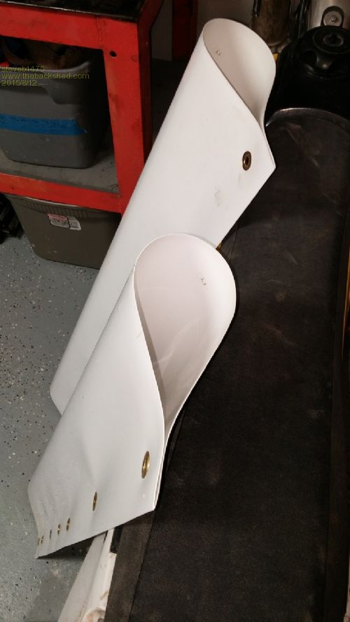

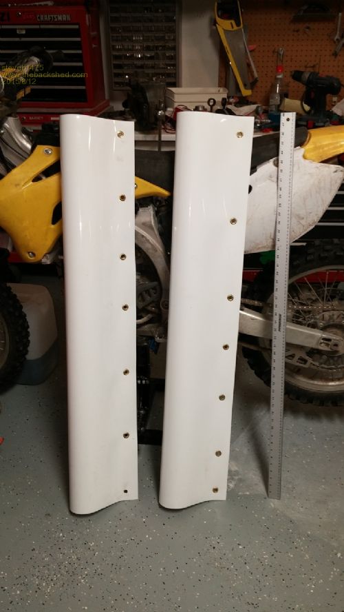

I was also thinking of trying these for blades on the VAWT:
They are just heavy plastic pipe insulation shells grommeted together that I will reinforce.
My thought was to mount a piece of aluminum flatbar across to the hub on the motor connected to a tube down the inside edge of the blades. If I go HAWT then I will most likely fab the blades from PVC pipe.

The blades should really have a near flat side, like a air craft wing, to give lift. You can buy blade extrusions, they cost money but have a proven record and save a lot of work. See http://www.thebackshed.com/windmill/Kits.asp
Yeah stick with HAWT if you can. VAWT's initially seam easier, but in the end we all turn to HAWT's.
