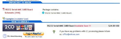

The RS232 standard is not adhered to in the micro world much these days. 5V logic seems pretty normal now. Some older stuff is still fussy with 12V levels, and there will always be problems with distance transmissions. I will be looking into these units instead of needing a PC for data logging, when they become available.

I agree, many devices claiming to be RS 232 standard accept 0V / 5V signal levels. But if a device really has 5V / 0V outbound signal capasity it shouldn't be advertised as a RS232 device, instead it just should be "5V serial interface"
I too will be interested to look at these devices more, when they became available. With the pic device on board, there is enough ram available to write the whole blocks on the mmc card. This is the worst problem with direct access from picaxe to mmc, not enough ram on board to write the full 512 bytes on a block.

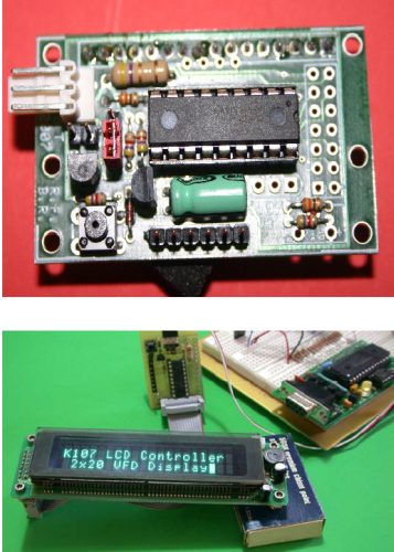

Another (possible) useful gadget:
K107 - Serial LCD Controller - a very good .pdf documentation file
You need to "spend" only one pin for comm. with this LCD. It comes as a kit for 9600 bps (PIC general use) or 2400 bps for PICAXE/8pin PIC's usage.
Is useful for testing/debuging in development process or for final product (e.g., as LCD display for picaxe08M logger!!!).
If you use it with Glenn's Windmill Controller/Charger (PICAXE28X), you can free 5 pins for other inputs!
K107 web page address
More info:
The project for PICAXE, with detailed info and examples of how to write Basic programs for PICAXE for displaying on LCD.
The project for PIC's with detailed info.
