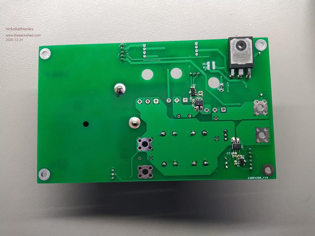

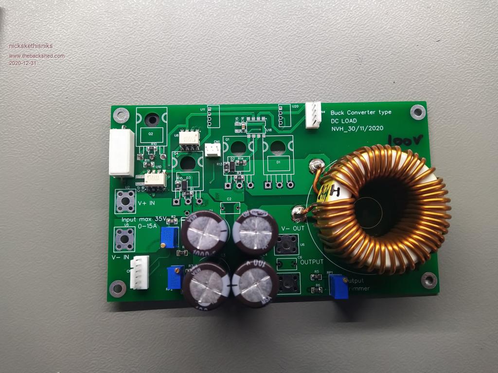

So I have created 2 prototype boards:

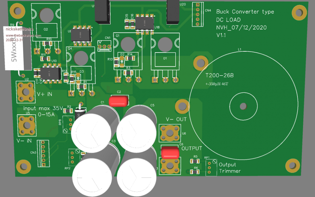

First board, the buck converter, it has a pre charge circuit with a resistor and mosfet, so no sparks when connecting the battery for the first time. Then there is a mosfet to take over when capacitors in the circuit are charged. There are voltage dividers to measure the voltage on each stage. Then there is the buck mosfet and freewheeling diode, and off course the inductor, the higher the value the smaller the current ripple on the input/output. It uses ACS712 sensors to measure the current. I made a mistake so they are backwards and need an opamp circuit to use them for current regulation with a TL494 pwm IC. This will be fixed in a next version.
I will probably add an extra current measurement on the output, because this should be limited as well. But this could also be done in the software. The inductor and diode need to be protected when the circuit is operated out of its comfort zone. The circuit can take 20A on the input and output, it’s a matter of calculating the inductor and capacitors for this current. In theory you can have 100Amps going out with only 10A going in, this should be monitored.

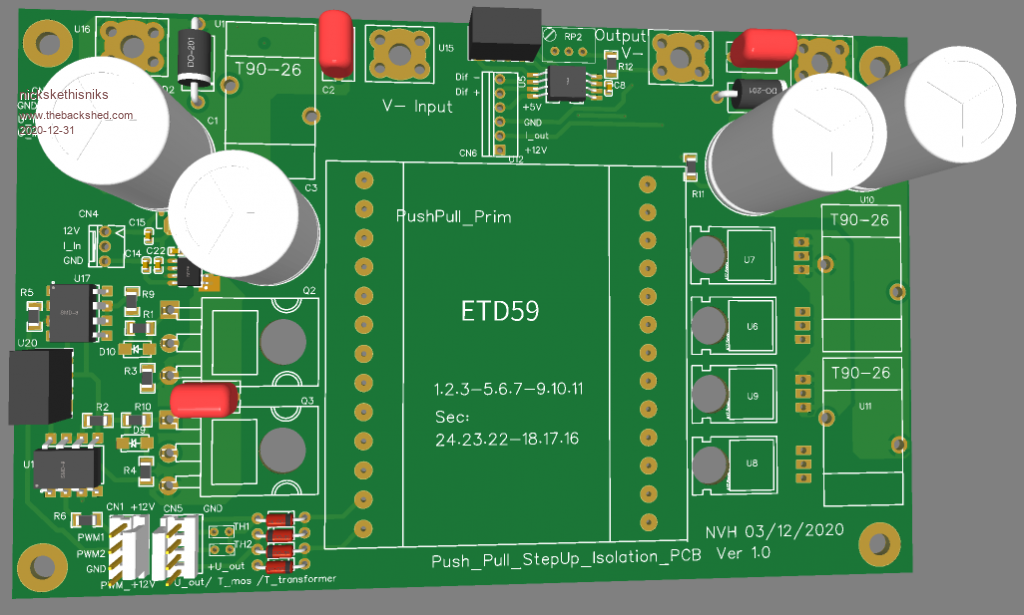

This takes me to board 2 where the galvanic isolation takes place. This board has a push pull circuit for driving the transformer, I intended to use 50khz, but it’s switching around 23khz now, that way I have better switching transitions. Then there is a bridge rectifier, there are some inductors between the rectifier and output capacitors. There is a place to add an inductor in the pushpull stage to experiment with.  Next version could be with an H-bridge to maximize the transformer core. This board has also in and/output current and voltage measurements, temperature thermistors could also be populated.  Since I want it 100% isolated, the output voltage can be measured with an isolated opamp or measured through a sensing winding on the transformer.
Most critical power parts I used are, IRFP4468/IRFP4110 mosfets, FOD3182 drivers, ETD59 core, T200-26B, 30CPQ100 and 16CTQ100 diodes, acs712 .

I recently noticed on your PCB, there are thermal reliefs that are showing on the high current Mosfets and diodes.
In my experience they can create hot spots and for extreme currents become open circuit. It becomes much worse when an adjacent part or track causes the reduction loss of some thermal reliefs. In worst case there might be only one or two small PCB connections left instead of the 4 radial connections to carry all the current. For all high current connection (including capacitors) I recommend always using direct connection to ground planes with no thermal reliefs at all.
Edited 2022-01-30 10:06 by wiseguy
Cheers Mike
Murphy's friend
Joined: 04/10/2019
Posts: 678
Posted: 07:37am 30 Jan 2022
Yes, good point but doing without thermal reliefs on large ground planes requires a rather big soldering iron to do a quick & decent solder joint with large capacitors, to avoid cooking them.
For that application I use octogonal pads instead, this gives me 8 thermal reliefs and I never had a problem with local hot spots doing damage.
