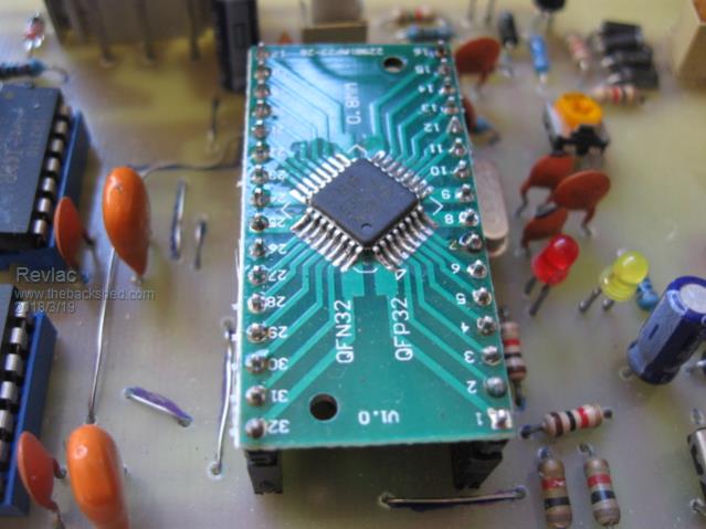

Moved on from the previous egs002 Inverter build, nothing wrong with them but after replacing the SMD driver chips a few times, it soon made sense to me to go and do the Ozinverter, the plug in chips is just a little bit more practical in the early stages of testing, and in the case of repairs.
OK
Some progress so far.
Soldered the 8010 chip on to the SMD carrier, To me it looks quite good. I used this solder flux pen (kester flux pen #951) thought it was worth a try as it was cheaper than some others at the time, works good and plenty left for other jobs, more-so if the bloody lid was tight before it was posted.

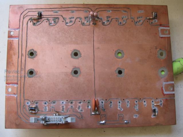

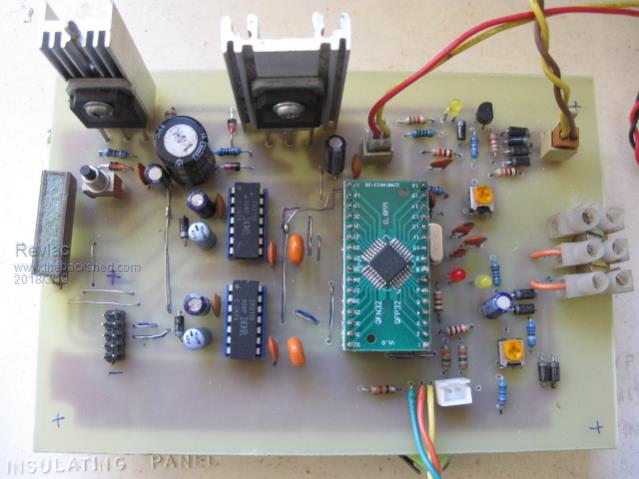

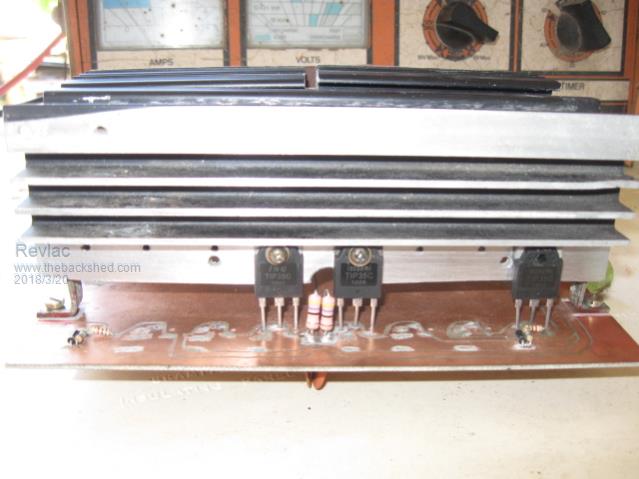

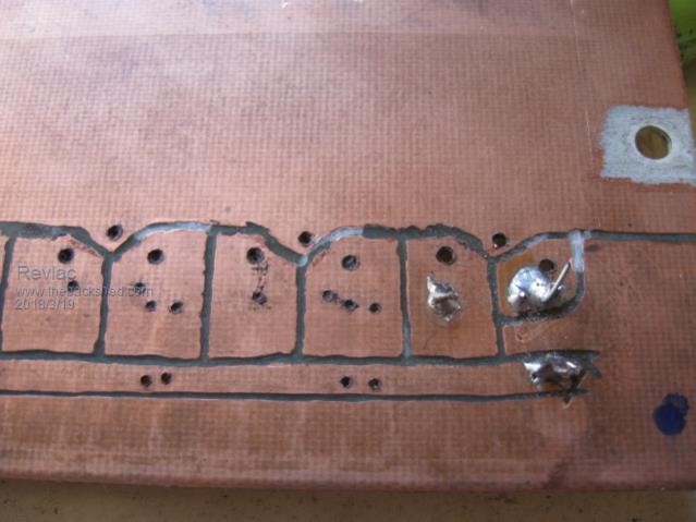

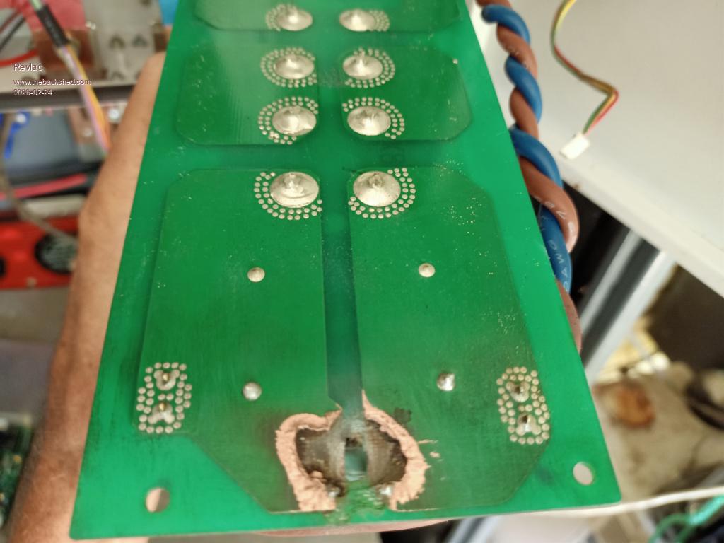

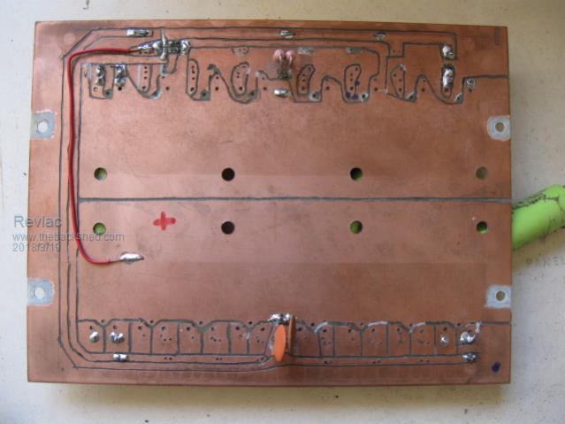

I printed and acid etched The control board, not proud of it either, the copper is thin and pitted to buggery, my fault should have bought some better quality copper clad pcb, anyway I fixed up all the copper tracks and so far its tested and working.

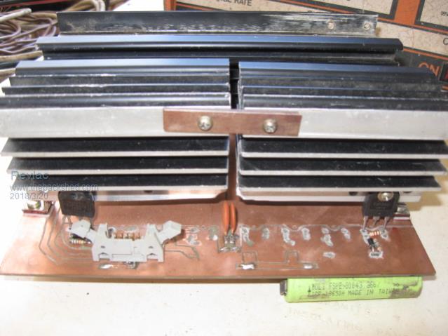

Started on the power board and its still thin copper so after my previous stuff up (crappy laser printer I have) the next idea was to try and just cut around the tracks, looked like an easy way to do it, Haha well it was a bugger to start with using a hand held dremel, It was a better approach to plug in the flexible drive and a small round diamond tip bit, use it like a drawing with a pencil.
It doesn't look very neat but I had to try and will see if it works. will probably end up getting the boards made properly in future.
I think I should also run extra copper (wire or strap) between the fet legs an the caps? And same on the top?
The red positive wire is just to try the thing, the power will be on the heat sinks later.
Just wonder if I should knock off the excess copper on the gate drive on the under side of the board or just leave it there?

Not the prettiest PCB but should still do the job, if you have some thin copper sheet you could cut that and lay it over the top where the high current is needed.
You can't beat the Chinese boards especially plate through which is near impossible to do at home.

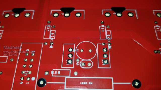

This a close up of my power board with 2oz copper made by PCBway.com

Mad, some areas on your PCB appear to be black, what is that?
I'm just curious.
Madness
Joined: 08/10/2011
Posts: 2498
Posted: 06:32am 20 Mar 2018
Just a dark reflection on the tinned pads.

another question, did you use the default clearance around the PCB pads? I increased this, it makes solder blob shorts less likely

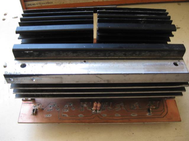

This is with the heat sinks almost fitted up.
Now I look at It they may be a little small.

No Klaus, I find I don't need to increase clearance, especially with a solder mask.
